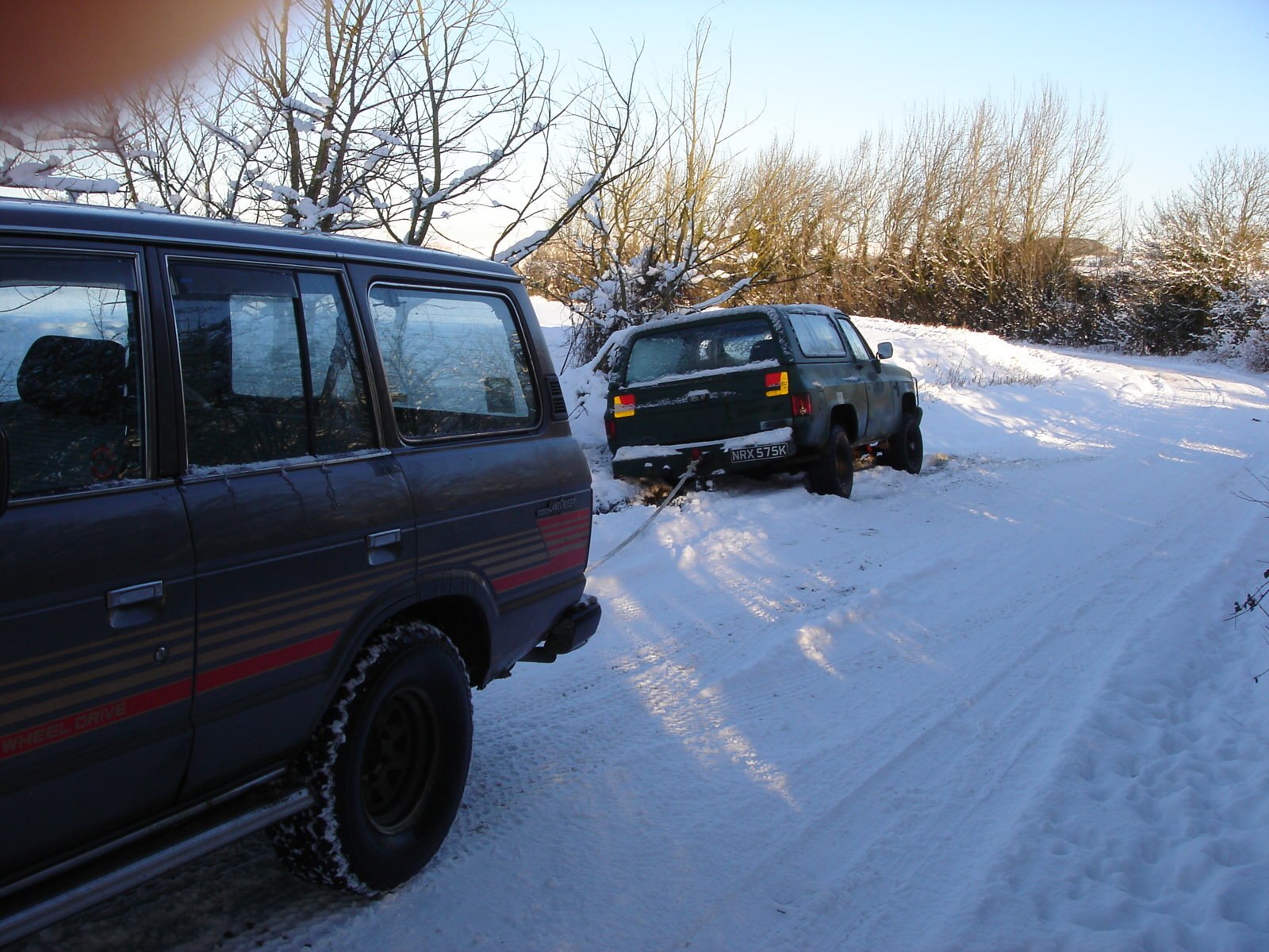

I can't remember the story explaining its absence now but i'm pretty sure it involved rust...
Is that a K5 being pulled?
Yep, my mates K5 6.2 Diesel. I thought it was your truck I was using but its not. That particular one was the last one (60 series) registered in the UK with 90K on the clock.
