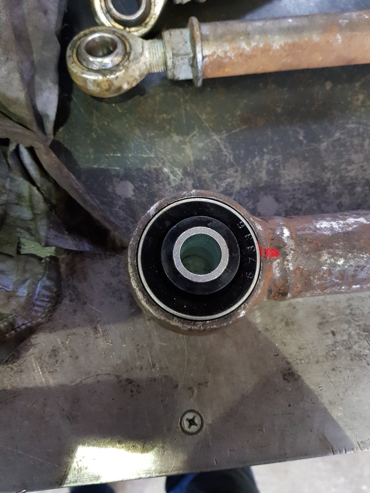

Ahh, I only managed to find some upper control arm bushes that looked like OEM and they've been great. The ones I got with my EFS suspension have been excellent too but are the synthetic one piece press fit ones. Thgese needed warming in water to soften them and then a healthy slather of white grease before pressing in. Anything that's two pieces pushed in from opposite ends with sleeve in the middle are to be avoided at all costs.

The OEM are a steel sleeve, rubber then an outer steel sleeve. There's nothing as good.

Whilst I agree that OEM is best for this particular part - ones in the OEM style are probably as near as dammit. Bonded steel core and outer banded sleeve. Anything as long as they're not orange and spilt into two halves! The OEM have a gap through them which I believe is part of their ability to flex without tearing or stretching.
