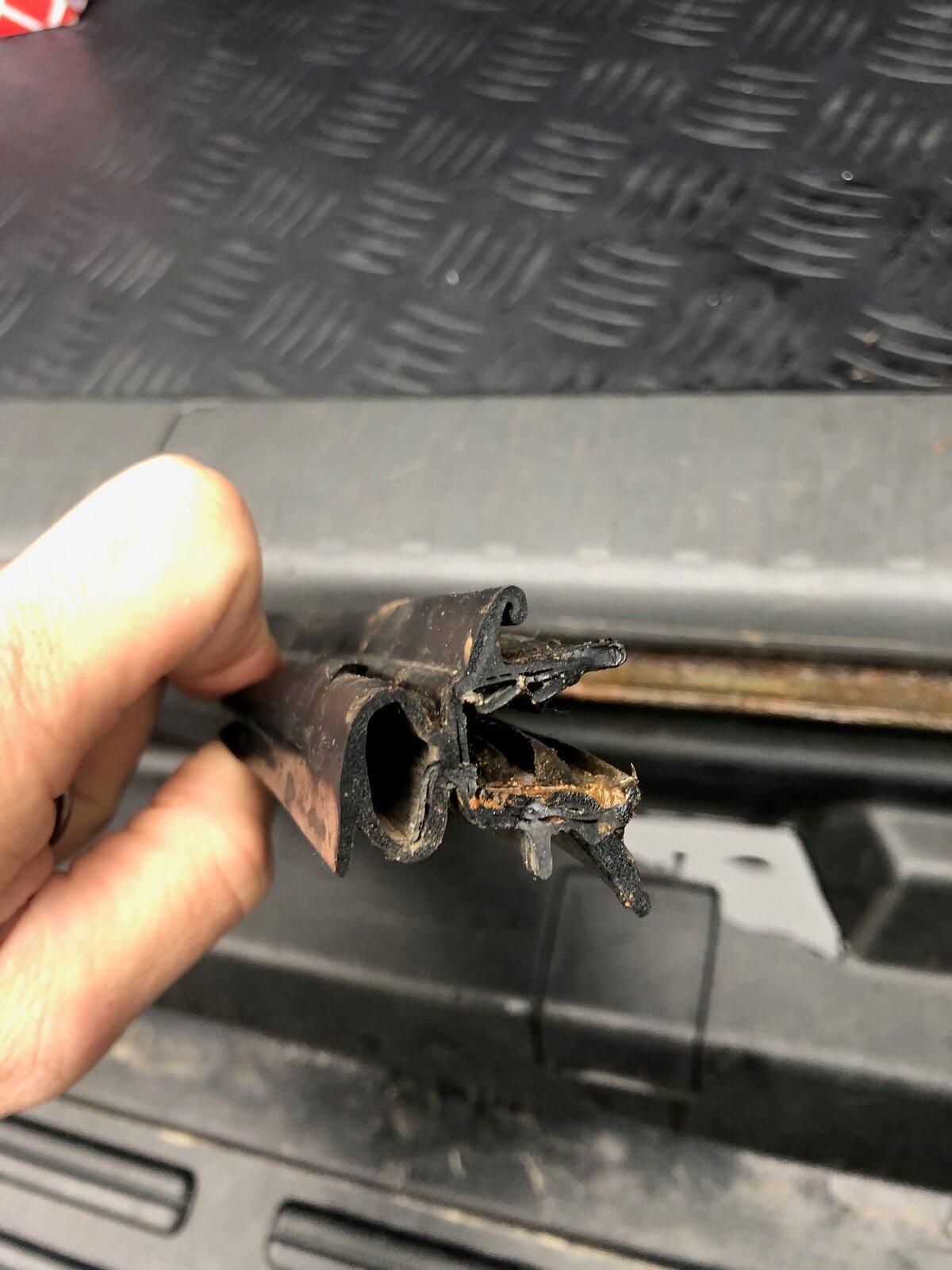

Hi,
Looks like the rear door (the one at the very back) weather seal has gone, opened it up this morning to find water in the back. Just got a quote from Toyota for it, £240 parts only!!
Did a google search, spoke to a couple of weatherseal manufacturers, but the only other one i could find was on eBay for approx. £190:
Genuine Toyota Prado 120 Series KZJ KDJ GRJ Back Door Tailgate Barn Weatherstrip | eBay - [Leaving Land Cruiser Club]
If anyone else has had to replace this before, were you able to source a seal that's a little more reasonable for cost? Or any other ideas I can try?
Thanks!
Mine was leaking under the seal (rather than between the seal and the door). I botched this quite successfully with black silicone for a couple of years then got one from Amayama (or Partsouq, can't remember) when I was getting some other bits.
Although it's looking like £120 + the risk of VAT and import duty from them these days. I wouldn't worry about parts only, it's a 3 minute job to press on.

Check out Sealsdirect, they have loads and loads of rubber seal profiles/sizes off the shelf, sold by the metre. If you can match one up with yours, it will be much cheaper.
Remember, Toyota don't make the seals, they will get them in from a supplier, so you're not held to ransom in that respect.

Hi Rob, thanks for the link mate, much appreciated. I've pulled the trigger and ordered that.
I haven't stopped looking for cheaper options, hopefully it can help someone else. I spoke with a few rubber extrusion manufacturers yesterday, a lot of them had close matches, but were missing some of the extra profile details which i think would make a difference.
The closest match I've found at the moment is from Seals direct (thanks Tractionman), its a VW V5 Van Rear door seal (Ordercode ETS 4122). I think it would work if anyone is game to try, and at £9.35 a metre its a lot more palatable. I've put a link below:

And here's a photo of the Toyota profile:
