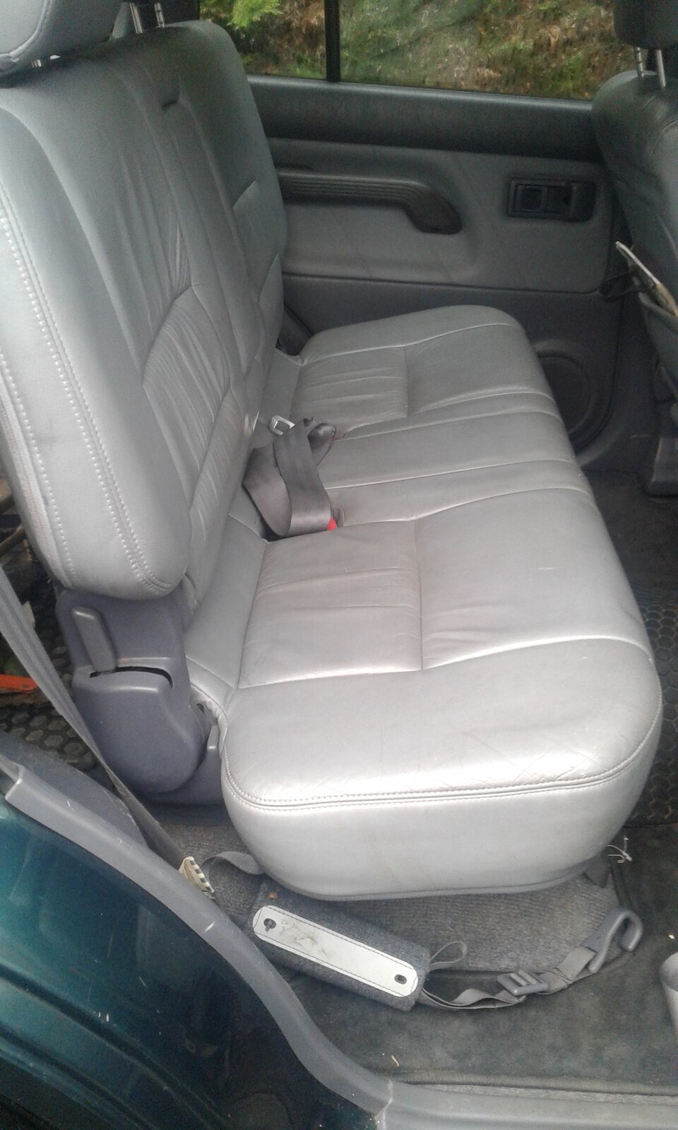

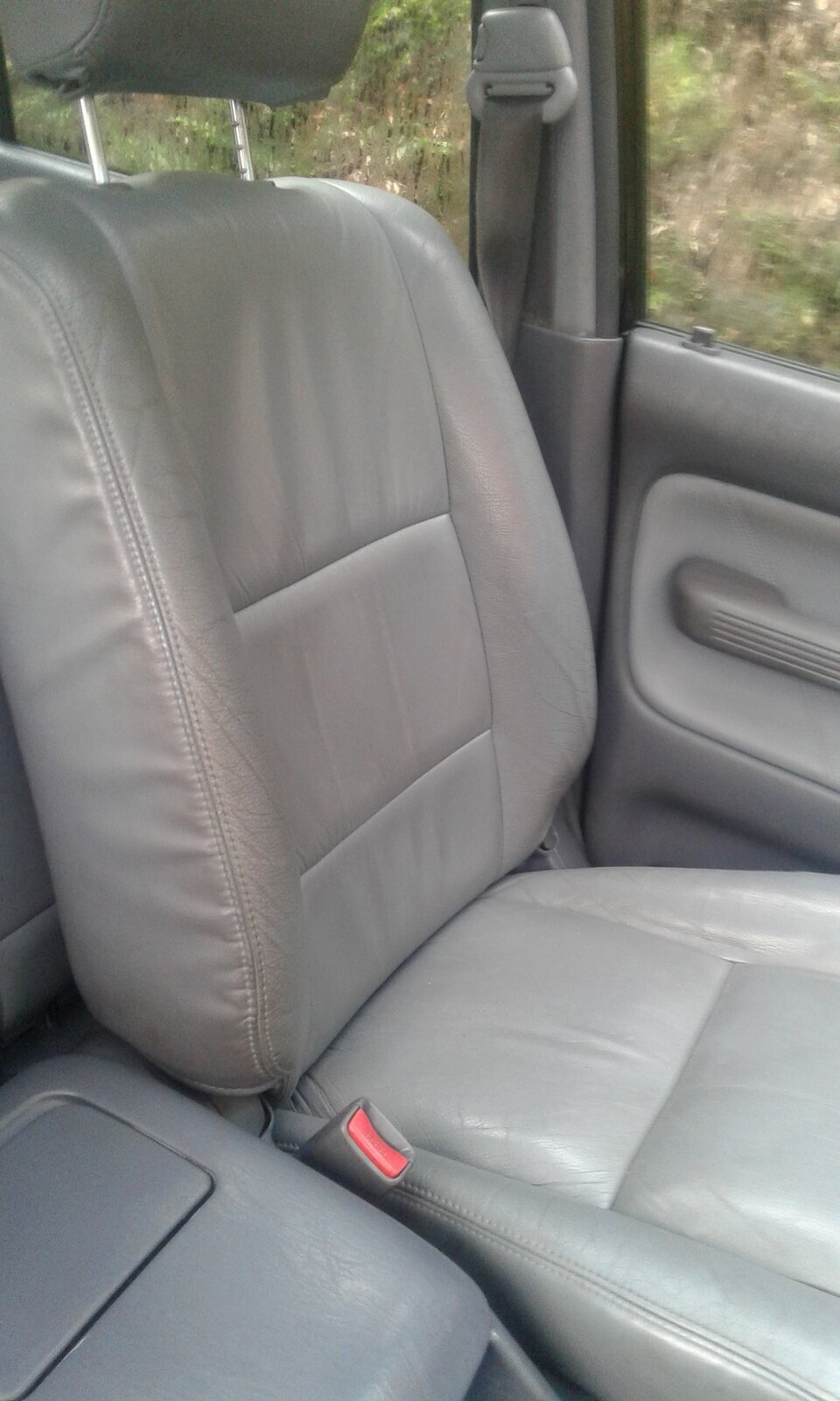

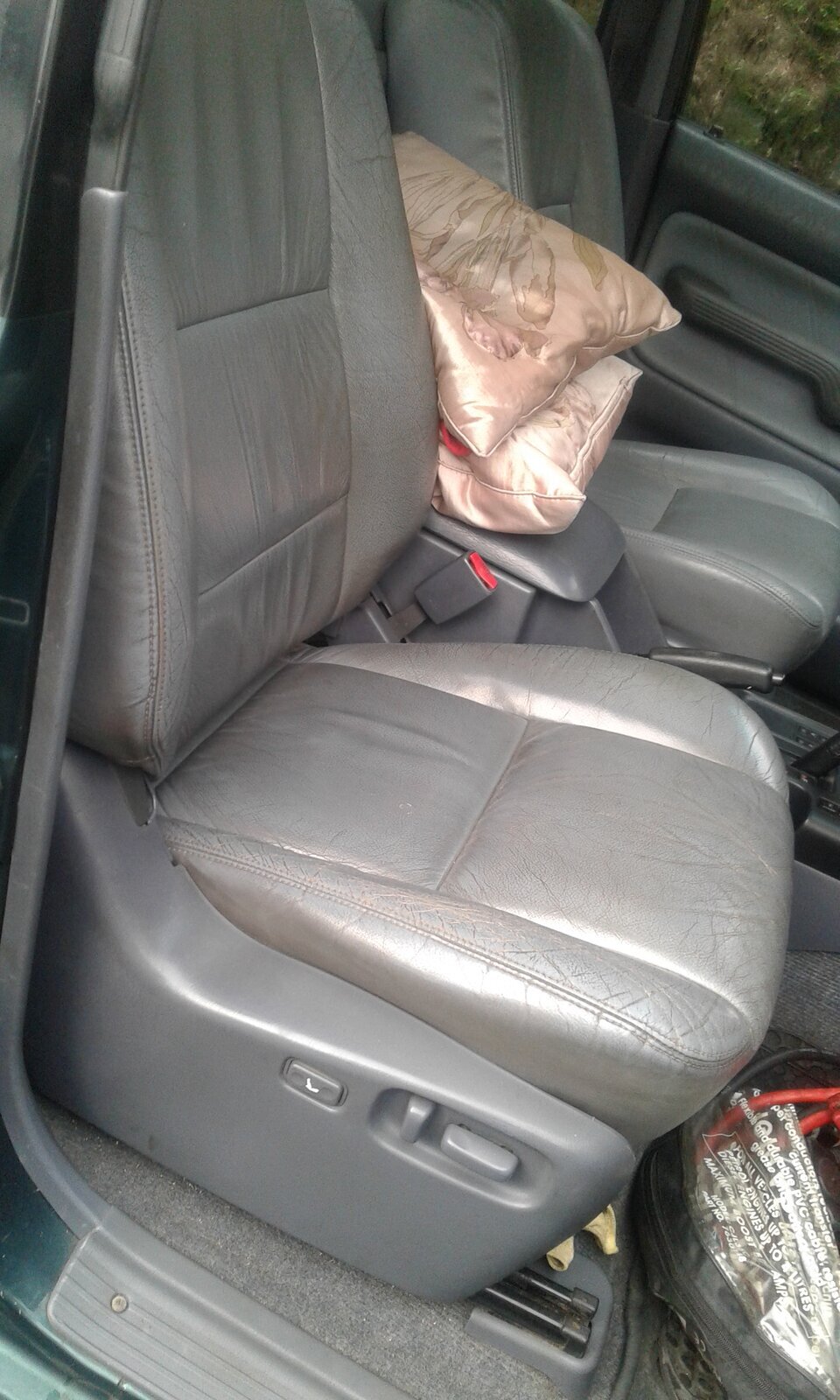

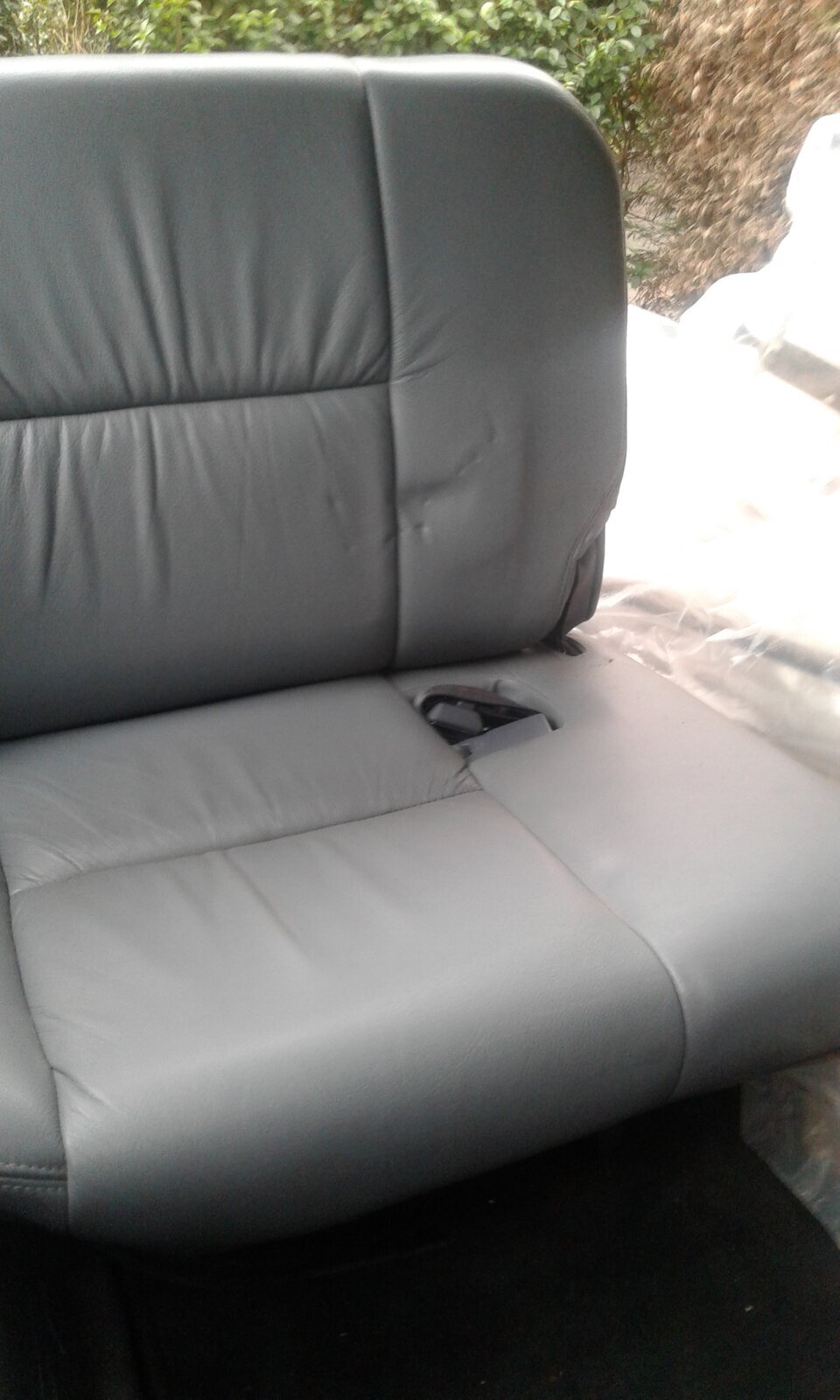

Hi wot about a full set of seats out of a LBW 90
