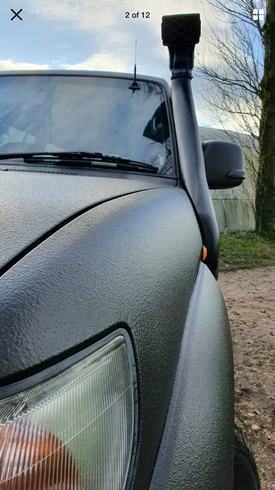

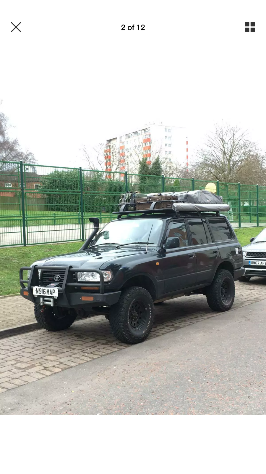

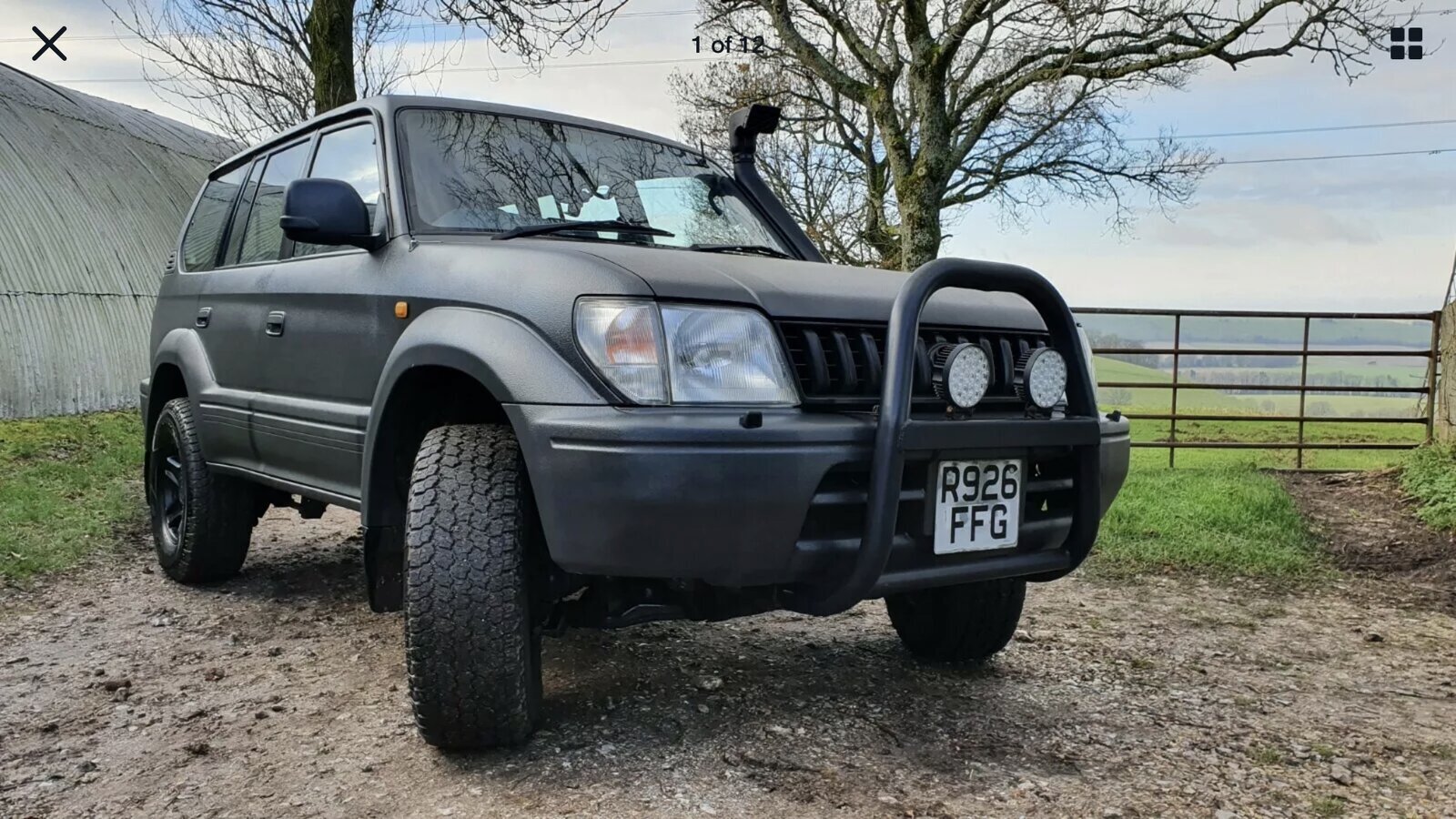

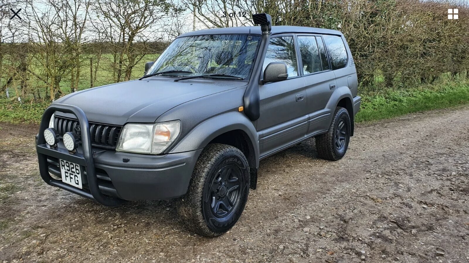

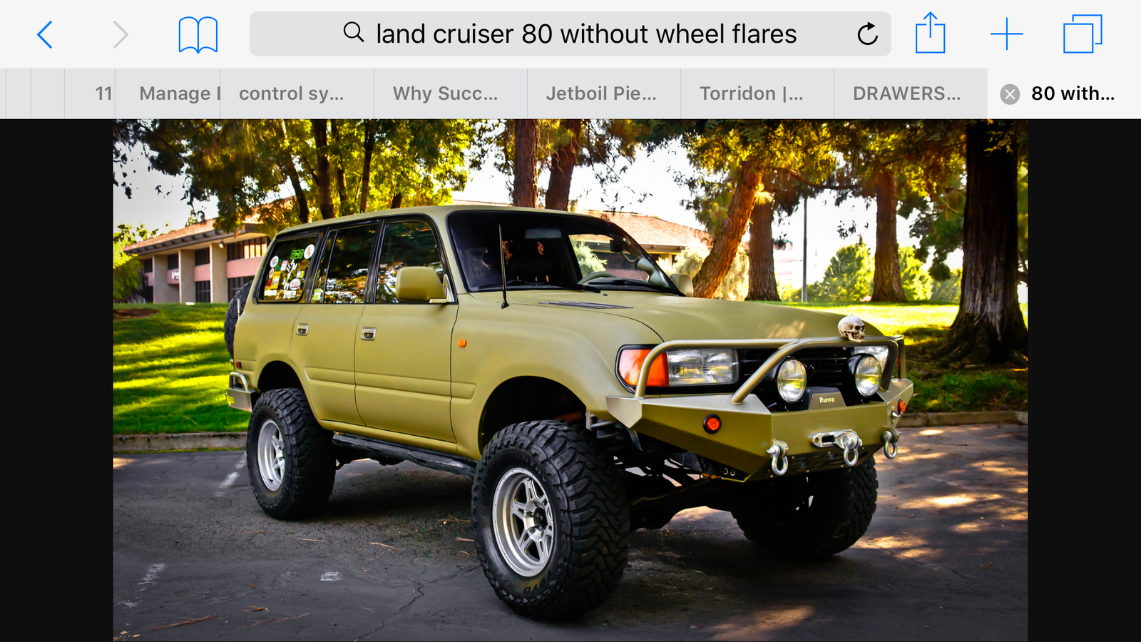

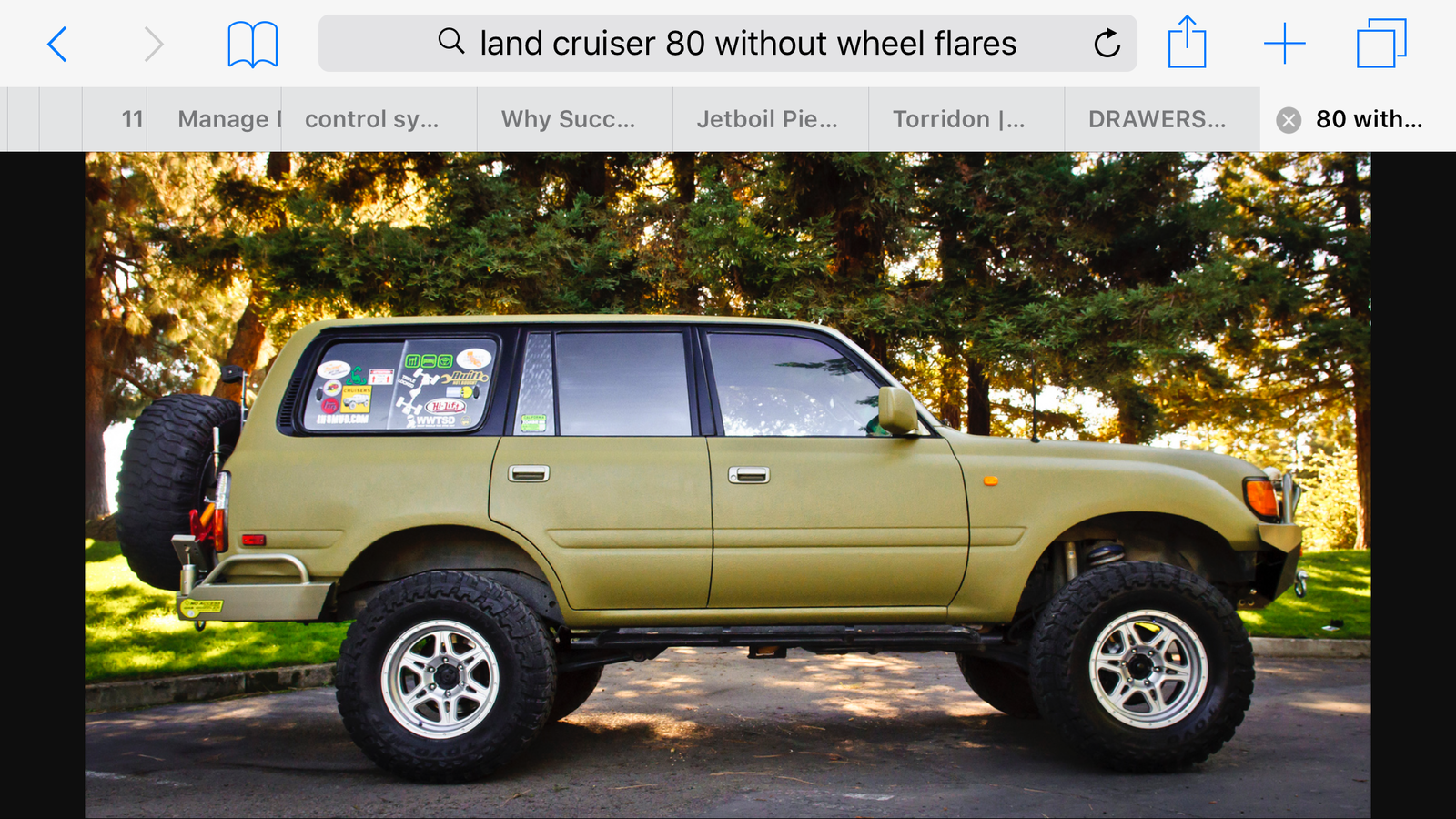

This is closest to what I’m going for.
Kut snake flares are only ‘cos I’m led to believe that if I take the fenders off it’ll fail an MOT. But looks like some folks are getting away with it if tyre size is appropriate (285’s ??). I can’t seem to find a definitive answer here.
My main worry about doing myself is:
A) how bad the steel is underneath the windscreen seal
B) doing the prep work on the current paint before applying raptor etc.
I did my Beetle back in the late 90’s so I’m sure I can do it again - but there I had my Dads factory floor as space!
In my head I’m picturing the light green truck without the huge wheels & crawling bumpers - so basically a cross between the paint on the 90 & the (lack of) flares on the 80 attached! (Both seen on eBay trucks!)

Your 80 has factory flares and 285's won't cause any problems unless your replacing wheels with some huge offset .
If that paint from Teamac is polyurethane id expect it to be tougher than raptor .
Shayne
Guru
Feb 2, 2013
16,121
305's here on a 10 inch wide rim plus a 30 odd mm negative offset which is basically like adding wheel spacers .
Your wheel are 16x8 with a zero offset .
