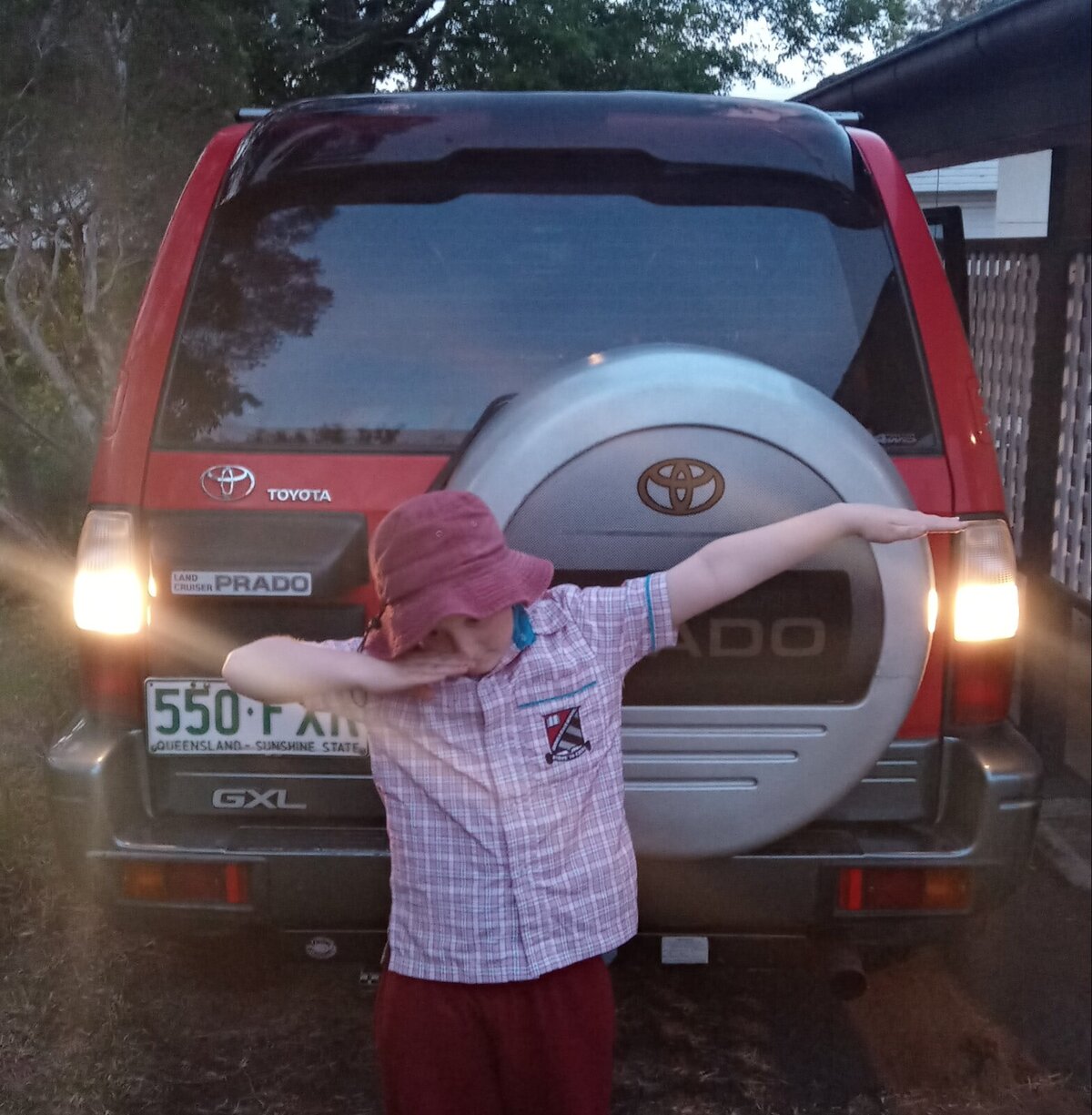

So the Australian domestic market mid end models might not have airbags or ABS, A/C may have been an option, but it's 2 reverse lights FTW!
Excuse the poser he wouldn't move out the way. Ignition was on with engine not running and handbrake on

I had removed my lamp and saw only wiring to the 1 lens, just 2 wires. Was just double checking before I send it in to the test, to be honest I never remember thinking the reverse lights were poor, I never have a need for using them, I suppose they might be of use if you're hooking on trailers at night time or something? What do you folk that find them to be crap actually ever use them for?
