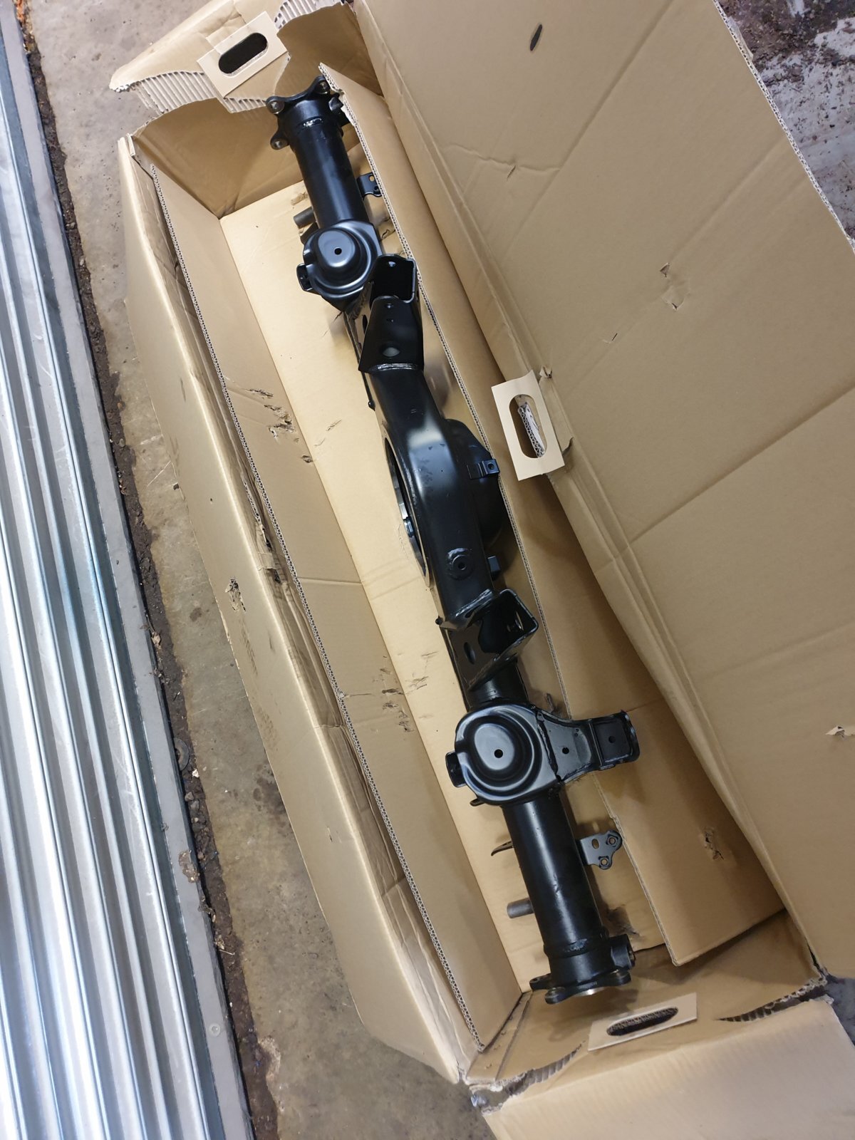

I have just had to replace my rear axle and fuel tank due to rot! I would thoroughly inspect everything first to make sure that it can be repaired..

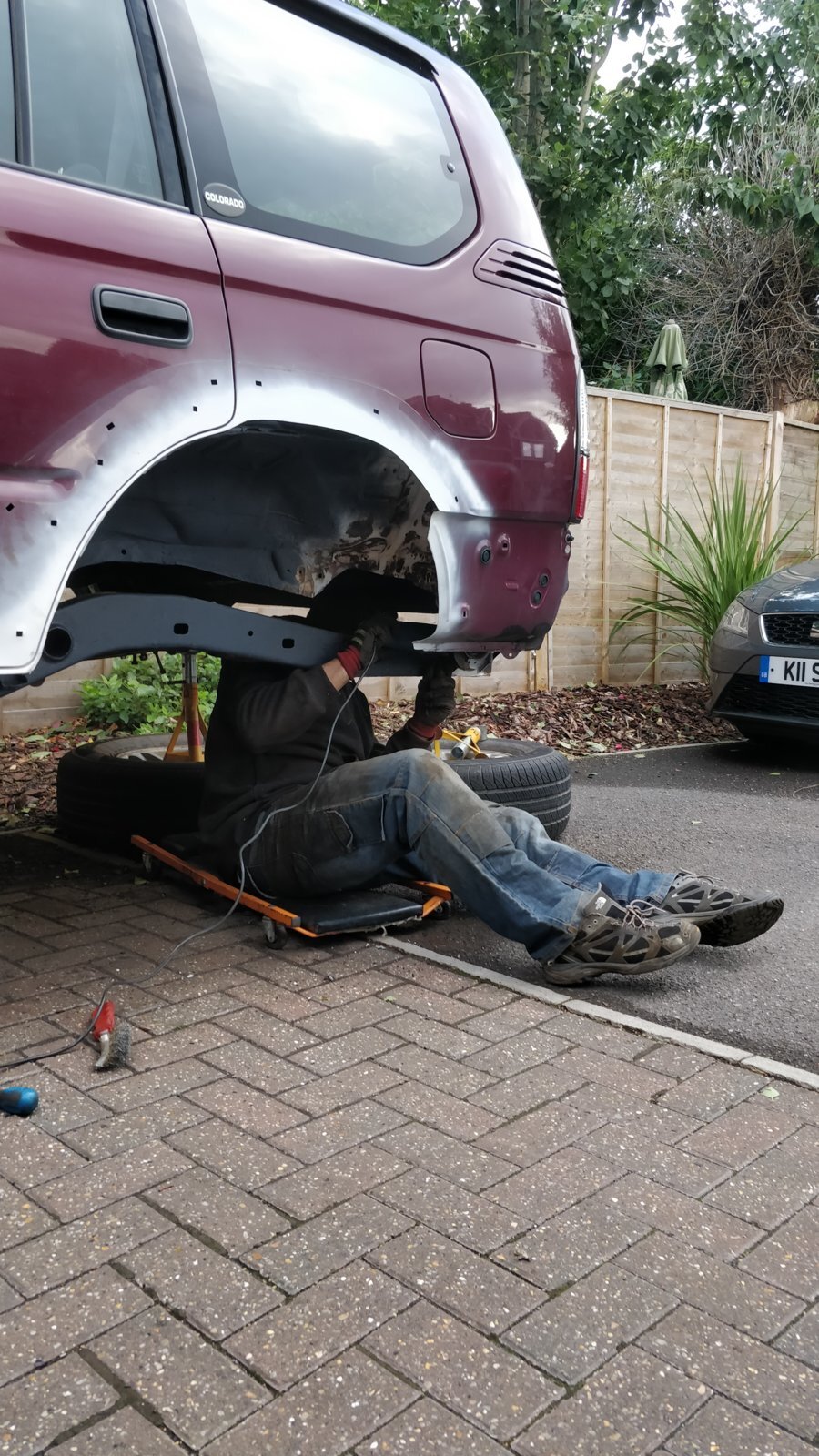

So far in my build...
  • Rear axle rotten on top arm mounts, spring seats and wafer thin on diff. Replaced whole axle.
  • Rear inner arches shot. Welding in new from plate.
  • Rear outer arches shot. Cut back and fabbing wide arches.
  • Rear chassis from panard rod cross member back shot. Cut out and fabbing new chassis and rear bumper.
  • Cross member boot floor shot at ends. Cut back and sealed.
  • Outter sills shot both sides. Cut out and replacing with box section and slider bars.
  • Number of small patches inner sills both sides.
  • Front outer arches shot. Cut back and fabbing wide arches.
  • Underside generally from transfer box back much surface rot. All gound back and painted with upol raptor.
  • Windscreen appature holed. Screen to be removed, welded up and new screen fitted.
I cannot emphasise enough that you should check everything before you start repairing. These are old trucks now and from prop backwards they suffer.

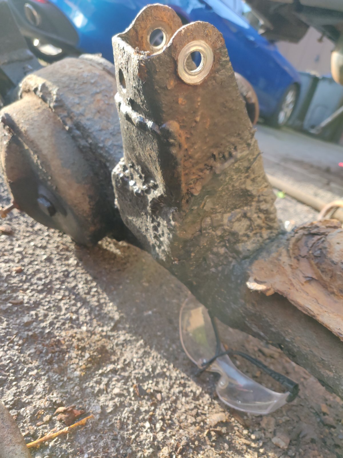

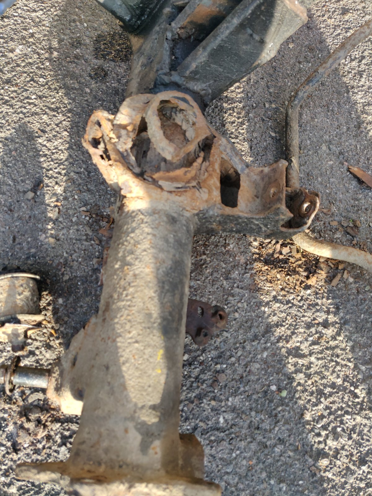

Depends how far it's gone @Jack VZJ90
If, like mine, the casing has rotten to wafer thin and the turrets have been badly repaired many times you may have no choice but to replace. Being half way through a full resto on a 90 I cannot emphasise enough to really get the underside fully stripped down, at least ground back to good metal (shot blasting better), all the rot repaired, painted with UPOL Raptor then AC50 annually over the top (that's my plan but I come from motorbikes so AC50 is a given!)

Nah you still had spring seats and my turret had been repaired at least 4 times to that extent... Maybe we should start a 'show as yoir axle' thread!
What's the rest of your underneath like dude?
Think mine was a scottish boat launcher the state it was in!

Theory is the turret drain holes are easily blocked and once that happens they never really dry out so they rust out instead .
