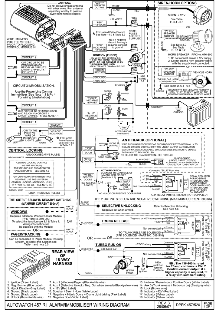

@essexpete Does this help?..... Remember having a Scorpion on my T4 years ago.

It will be a case of following the wires back from the control box then, it’s most likely it’s only 2 wires that will need te-joined and the rest can be just chopped out and insulated. Removing the dash panels will likely take the longest!

Which particular model alarm is it? Ultimately you're going to have to trace from the immobiliser to the joints into the ignition system.
