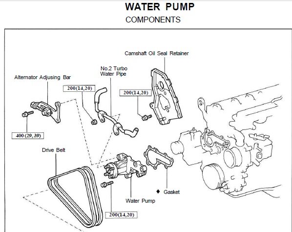

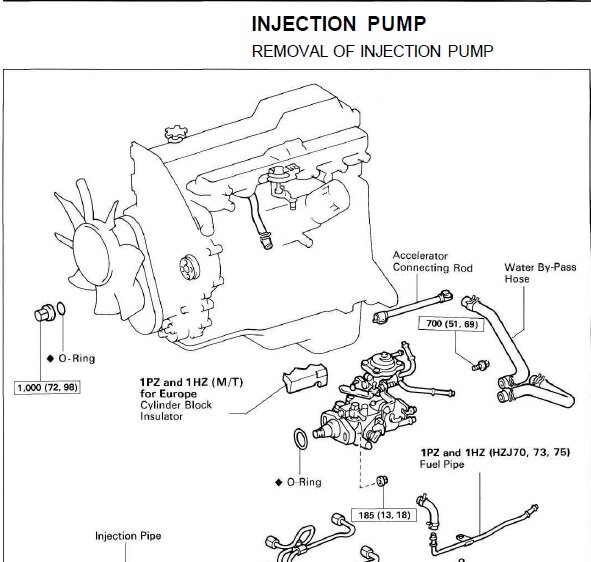

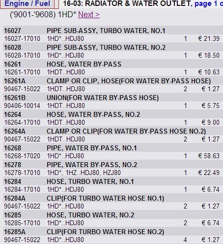

Guys - (& Girls)
On the last trip over to North Africa - another LC80 had a small split in a pipe that goes from block to fuel pump, which I believe provides heat to the pump ?? (is this correct) - although the leak was spotted it was assumed to be a drip from the AC pipe (same side) - it was eventually solved at a 'service stop' somewhere in a two horse town in Morocco - the garage was actually top notch with a very good rep for resolving issues on Expo Trucks.....
As I'm off again to Morocco and the West Sahara in about 4 weeks - Morocco will be fine with the usual garages and service capability however Western Sahara is a different matter and not much is down there when it comes to the ability to get things fixed. So I though I should at least carry this little pipe as a spare (along with all the rest) - however having problems with Toyota as they cannot seem to find this pipe on their system.
It's a 1HD-FT engine...
Can anyone find the part number for me... just so I can be sure I have the correct pipe - if I have time I will swap it over with the one on the truck and carry the old as the spare...
Many thanks.
