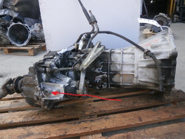

Yes I read your topic as well,but I was thinking "reverse light switch" is for white light on tail lamp.If you read my topic I have had same issue,
I changed the switch and light now is full working!
If you would check before buy the new switch, disconnect the switch e close the contact, if light is ok, you will see it on the dash!
Ok its on the transfer case,today I will checkOEM 4wd switch was impossible to find out!
I found this, the only one problem was the wiring a little bit short, but something really easy to solve!
The switch is here, on the right side of tranfert
