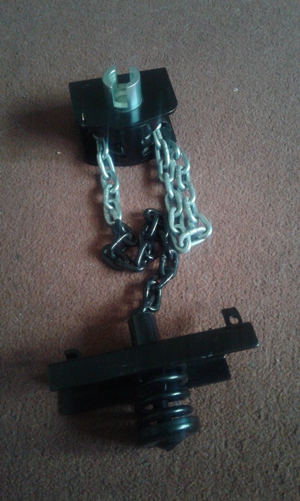

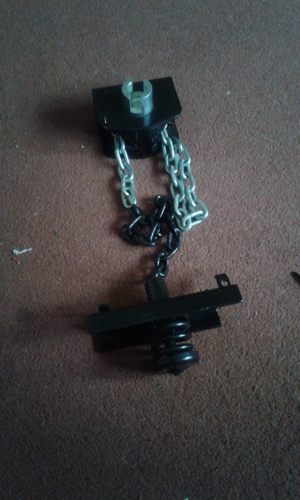

Hi I have a new one but I can not see parts number on it if it is a help its £50
