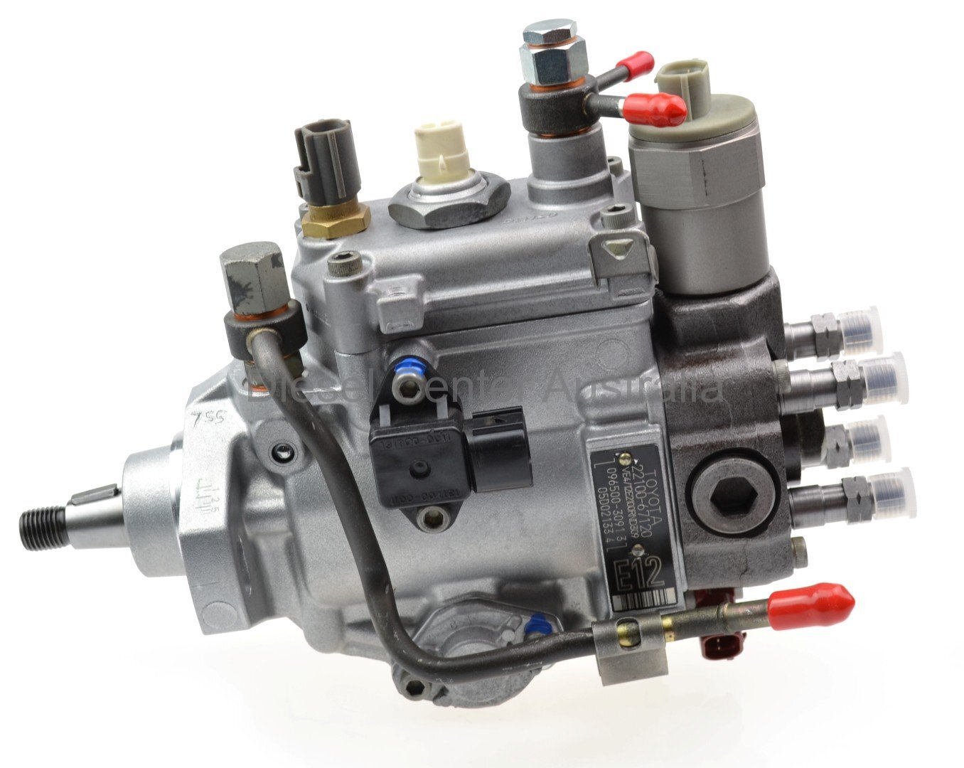

Toyota seem to say they do not sell the SCV (commonly called suction control valve ) separately , toyota want you to buy the the whole injection pump that includes the SCV at just over £2K , part number could be 04226-30010, but you can buy the SCV from Rough Trax 4x4 .com for about £182 for the late Lc120 1kd-ftv engine which is the shorter updated version and toyota genuine part made by Denso , or try ebay, hope that helps .Hello everyone I have a 2009 Prado and my spill control valve needs replacing but i can`t seem to find a part number for it. Below is a pic of the pump. Can anyone tell me what the part number is?View attachment 164037
Thanks but that is not the correct part for my cruiser.Toyota seem to say they do not sell the SCV (commonly called suction control valve ) separately , toyota want you to buy the the whole injection pump that includes the SCV at just over £2K , part number could be 04226-30010, but you can buy the SCV from Rough Trax 4x4 .com for about £182 for the late Lc120 1kd-ftv engine which is the shorter updated version and toyota genuine part made by Denso , or try ebay, hope that helps .
Yes my model is kzj120. I`ll look into the 90 series pump...thanks for all the info much appreciated.Do you have a kzj120? If you have then you could buy a 1kzte pump which is fitted to the 90 series and there are many available in Europe.
Here we have the kdj120 I believe, but have heard of the kzj120 in certain markets and I like the way that toyota kept the 1kzte for a bit longer. They're a cracking engine and I personally really like them!
You could buy a second hand pump and use the SCV off it and fit to yours possibly a way around the problem.
All the best with it!
I did not know 2009 120s had 1kz engines from the 1990s 90 series , could be coz some nations still use low grade diesel , the the 1kd can not use lowgrade diesel and have a long injector/injection pump life , or maybe by using the 1kz engine and less equipment and lower grade fittings it brings the price of the 120 down quite a bit like the Lc12o models the UN use , but you can still buy rebuilt injection pumps at a reasonable price and get one shipped over to your Island if you can not buy scv separate , or look on ebay for a aftermarket made scv, I have seen a reconditioned injection pump for the 1kz-te for £525 plus £120 postage , sorry I could not be of help .Yes my model is kzj120. I`ll look into the 90 series pump...thanks for all the info much appreciated.
