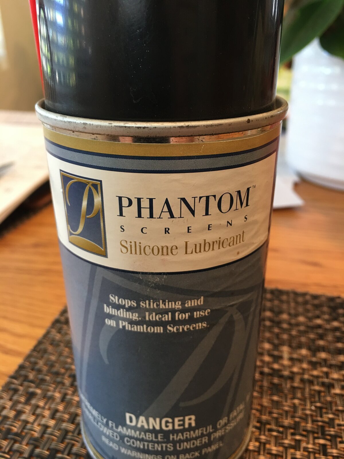

I was able to pull out the sun visor rod ( about six inches), then located some old silicone spray. Soaked it on a rag and then rubbed the exposed sun visor rod and then let it sit. It seems to have helped without having to remove the entire visor. Also, no stains on the material was a bonus. Thanks for everyone’s input.
