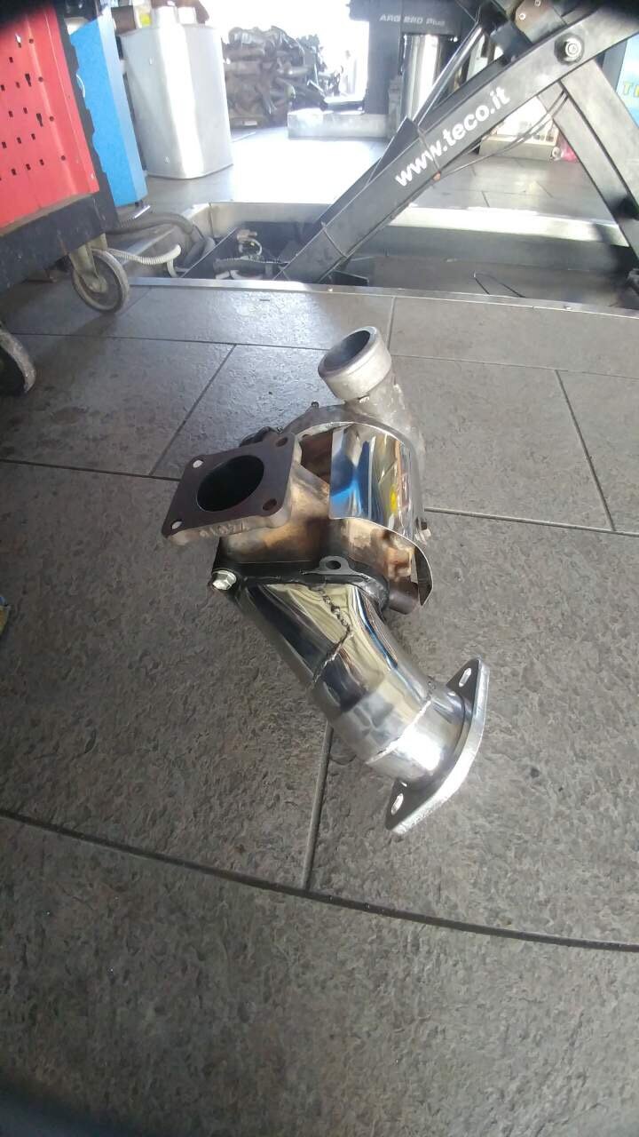

    Hi folks - fancy getting a stainless exhaust for the old gal - can anyone enlighten me what size I should go for, if it was header down? 2.5" or 3"

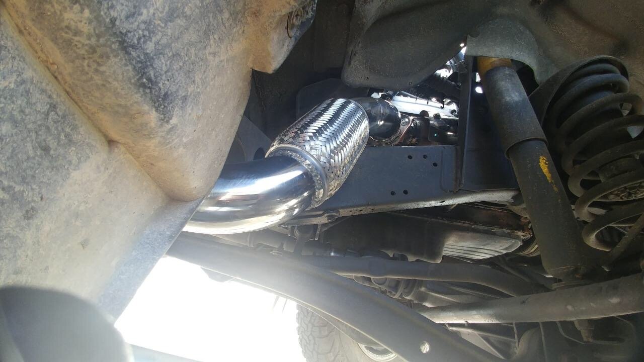

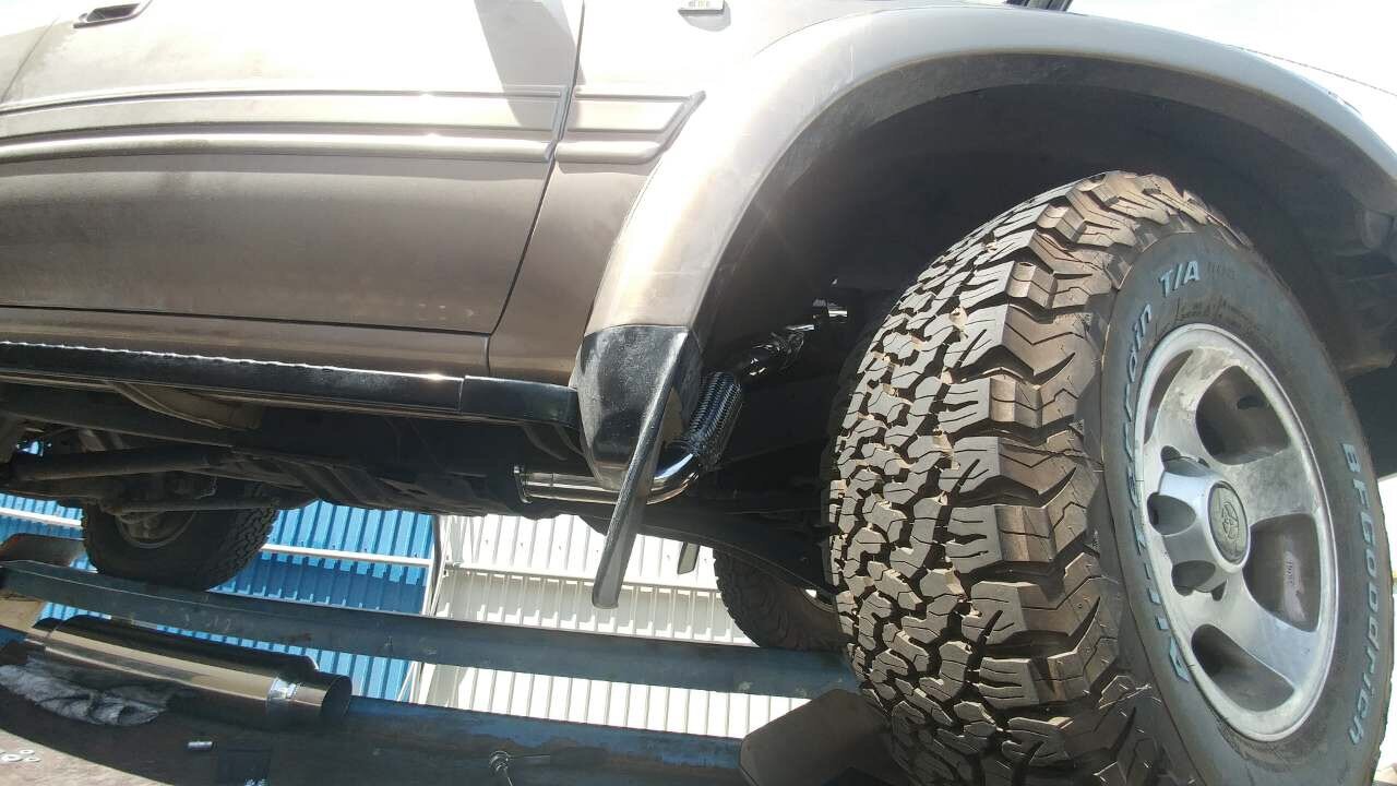

    I went for a custom fabricated 3 inch to the side mounted with also a 3.5 inch or so fabricated piece from the turbo back Steve. Happy with the quality and workmanship just saved a few pennies not having it going over to the rear.
