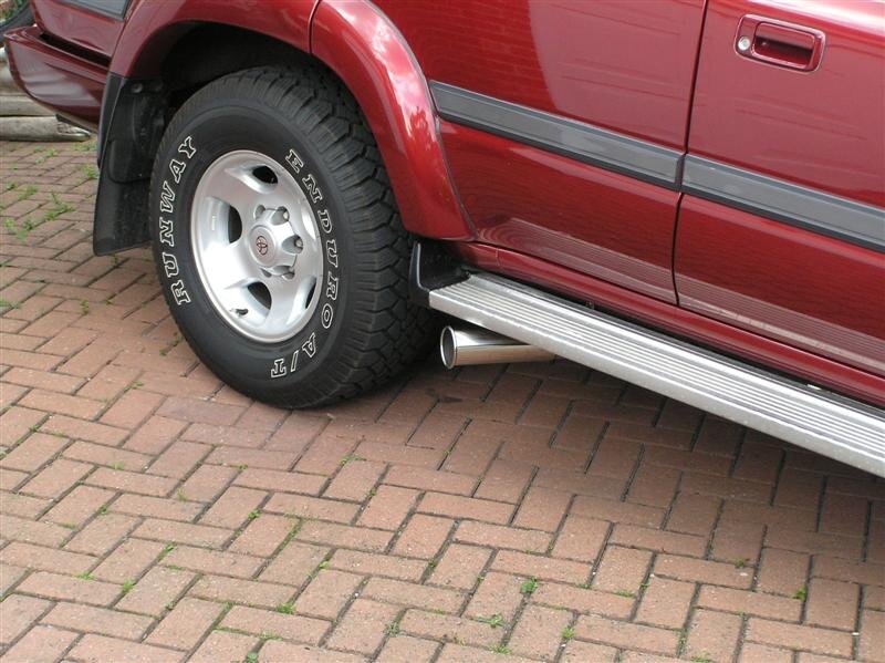

Chas do you have any pictures of how yours is routed?
Would like to know how they get up the middle of the chassis and come out the side.
Does it go under the chassis rail?
I have looked and decided that would be a problem for me just in case I land on it. So would be very interested to see how they over came that.

No I don't have any pictures of it but it runs between the chassis rails and over the rear axle then comes out just behind the rear wheel through a hole cut in the bottom edge of my rear bumper, it's not been squashed yet. You can see where it exits in the picture from Strata
and the other picture shows the bumper before the SS exhaust was fitted.
Sorry Chas I miss understood and thought it was under the doors.
Will have to see where they got that over the rear axle

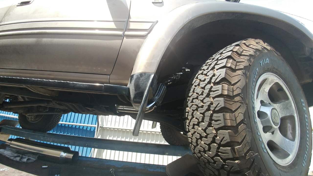

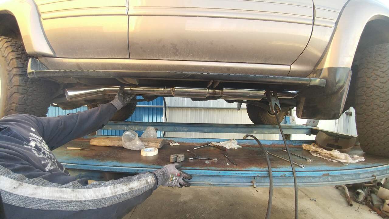

Mine exits under the OS rear door just forward of the rear wheel arch but it's too low and exposed for serious offroading.
This is a picture of mine whilst it was being fabricated at the shop if this helps. Certainly not suitable for serious off road use which suits my needs.
