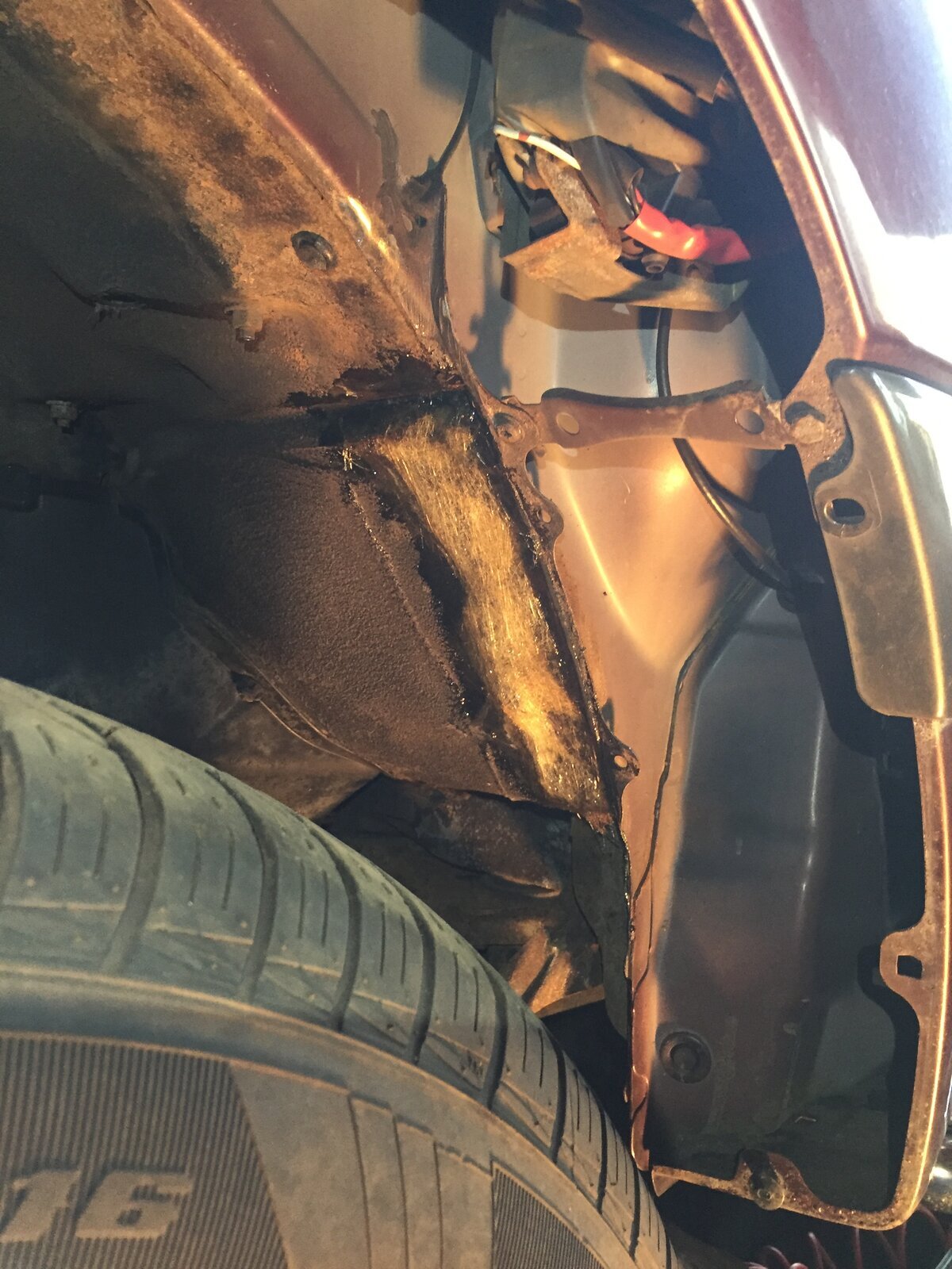

Thought I would show you some work I've had done to try to keep my old girl on the road, this is the first part of work on the rear arches and rear lower panels....

A little update on the work started before Xmas, the fronts of the rear arches are in the frame this time and work is ongoing this week at Davey Wren's workshop in Oban to cut out and repair the rot. A few pictures to follow:

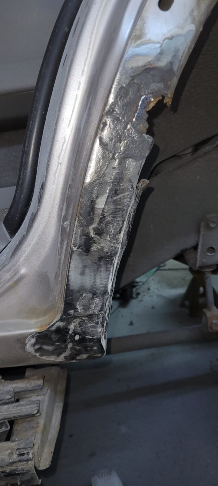

Next instalment, sorry it's picture heavy. Davey is starting to weld in the repair sections, starting with the near side inner and outer
arches......

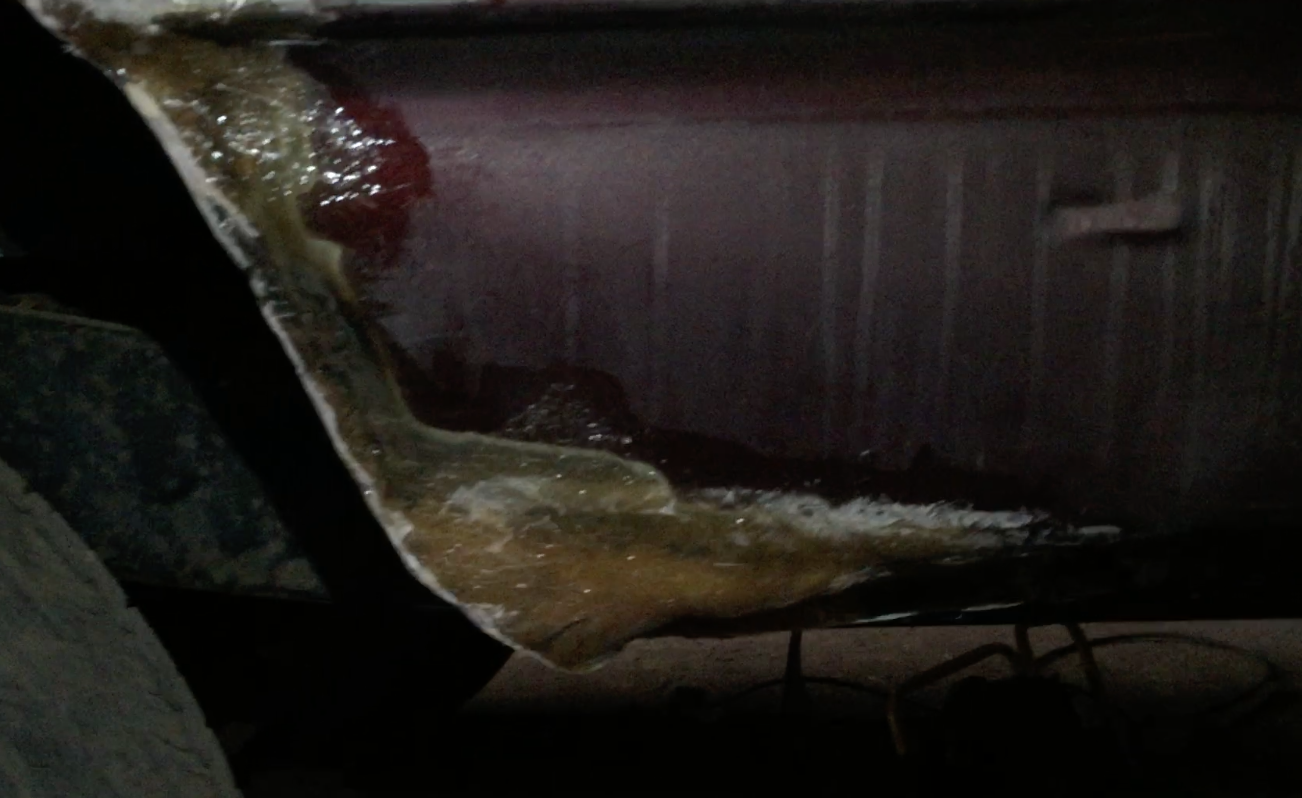

Nice work! Welding those arches, with almost no metal there to start with, is a nightmare! My Dad and I have recently addressed rust in the same areas on my 100. After some welding, and thinking we'd set the interior of the car alight at one point, we opted for fibreglass. Much easier than welding, and won't rust again.
I also needle-gunned the chassis, axles etc. and painted with Buzzweld Rust Encapsulator, and WAR. Also used Epoxy Armour in key areas. Can't say the paint job has been entirely satisfactory – I did the job in November / December, and despite being in a semi-heated workshop, I think there was too much moisture in the air. If I were ever to do that job again, I would wash, descale and weld/fibreglass myself, then send the vehicle off to Buzzweld to do the painting.
