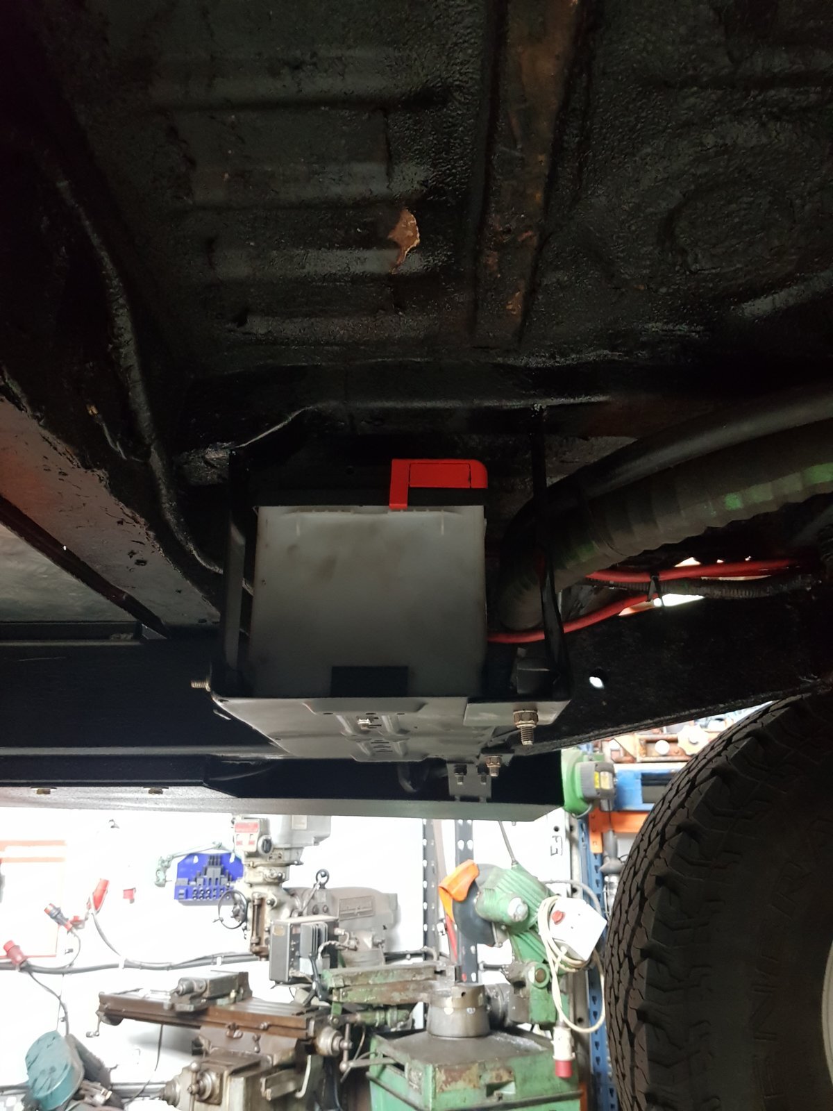

    Well Optima batteries can be mounted at any angle so they could go under the truck. But I let a battery box into the floor of Lil Blue which worked well. There's room under the passenger floor to do this too. Not perhaps the most convenient location there though. Also you can go 12v and use the location under the bonnet for a leisure battery. External water tanks are tricky as they just seem very hard to seal against dirt ingress. Frontrunner do a flat tank that goes behind the seats. I have one that you could play about with. It all depends on your build of course. I have a shower in my 80 and love it. It gets used, but is it essential? No. You have to consider just how much water you need. For a month's trip across the Sahara, then it's going to be quite a bit, but for places where there are shops, frankly if you had 5l in a plastic bottle I doubt you'd ever run out.

    I like the batterybox idea Chris. Not thought of that.

  6. Chris

  7. karl webster

    I can remember seeing that. I like it. Simple idea that works.

    My battery is mounted under the rear, a bracket from the chassis with a battery tray

    Get rid of the heater matrix and there's even more. Certainly enough to drop a battery box in actually.

    The chassis rails may be in the way of putting a battery box under the front seats but removing the rear heater must be one of the easiest ways to gain a little bit of extra storage space.
    There's probably space to drop a box through the floor under the drivers side back seat - over the exhaust main silencer - there's usually dead space especially if you've done away with the silencer but check for where the chassis rail runs first ;)
