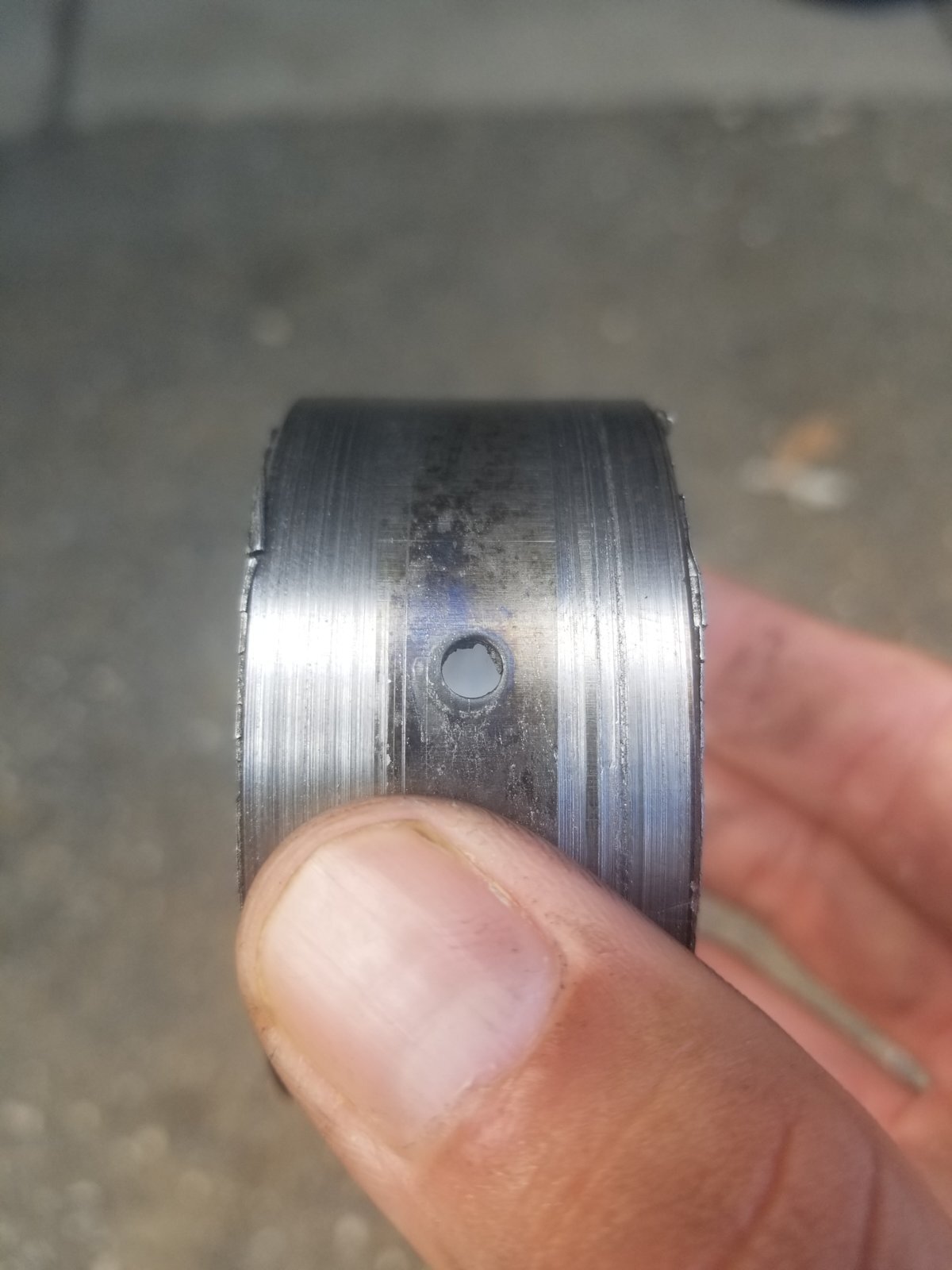

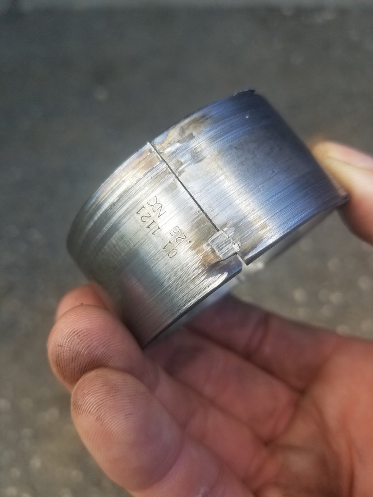

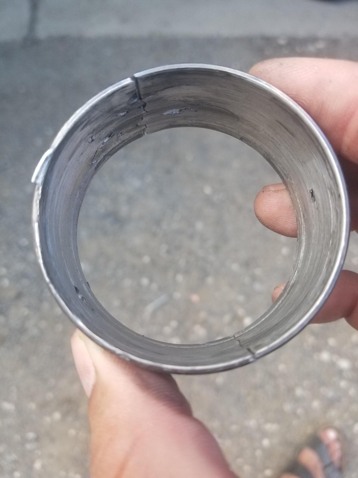

Hola,
I just moved to costa rica where cruisers are the plague, they are everywhere. That said, I bought one for my daily driver and it was a blast until it slipped a bearing on the number four cylinder. The mech has pointed out that someone has been in the engine previously (a B) as the bearings are .25 but its but understanding they are .20. So I have a line on a couple used motors, one from Japan and another that was pulled from a jeep here. I think the cost of the used motor out weighs the overhaul Anyone else gone through this head ache?
