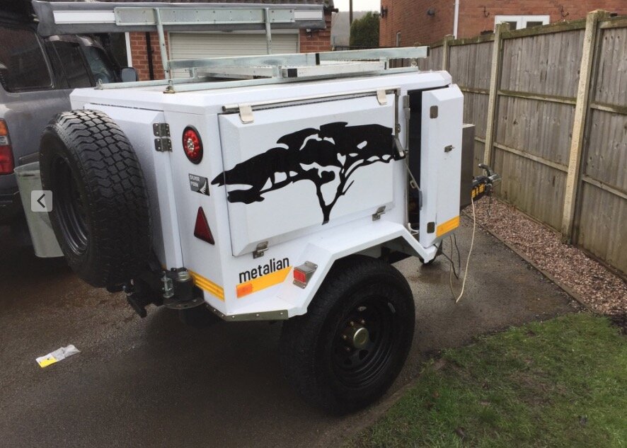

First job was to sort the towing electrics. Spent hours yesterday trying to redo the truck. This morning I decided to open the plug and intermediate connections on the trailer. Ahh, right so blue to blue, black to black etc. Nah, why do that when you can connect black to brown, blue to yellow etc. So all working nicely now.

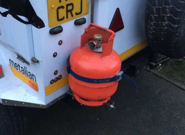

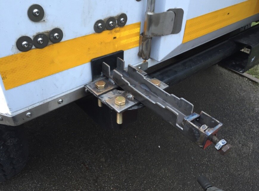

Next job was to make a new gas bottle holder. I used some channel and milled out the profile of the base of the bottle and made a little clamp thing that hooks under the rim nice and tight. Needs powder coating. Or a decent galv job on it. Then I put the new strap bracket on and Bob's your Aunty.

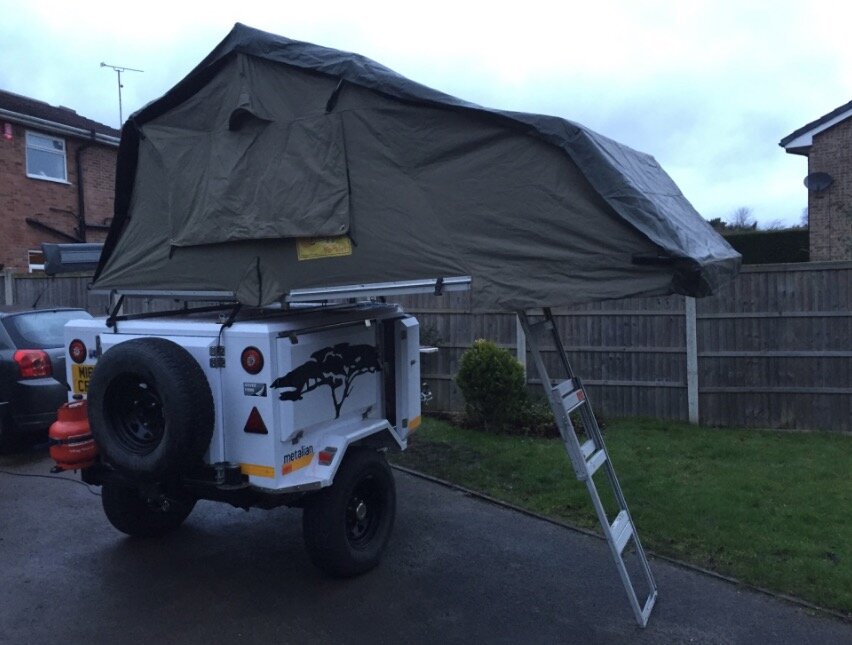

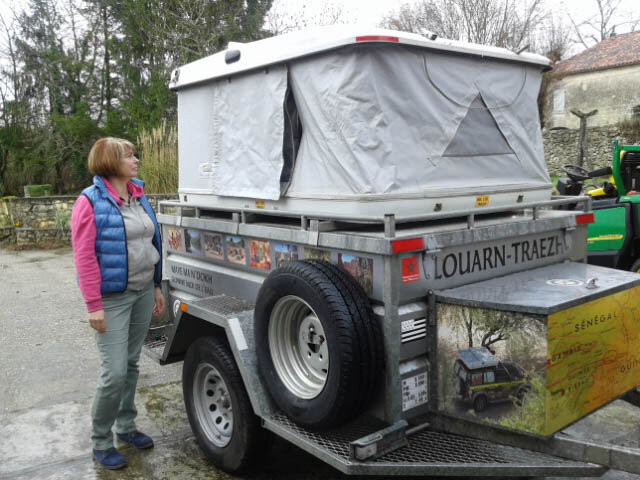

Then we hoofed the new roof tent up and got it fastened down for now so we could have a look inside. Very nice.
