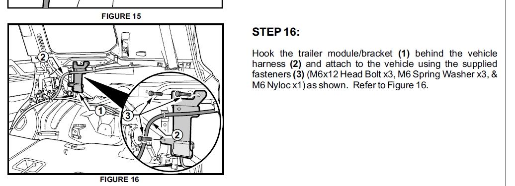

I was asked to have a look at a friends 2008 200 to check out the tow bar wiring as all that works is the indicators, it’s got a factory installed tow bar and wiring kit, what I found was that on the brake light circuit and tail light circuits is only 3.8v output, this is at the socket ( which is in perfect condition) and also at the multi plug by the rear light. All the wiring / connectors look in perfect condition. I tried running a separate earth to the socket but there was no change.
Is there a relay somewhere in the system which could be faulty or any other ideas?
