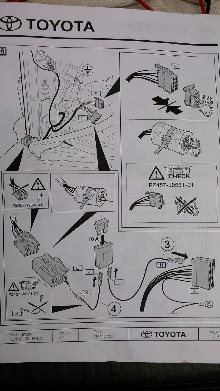

The only thing i was unsure about was in the manual there was a reference to what looked like an alternative configuration, i am assuming this related to a variant on the wiring?
I tried the various permutations but none seemed to help the problem relating to the indicators even though the picture is suggesting check hazards!

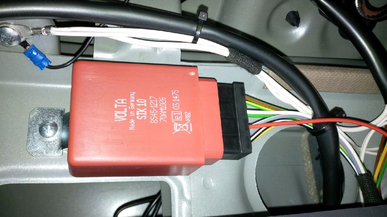

The next thing i looked at was the little red box thing!
Assuming this allows the CANbus to communicate with the towing loom and lights? but beyond that i dont know :think:
Any suggestions on this one?

As your car uses Canbus there should be a Canbus bypass relay for the towing electrics. The relay in the pic could be it although there doesn't seem to be enough wires from it compared to others I've seen, typical 7 inputs and 7 outputs. AFAIK It just converts the Canbus signals from the cars loom to direct DC outputs to the trailer/caravan wiring which will be wired conventionally. If all the wiring connections check out OK it could be a faulty relay. You could try reversing the L+R indicator inputs to the relay and see if it moves the fault to the other side. If it doesn't than it must be the relay. JMO

Hi, 120 isn't CANBUS, just old school electrics. Has it actually been tested on a proper lighting board or caravan/trailer as the testers aren't particularly good and cause issues due to them being fitted with LED's and not appropriate wattage bulbs. Well documented when introduced as part of the MOT. Regarding the connection being removed from the installation manual this is only if you have fitted the bulb failure module referenced by the seperate part number so you need to leave the shorting block in if this module isn't fitted. Hope this helps.
