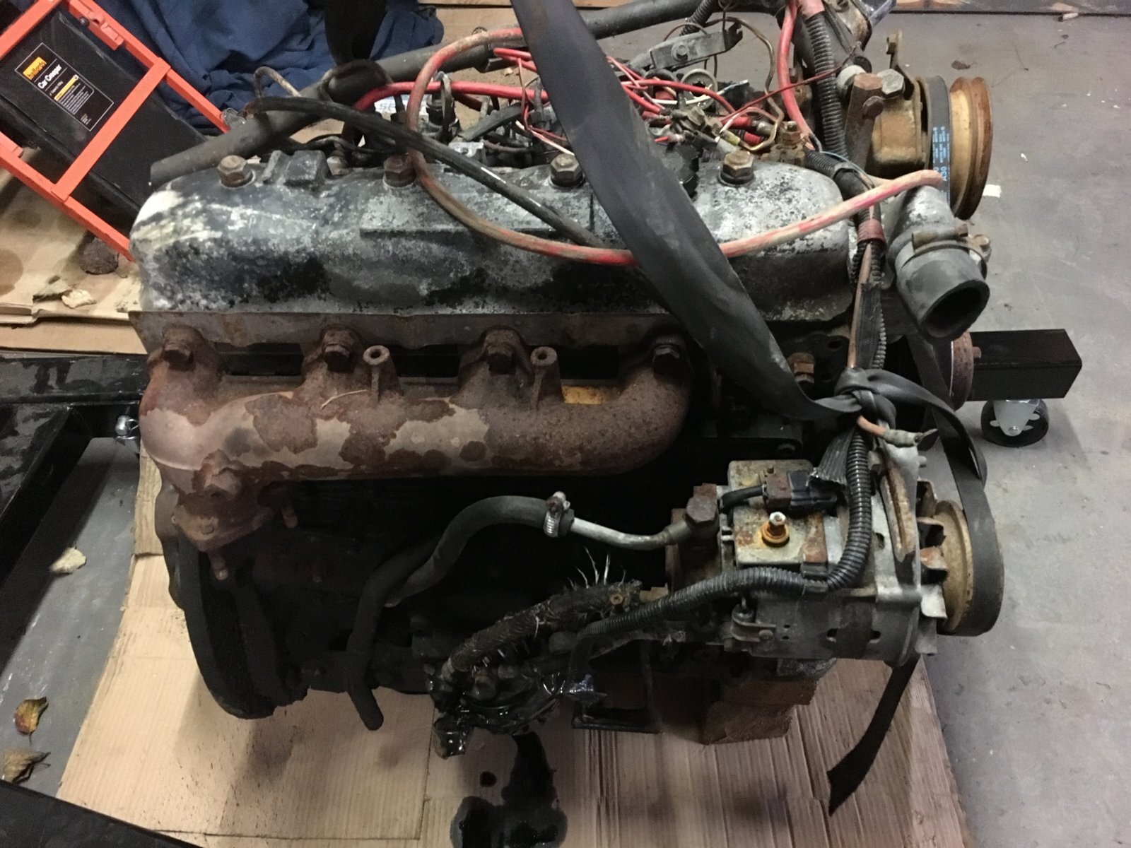

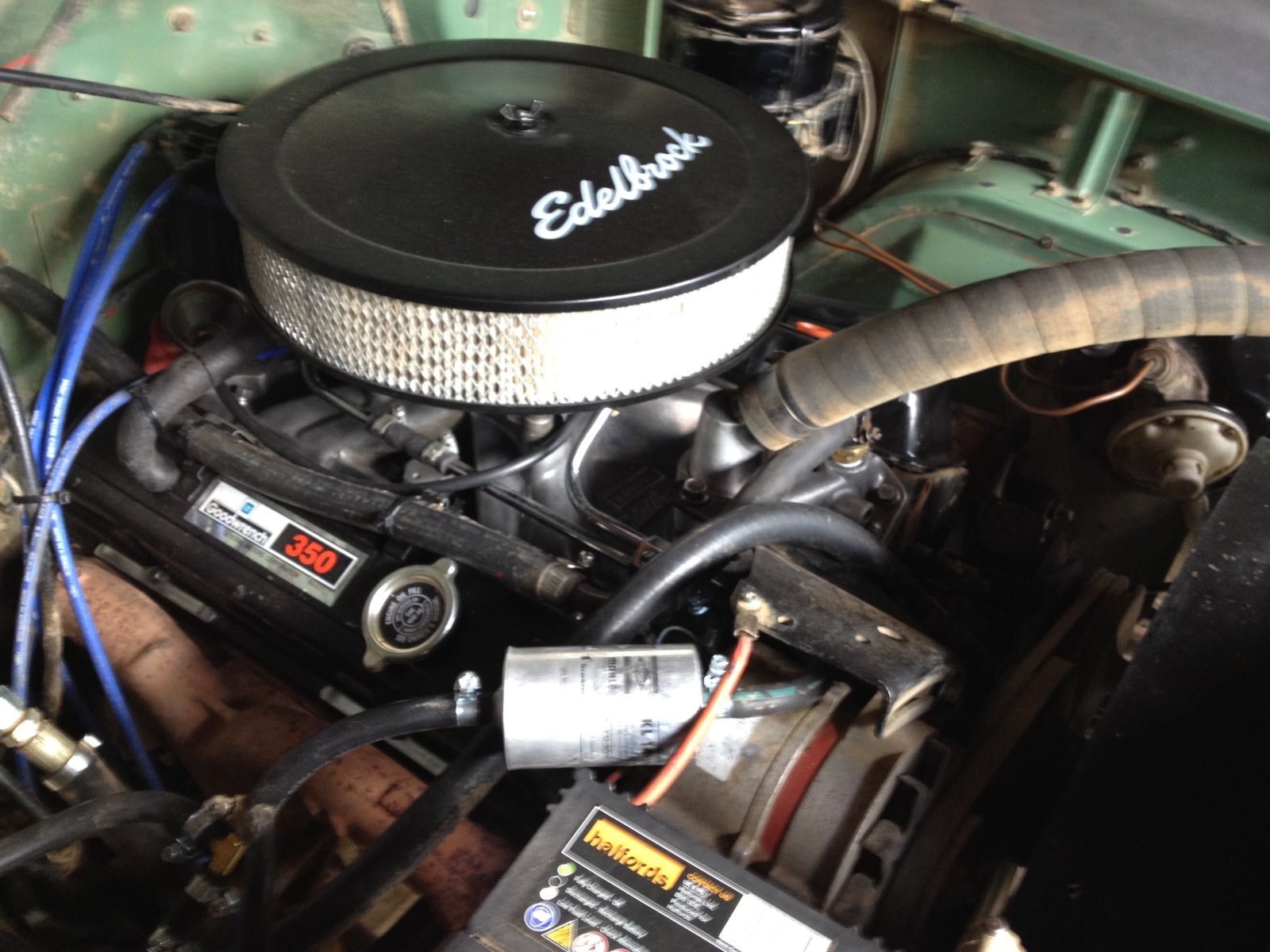

First one as how the engine is now, its a beast but in my quest for the perfect daily driver i cant afford to run the 5.7 litre petrol.

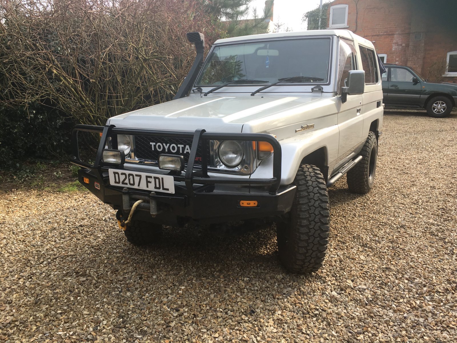

Second image, it the BJ74 its what i have been using as my DD, turbo charging of the 3B will come.

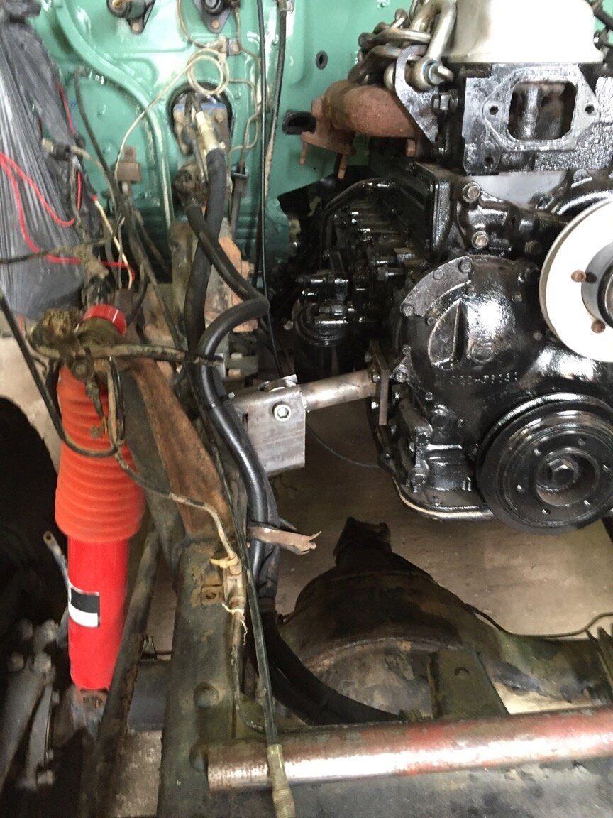

Images 3 and 4 are of the engine as she landed.

by the way the V8 is out, as is the old transfer and gearbox, the complete front end is missing at present, 3B is dressed to go in, (look really nice) the H55 is also all set, we thought we could reuse the bolts but alas they don't fit either but have some on the way, we need to identify and work out the gearbox and engine mounts, if anyone has any thoughts or has done this before so has measurements please chip in. will get some pictures uploaded soon, its moving forward but quite slowly

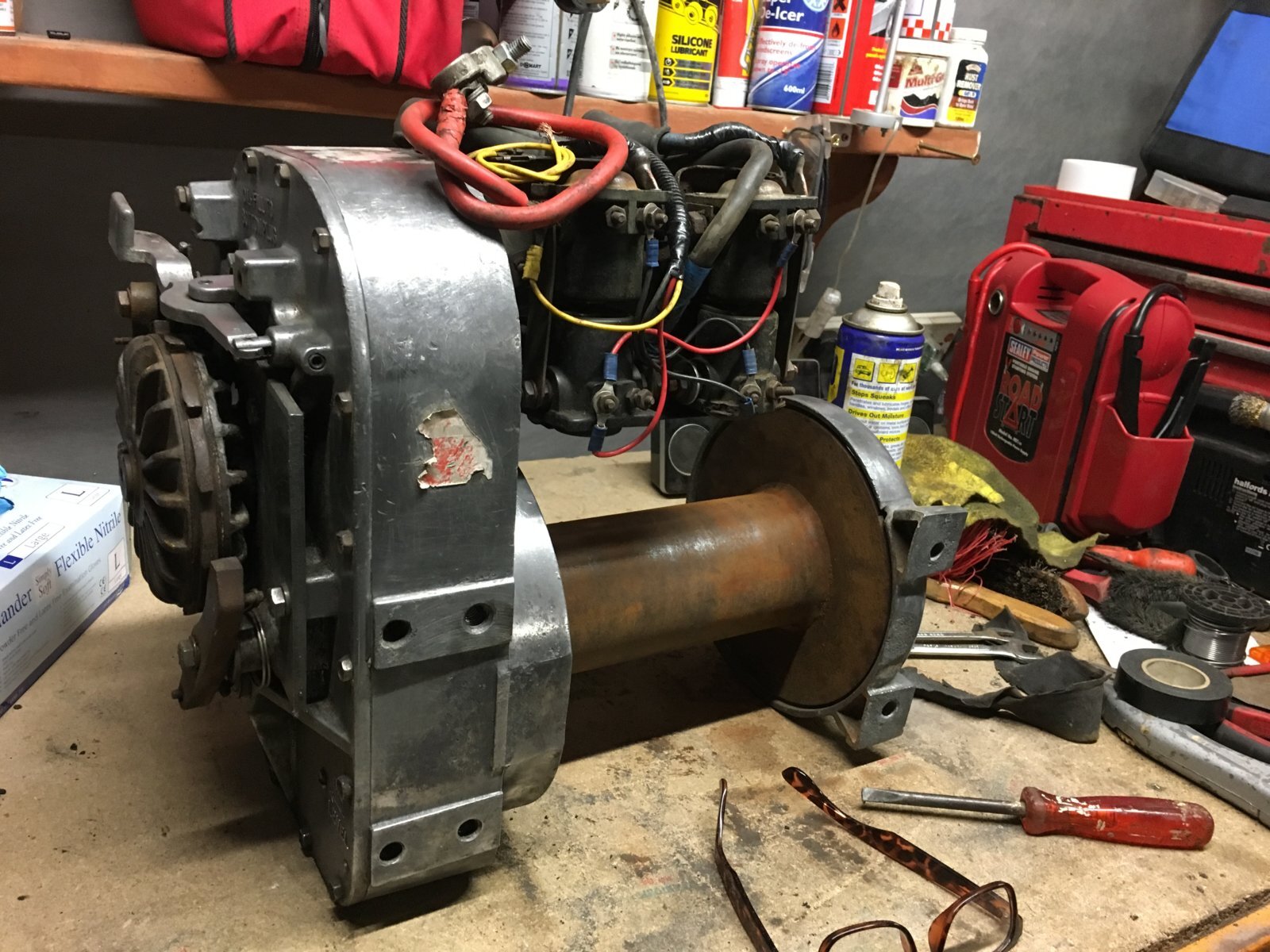

Hi All, sorry for not keeping things up to date, i think i will do a mammoth image upload toward the end. anyways, been busy with the changeover and mainly waiting for bits, eventually got a clutch fork from Canada along with some engine mounts which unfortunately turned out to be falling apart therefore Adrain has manufactured new mounts and used Defender mounts, at least they will be easy to get a hold of. Gearbox is in temporary to get engine fitted, gearbox coming out again some so mounts can be finished, prop lengths done, handbrake to be completed, hopefully in about 3 weeks hopefully be running again. spent weekend in Lake district with the BJ74 and the rain! Parkamoor was fun. next year in the 40 i hope. gave up on finding a PTO for the H55 so have found an old Warn 8200 with some 8274 mods, that will get done with an ARB style front bumper once all running
