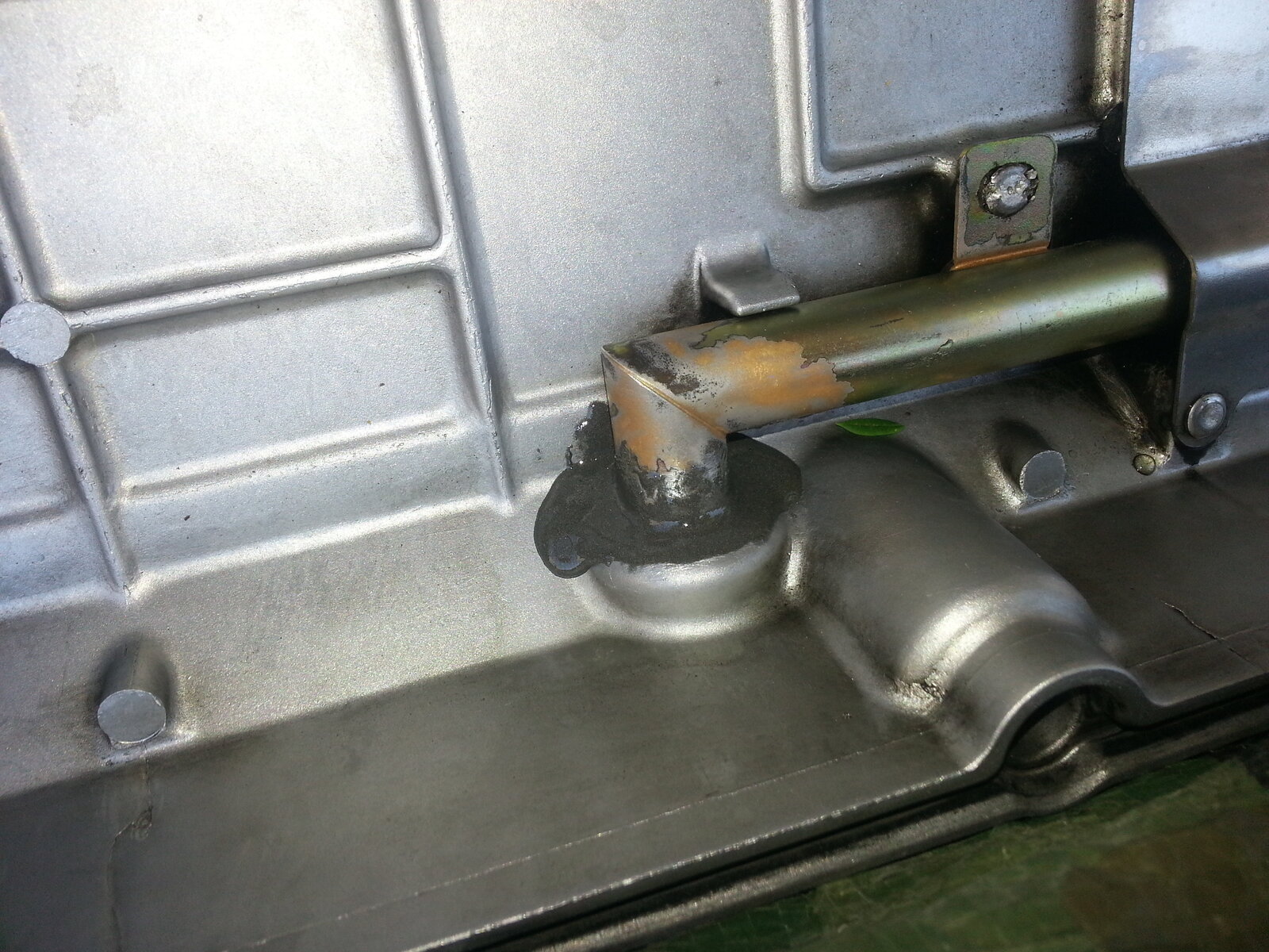

Hi all,
The metal pipe to which the rubber breather pipe is attached on the valve cover feels loose if you wiggle it and the engine is leaking a little oil around the joint.
Is this normal? or is there a oil seal or something that has disintegrated? I can't seem to find a diagram of the cover contraction..

IIRC the pipe is a 'press fit', if it is loose you should be able to gently pull it out and clean it up and refit using perhaps metal adhesive or similar. I not eh cover is a RPITA to remove on the 24 valve but it might be work it to a, check nothing has broken off inside and b, to ensure no sealant gets in side and..........c, hey why not adjust the tappets whilst in there?

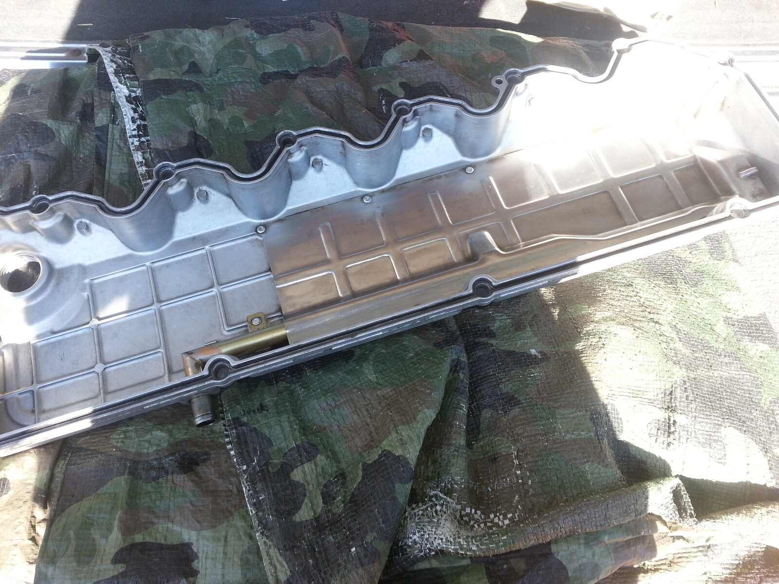

Ok, I finally got some time to take the valve cover off. Why on earth did Toyota place a bolt right at the back behind the cover... :eusa-snooty:
Anyway, it seems that a rivet worked a little loose resulting in the pipe moving around a bit. I just used some metal glue on the inside and outside joint to seal it and hold it in place. Seems to work - no oil leaks after a 220mile trip. :dance:
Checked my valve clearances at the same time - all of them were out (gap too narrow). Engine feels much more responsive now, not sure if it actually is or if i'm just imagining it.

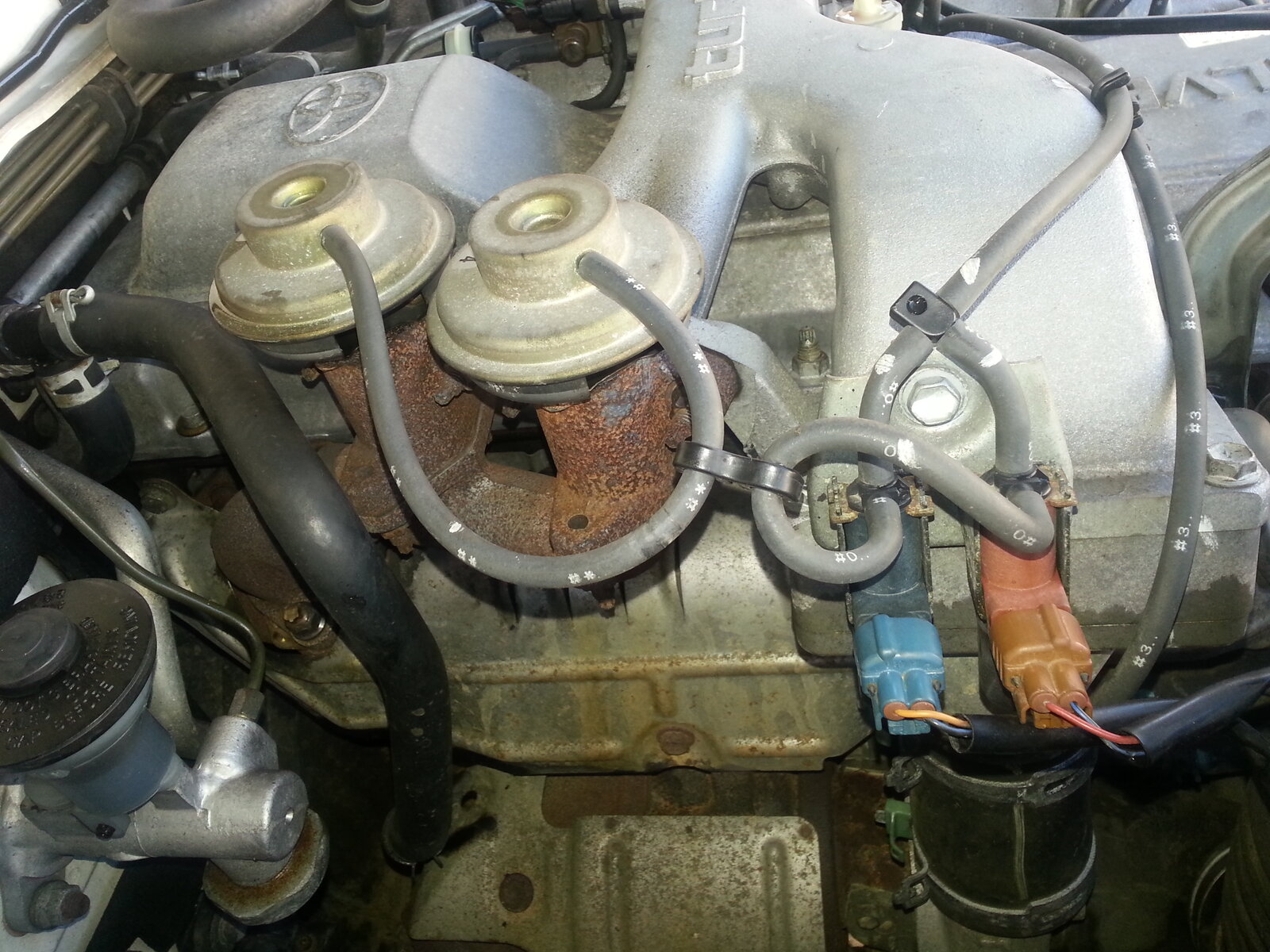

How do you disable the EGR? Do you just pull off the electric sockets on the vacuum valves?

Disconnecting the plugs will disable the EGR but brought up an ECU fault when I tried it on mine. The EGR valves are operated by vacuum. Easiest way to disable them is to disconnect and plug the small vacuum hoses feeding them and leave the plugs connected. This leaves them electrically connected so the ECU still 'sees' them as working OK.

I did this with my LC a couple of years ago with no undue effect.
This shows he tubes to connect together.
