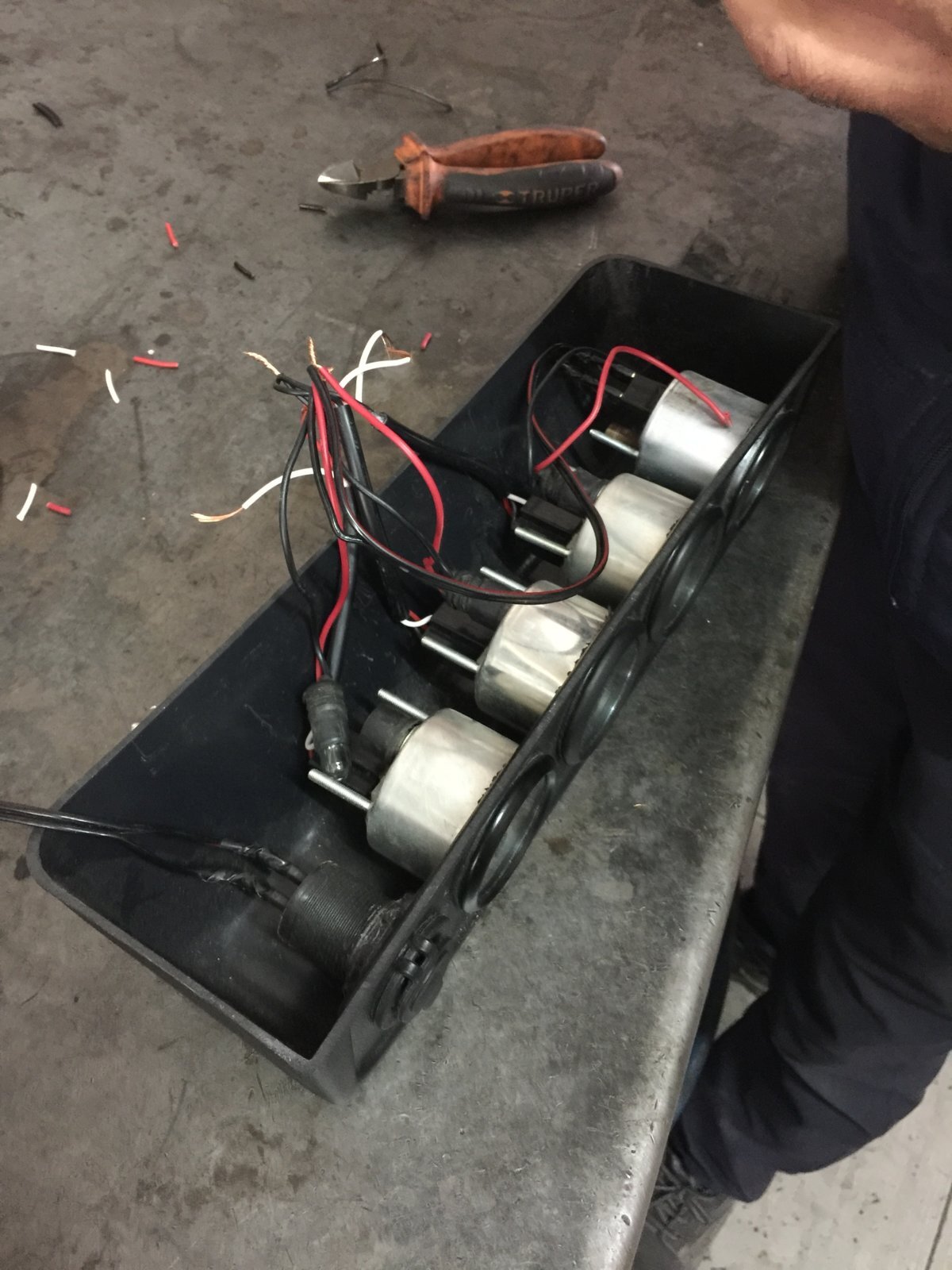

Hi guys I'm in the first stages of fitting VDO's gauges for the dash.
I have the dials but nothing else.
These are:
Altimeter
Oil Temp
Water Temp
Turbo - need hose & connections
Does the 1HDT have an existing facilty to connect to or do I need extra parts?

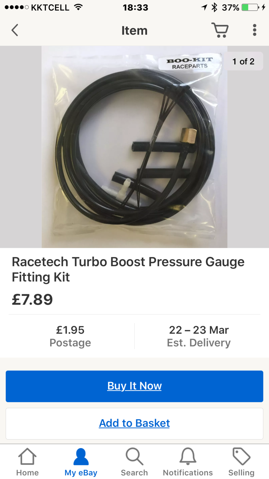

I can't see a vacuum pipe on your turbo sensor but that's how most measure boost so you just cut the turbo vacuum pipe and pop a 99p T joint into the line .

The boost tubing joins into a tube that carrys boost pressure, so as long as its fits the back of your gauge it will work, the tube is cut in two and a T piece added.

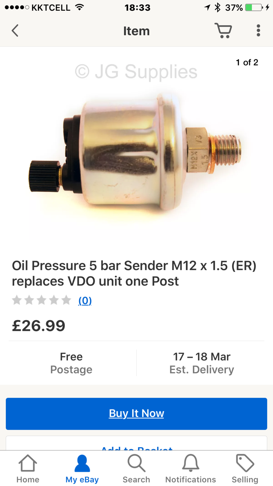

oil pressure i presume will come off the stock pressure sender location so again you will need to find the size of the fittings.

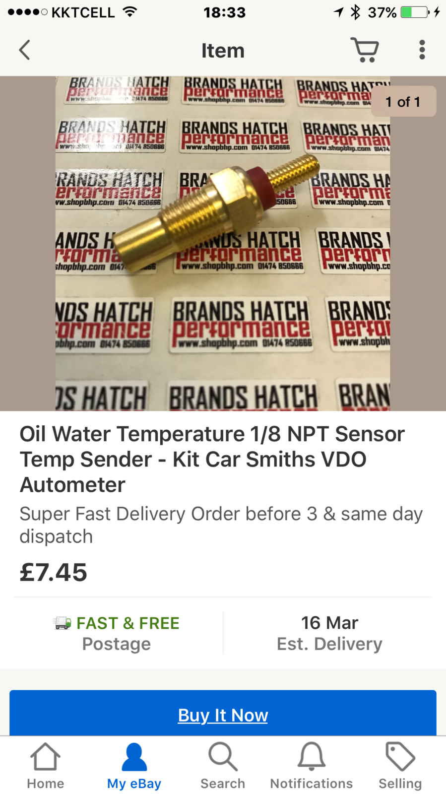

water temp, NPT is a tapered thread so like the egt gauge probe i would say you need to tap out a hole in a suitable location and screw in the probe.

Bought a VDO turbo piping kit off eBay for £10 hopefully that & the new turbo controller will complete this setup for the turbo gauge. As for the rest will research them one by one in the hope to get them all working.
