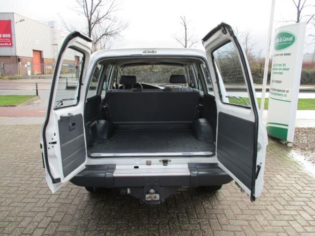

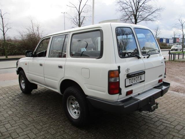

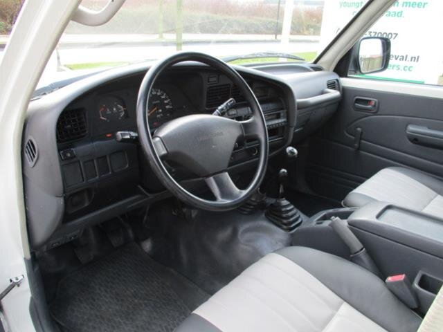

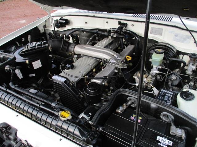

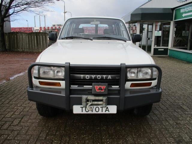

Some Pictures of the vehicle I will be looking at.

I am by no means an expert. It looks very clean and tidy. You need to check for rust and that everything works. It may have a perfect service history and have been looked after and able to do a supermarket/ school run for the next twenty odd years happily. But that is not the same as driving it to/around Africa.
It certainly looks like a good place to start off though.

Also spec other than condition is important to consider. This looks like the non turbo indirect injection model. Would suggest a good drive to see if your happy with the power of the drivetrain.

It is indeed a non turbo model, I drove the same engine in a 78 model in Africa without turbo. Plenty of power off road. On Road no hurry for me, 100km per hours is nicely cruising.

@Balsan get the VIN off the truck. I suspect you will be able to get a lot of info off that. That bar in front does not look like something toyota did.

No, I suspect that is a modification requested from the fire department, and done by a local company. I will check it out!

It's an HZJ with the same ambulance doors as mine and at 100k km it will be like new mechanically, I'd guess, and it does look like new condition jenerally, it's a very good example of that model.
It doesn't seem to have axle diff lockers though, I don't know if that's important to you.
The interior looks sparse as mine does, but it will be adequate.
However, as said, €24k is a humongous price, even if it's new underneath. If it's lived its life in Holland, then it will have suffered winters, but as Richard said, the fire service would have looked after it mechanically.

The 1HZ engine has no turbo and very few electronics, it's a tractor engine that will go to 1,000,000 km if maintained well. It drives like a slug compared with the turbo 1HD, but it's got loads of torque, and it's unstoppable.
