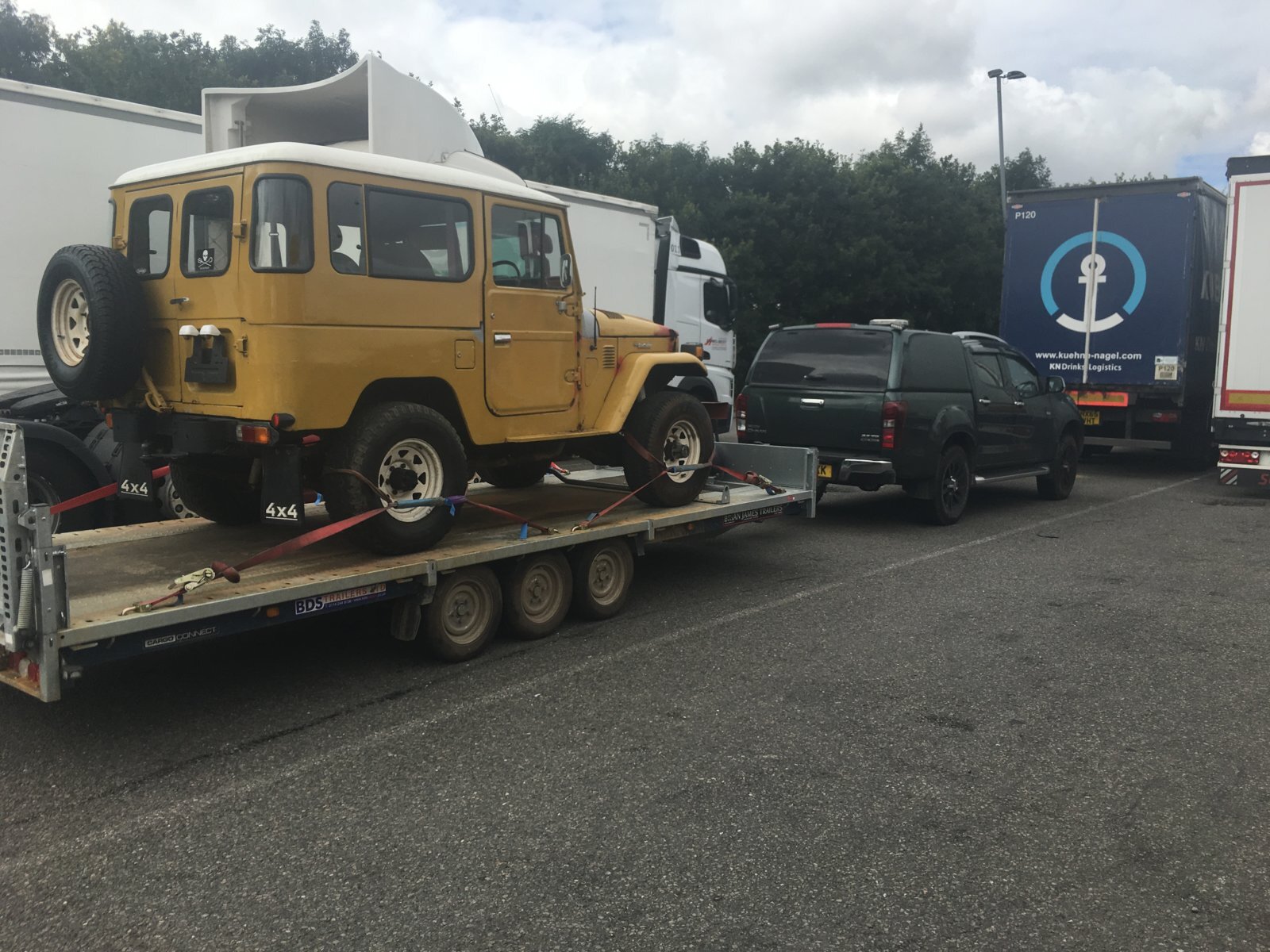

My Bj46 : 1960 kg with full diesel tank, pto winch (heavy) and a fibreglass hardtop. (Bj46=a bit longer than a bj42)
im just trying to get an idea for either transporter or trailer
they can't weigh much as I don't know mine is on my trailer, it is a whole lot less than a standard 80 for sure
