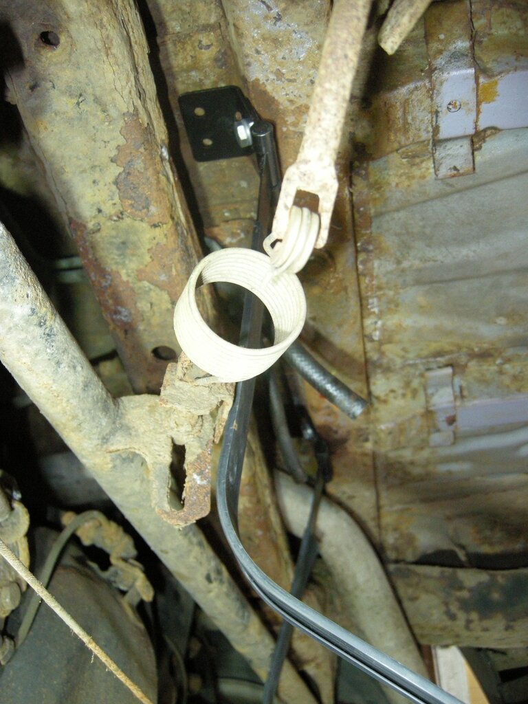

In July 2015 I bought a pair of Tank Straps for the '95' from Toyota - via Simon Holton.
£86.88 each, with 11% discount = £154.65.

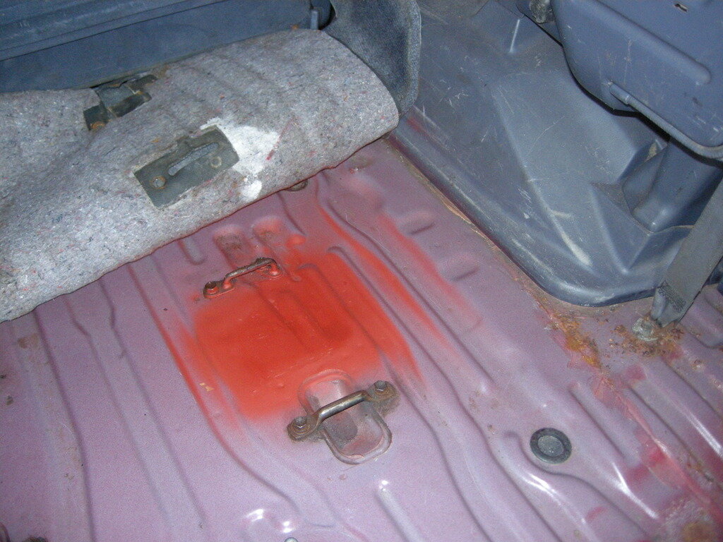

I sheared one of the upper strap bolts off :doh:. It is impossible to get a drill near it so I cut a hole in the floor above the cross-member, cleaned-up the bit of thread I could see, heated it with a gas torch and unscrewed it with a mole grip :thumbup:.
When it was all finished I welded a plate flush with the floor and gave it a coat of the only red paint I could find:
New stainless bolts and new straps made the job a good-un :thumbup:.

I didn’t fancy my luck with trying to remove the front strap bolts, luckily the back ones came out whole with heat and an impact gun. The straps were not too good, one had broken and the other wasn’t far off, but the brackets had plenty of strength left in them and the rubber strips were still useable. After getting the length and width of the old straps, I cut a couple of new straps about 4ft long from 16g sheet steel and gave them a good zinc spray and paint. I cut the old straps off, leaving a few inches below the front and back hangers. After a fair bit of heat and easing oil, the pivots freed up, I passed the new straps through the front hangers , bent them back over the tails I’d left, drilled and put an M8 bolt through with washers. I did the same with the back hangers, using the length taken from the old straps. Not as tidy a job as complete new straps, but they’ve had plenty of bumpy tracks and no sign of problems so far. I had the steel about, but if you fancy having a go, a steel supplier might cut you a couple of strips or try somewhere like this: https://www.themetalstore.co.uk/products/1-5mm-thick-mild-steel-sheet and cut your own.
