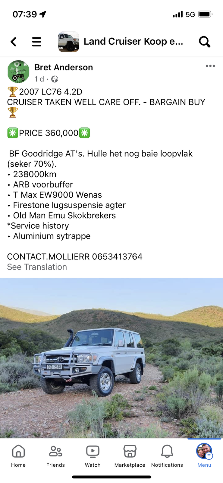

Hey folks, trying to do some thinking here - which 70 series CAN be imported into the UK without too many issues??
