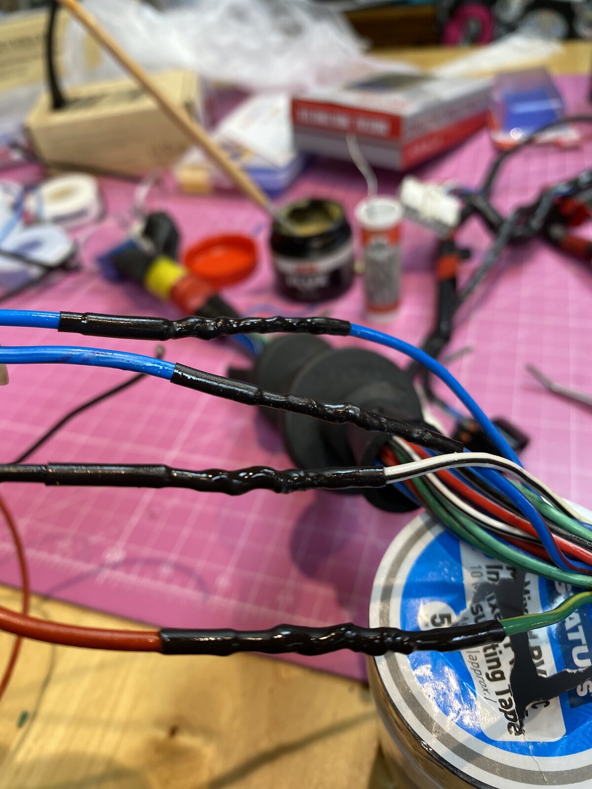

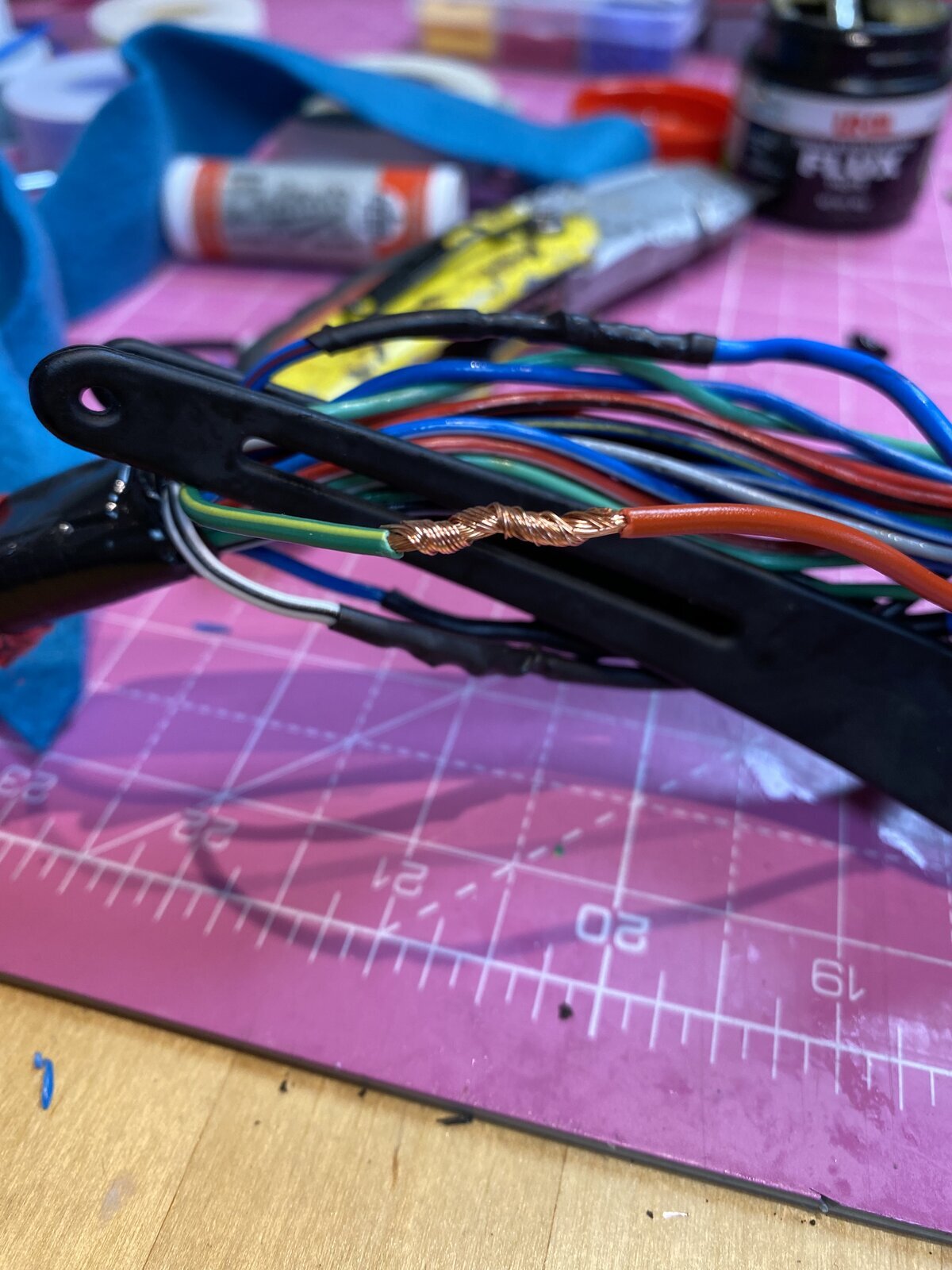

Thank you all for your help. I managed to fix it. 4 wires needed replacing with a donor section of about 8 inches so the joins could be either side of the door closure. Thought I had bit off more than I could chew but got there in the end. Window working perfectly and I managed to silicone the runner beneath so it’s better than ever. So once again thank you ps yes that is a hair clip being used to hold the wires and who knew a sewing unpicker is perfect for removing old electrical tape without damaging any wires beneath lol
