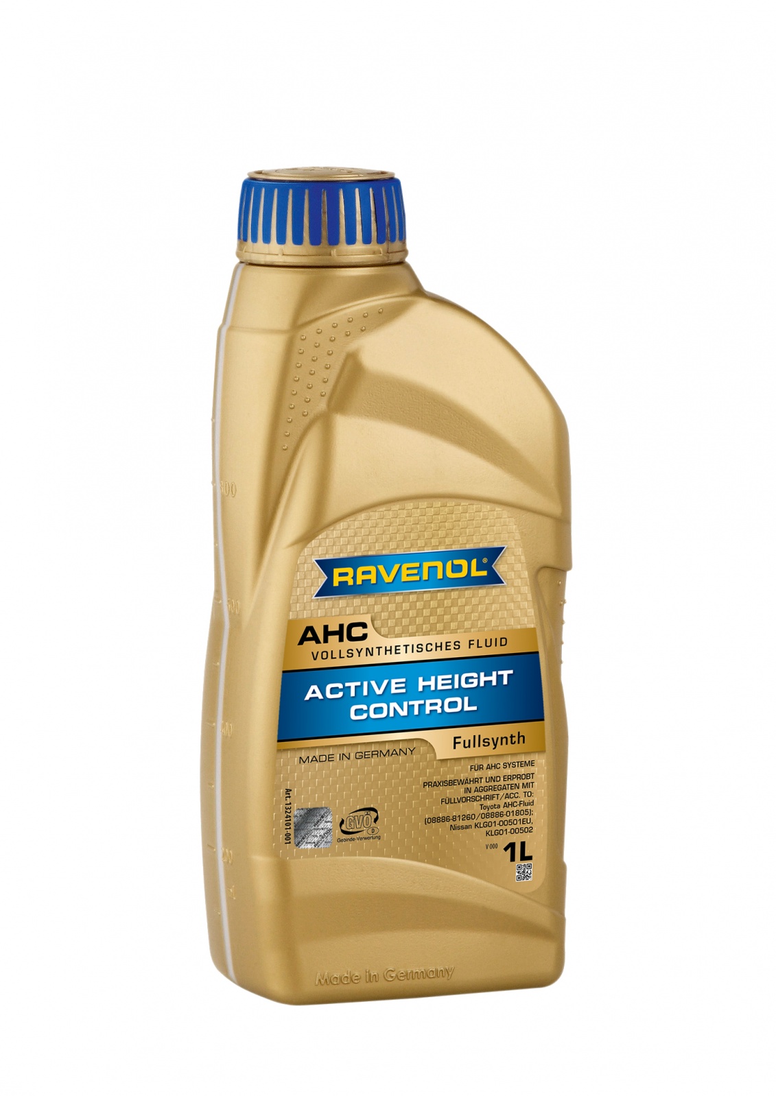

Hi there, I’ve changed my back hydraulic shocks and lost some AHC fluid in the process. I need c. 1 or 2 litres but most places can only sell 5 litres.
RAVENOL AHC Active Height Control Fluid for Active Height Control systems (AHC) for Toyota, Lexus and systems Hydraulic Body Motion Control systems.
www.ravenol-direct.uk
These are selling 1L but don't know if its ok to use any other makes or if anyone used thisbrand.
RAVENOL AHC Active Height Control Fluid is suitable for use in the following vehicles: Toyota Land Cruiser 100 and 200, Lexus LX470 and LX570, Nissan Patrol, Infiniti QX.
