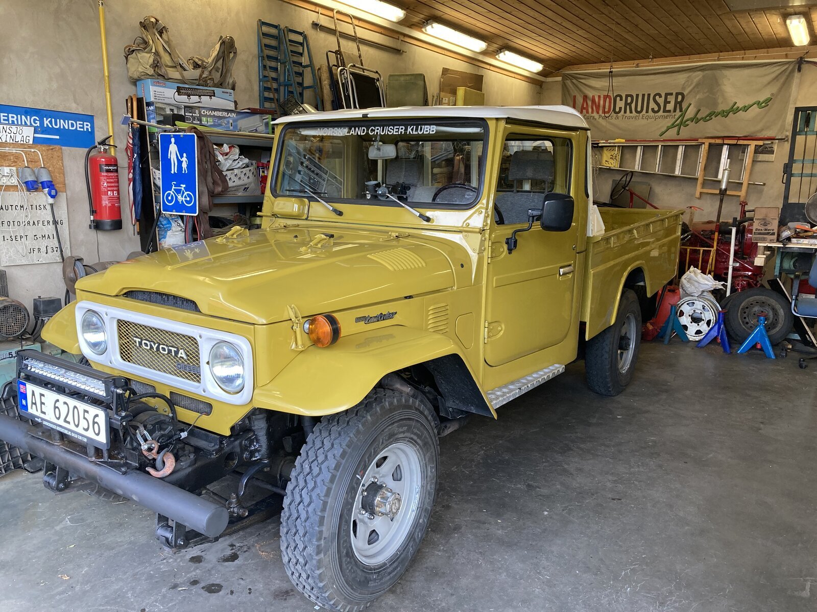

Sorry for interrupting in this conversation, but could someone tell me if there is any different about the length between a 4 speed and a 5 speed gearbox?
You see, I have a HJ45 with a 2H and power steering from HJ60, but 4 speed gearbox. In a way a half HJ47.....
I can post a new tread if you like, but since you both seems to have good experience when it comes to HJ45 and HJ47 so...

Hi Dag great looking HJ47 I can not remember but I bet Andy Lomas will now all the best Tony
