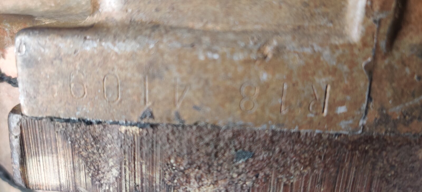

Pulling my hair out. I am somewhere Between "WOW I have the coolest truck in the world" and "F, what have I done?". Two weeks into my new to me troopie 78 purchase the transmission started popping out of 1st gear. I am okay with that and happy to do the work but I am supposed to have a R151F transmission, but found these markings saying R18 (see picture) Im just trying to figure out what rebuild kit I need and will do the rebuild myself, and with the help of a friend. I just dont know how to identify the tranny. Any advice would be great.
