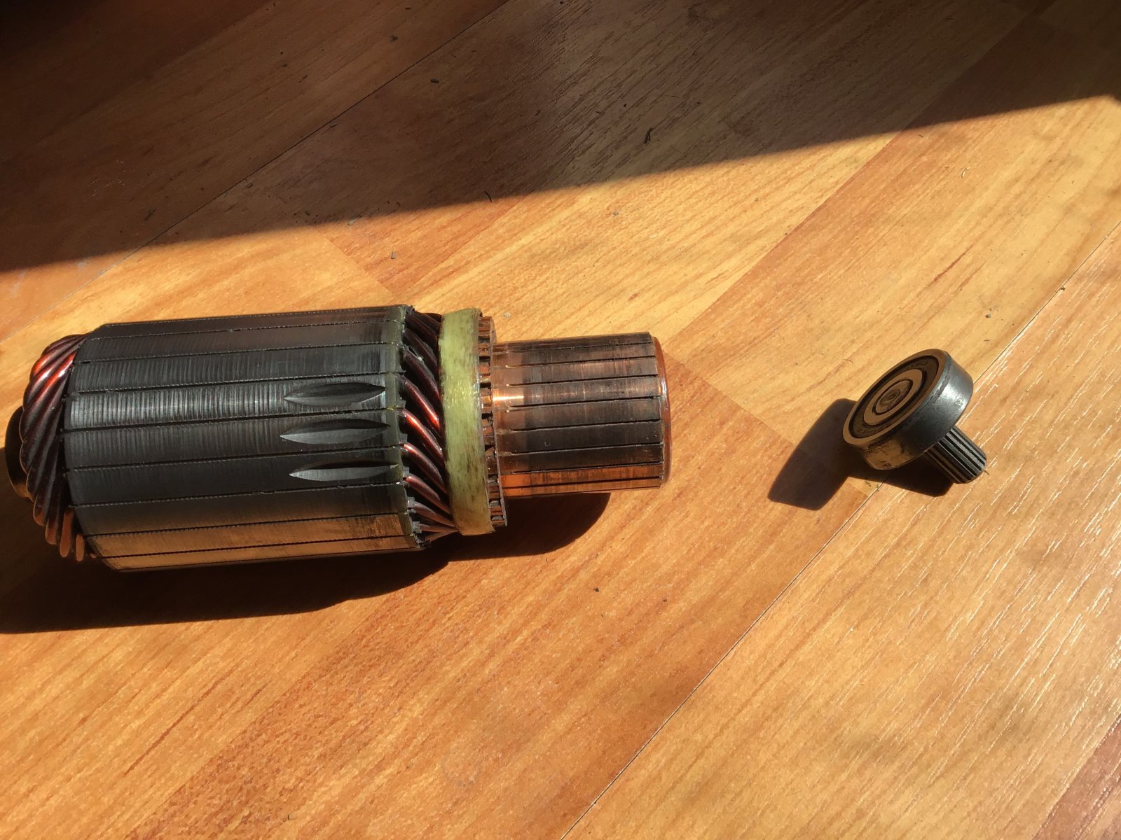

Hi All, hope life is sweet in the Land Cruiser world, long time no problems, but yesterday the truck didn't start.
Battery and connections all seem good, the starter motor just makes a whirring sound maybe with a little whine.
I've taken the starter motor off and to bits, it was full of clutch dust , cleaned it all up, re-put it back together but it's still got the same problem.
All the gears, and their teeth and clutch mechanism seem ok, as does the magnetic switch when I test that.
I'm guessing we've got some spinning because of the noise, so I'm a bit stuck as to the issue.
Weirdly if i carry out the last test in the handbook it doesn't spin at all, but the gear goes out?!:
Anyone got any idea, I'm kinda loathed to buy a whole new starter motor as I know you can get all the bits and it doesnt really seem that complex! - though it is my first time to look inside one
Thanks for your help
