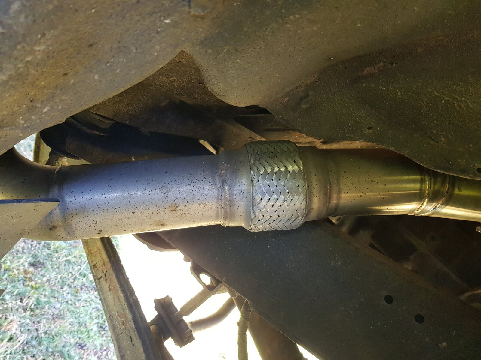

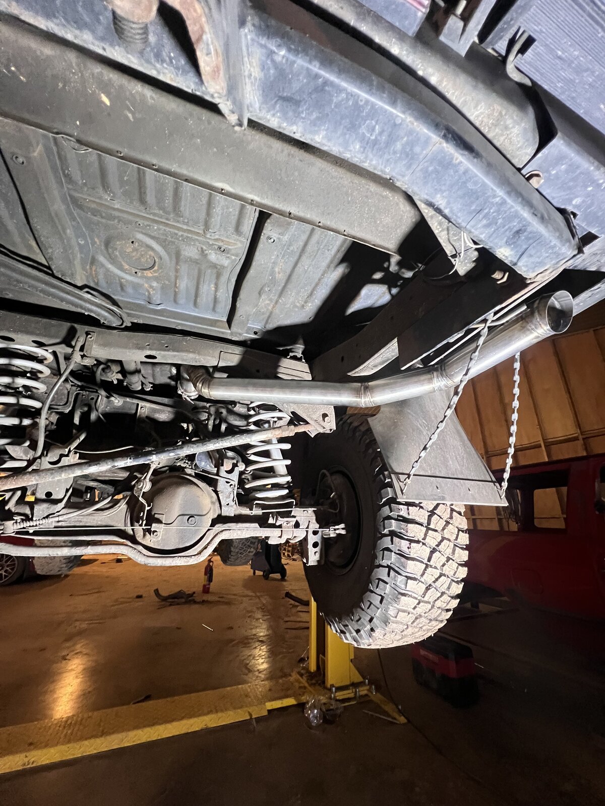

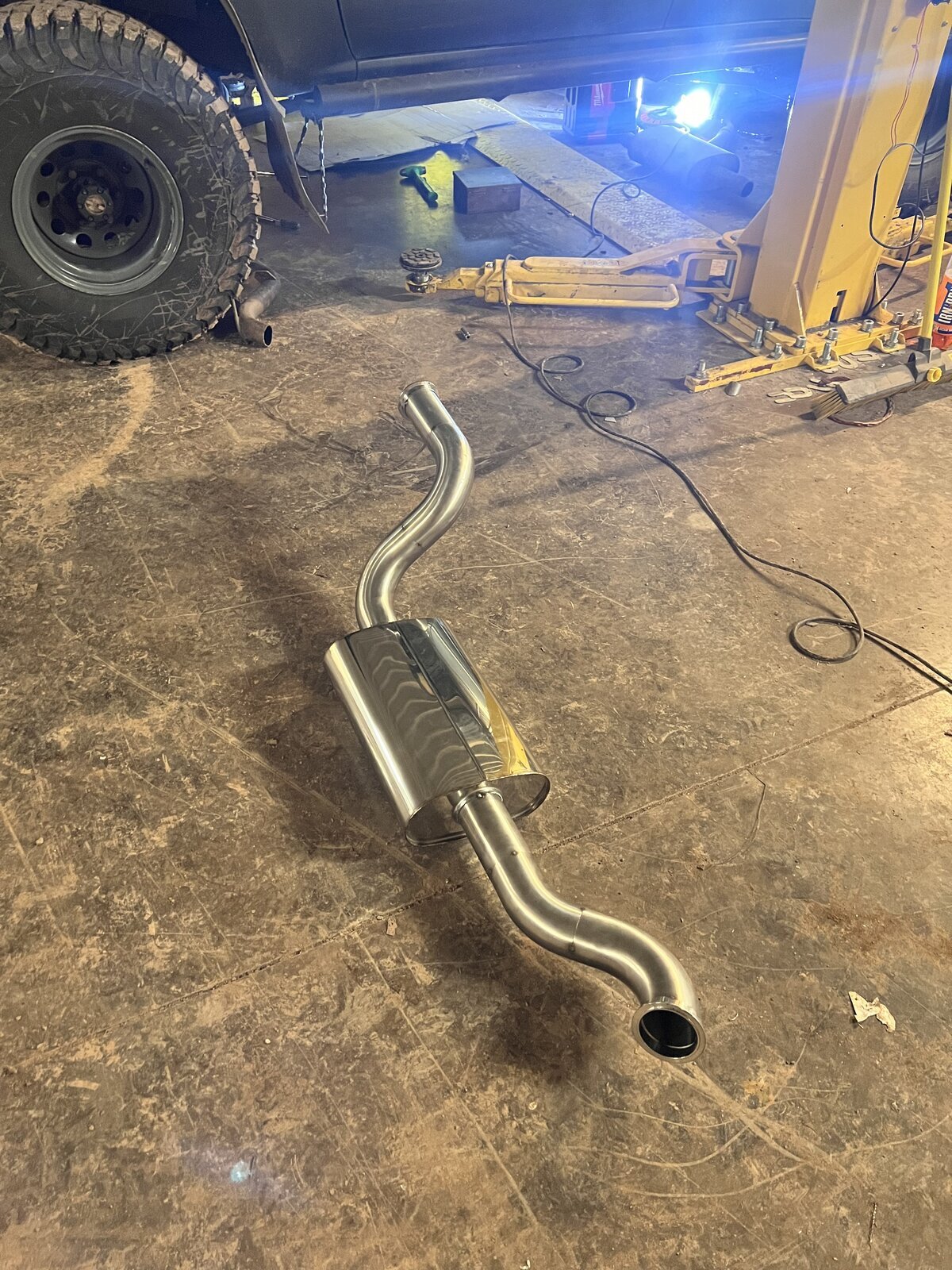

Hello! I have recently completed a 3” exhaust system for a series 80 4.2 manual and the client recommended I posted it on the forum.
Please see the attached pictures. This particular example is a manual however I plan on test fitting them to the Autos in the near future.
With v band flanges this entire system can be removed with a 10mm and 14mm in a matter of mere minutes.
Made from 304 stainless and backpurged TIG welded it will certainly hold up to even the most demanding expeditions.

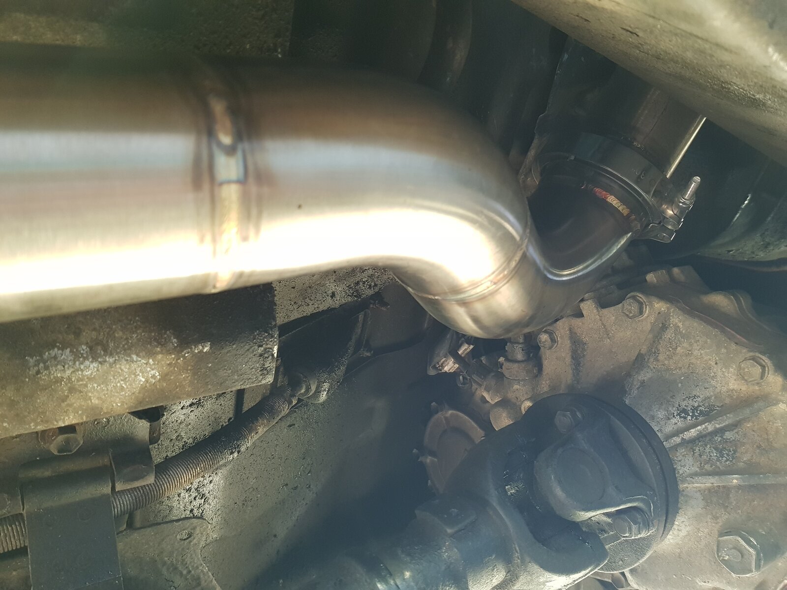

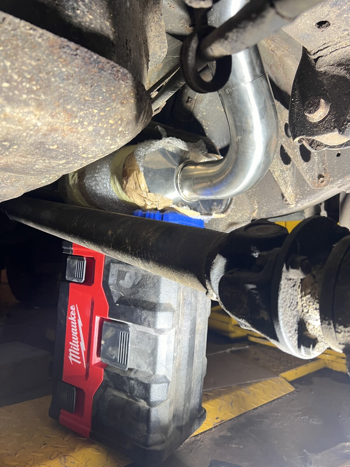

That is a good looking exhaust and a very reasonable price.
Can I ask, does it attach to the existing dump pipe on the turbo, or does it attach directly to the turbo thereby replacing the dump pipe?
It attaches to the turbo dump. From a performance standing the cast elbow is more than adequate and it saves a great deal of time and cost.

Yes sure, have some from in the mountains of Portugal!

The back half...all been made with V band connections, which are much better in my opinion at sealing, going together and coming apart again. No crappy stripped studs.
