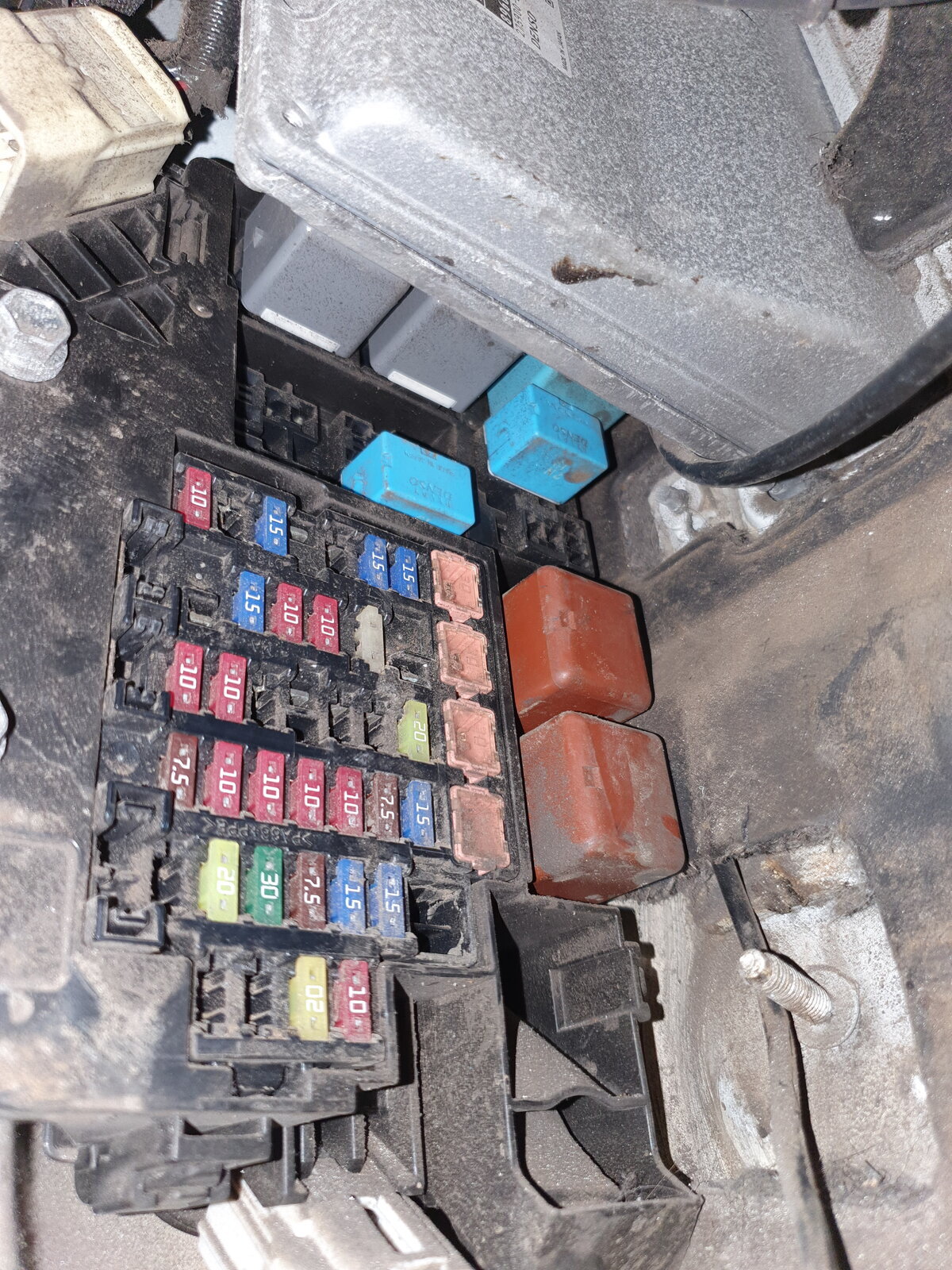

My park lights and number plate lights arnt working, does anyone know if these are switched by a relay and where the relay is located
I found the fuse box but it has no diagram
What year etc is your 79? I've got the Factory Repair manuals so could check in there for you.
Out of curiosity what lights are you calling park lights? I guess you have different terminology in Oz to what we use in the UK.
Ok got you. I'm just looking through the drawing now so hopefully I'll find something useful for you.
Ok here is the wiring diagram, the side lights are called front clearance lights on there and it looks like everything is powered via the tail light relay.
According to the manual you have to remove the ECM to get to the relay. Location of relay as shown in this pic.
I'll have a look and let you know. I've got the factory repair manuals for the 70 series so should have it

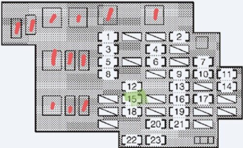

Hi am new here! Can anyone help me label this relays I've marked with red...
