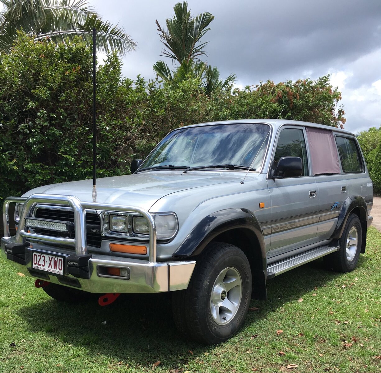

hey guys after a bit of advice really, (sorry for long post) had the 80 series petrol for about a year now and it suddenly has started with a very intermittent smoking issue. I drive it aroun locally and it’s always been great no smoke on start up and uses no coolant or oil, however just come back from a weekend of camping and was driving great did about 70km on bitumen (80-100kmh) slowed down to turn off the road and she belched a huge cloud of blueish/grey smoke (so bad you couldn’t see the road) no noises, temperature and oil pressure gauges sat as normal. Switched it off then back on smoke cleared and was then fine? Did a bit of 4wd yesterday no smoke at all. Yet again driving home traffic free stopped at traffic lights after about 50km then exactly the same thing, loads of smoke switch it off and then cleared. Any ideas? it doesn’t seem to be a ring or valve seals as it seems very intermittent and doesn’t smoke on start up, possible pcv valve sticking open? It literally seems to be taking a gulp of oil from somewhere as you come to a stop after a run. Any ideas will be much appreciated, And have a picture of her as a thankyou for taking the time to read the long post.
