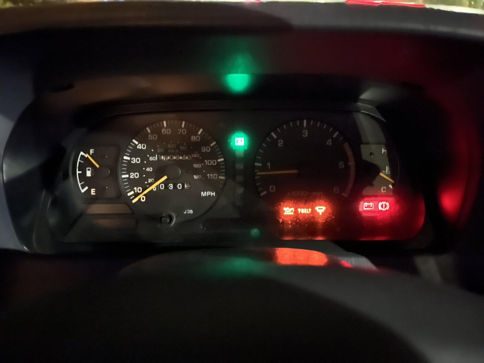

All lights come on. Started with a booster but lights still on. Drove to garage. Guess it the Alternator? Batteries all showing fully charged. Couldn't check the Alt output though. AA Breakdown didn't have a Multimeter!!

Yep, sounds about right. Its the alternator defo confirmed today. Annoying thing is I had one fitted 2019 and 25k miles ago. A Delco Remy one. guess they are crap then!
