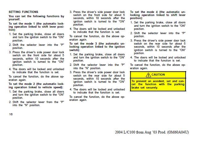

I would like to add a simple automatic way of locking the doors - for extra security - and have found in the US??? version of the owners manual the following section
Having tried this on my UK spec truck doesn't do the open/close confirmation/doesn't work and not mentioned in the UK handbook. On the basis that the functionality may be in the s/w system somewhere does anyone know how to enable this US feature on a UK car?
