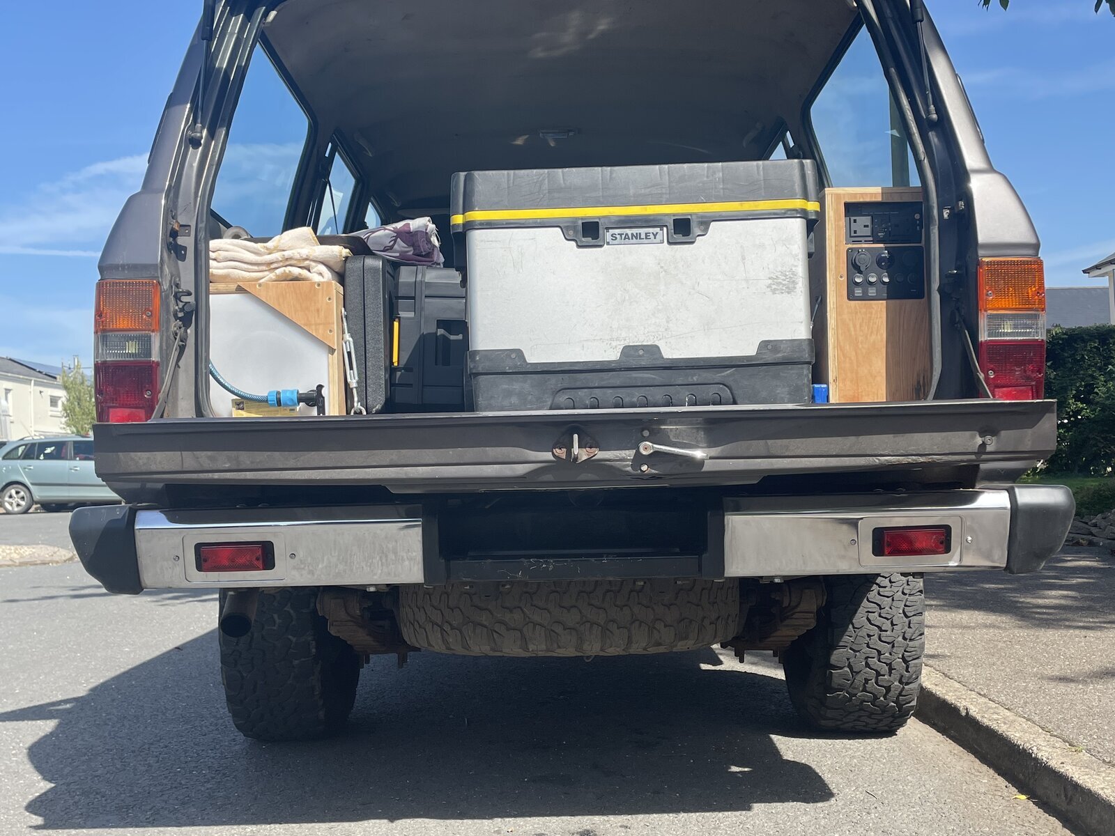

Lower tailgate had become so rusty I was expecting it to fall off. Took a while to find a good one to replace it with.
And After several days of work changing from a champagne colour to Toyota 153, I replaced it today:
Need a new number plate as the holes are in different locations which means the number plate is too low. Also need to stick on the GX badge. But quite pleased how it came out.
The paint prep was poor ( missed a small dent! ) and the painting too and the lacquer was spoilt by rain leaking through the shed roof on to it but I learnt a lot.
Better than the old one and with half a kilo of cavity wax inside it should last a while.
The upper tailgate is the next in line then the drivers door.
