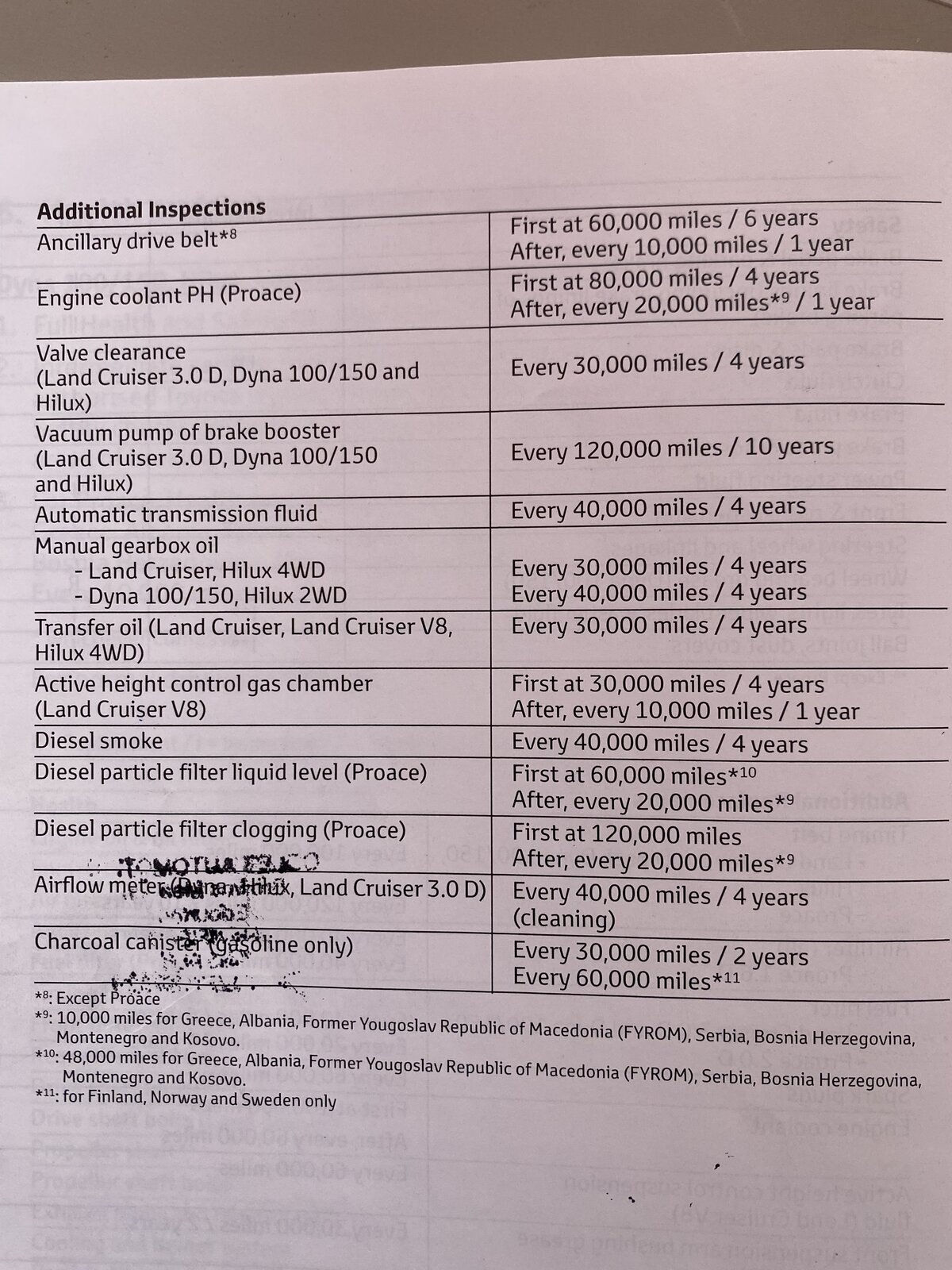

Thats something to investigate. I thought all LC200 have kdss. I will check car tomorrow and update. When I sent mine to service at toyota, I asked them to change all the oils, transmission, break, differential, etc etc, then fuel filter as well but given short time they didnt change all those oils. After service from toyota I drove about 100 miles and I felt its not powerful enough (I expected it to react to feather touch acceleration but I have to do hard press for it to move) so I took to a independent 4x4 specialist. He tested and told its fine no performance issues. May be I have to get used to diesel engine with such heavy body. I am planning to send it after few months for another full check and get all the oils changed. If I interpreted correctly in owners manual (page 24 of service manual), auto transmission fluid should be changed at 40K or 4 years. My car did 50K miles now.
4 years and 40k seem like low numbers to be honest. Any chance you could take a picture of the page where it says this and upload it here?

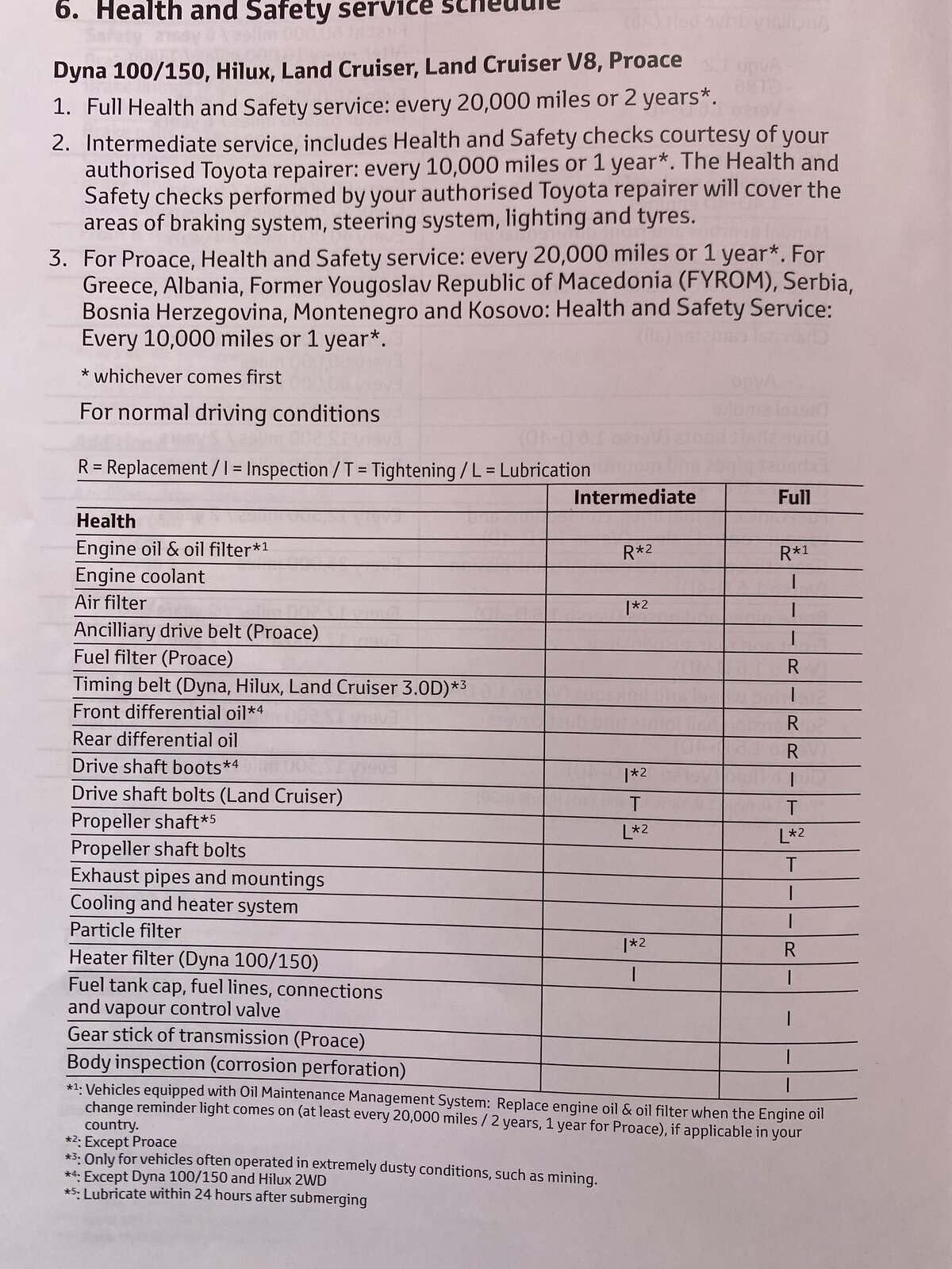

It's inspect at 40k km, or 48 months. Quite what inspection you're supposed to do I'm not sure. Pour a bit out and check the colour?
Diff oil is replace at 40k km.

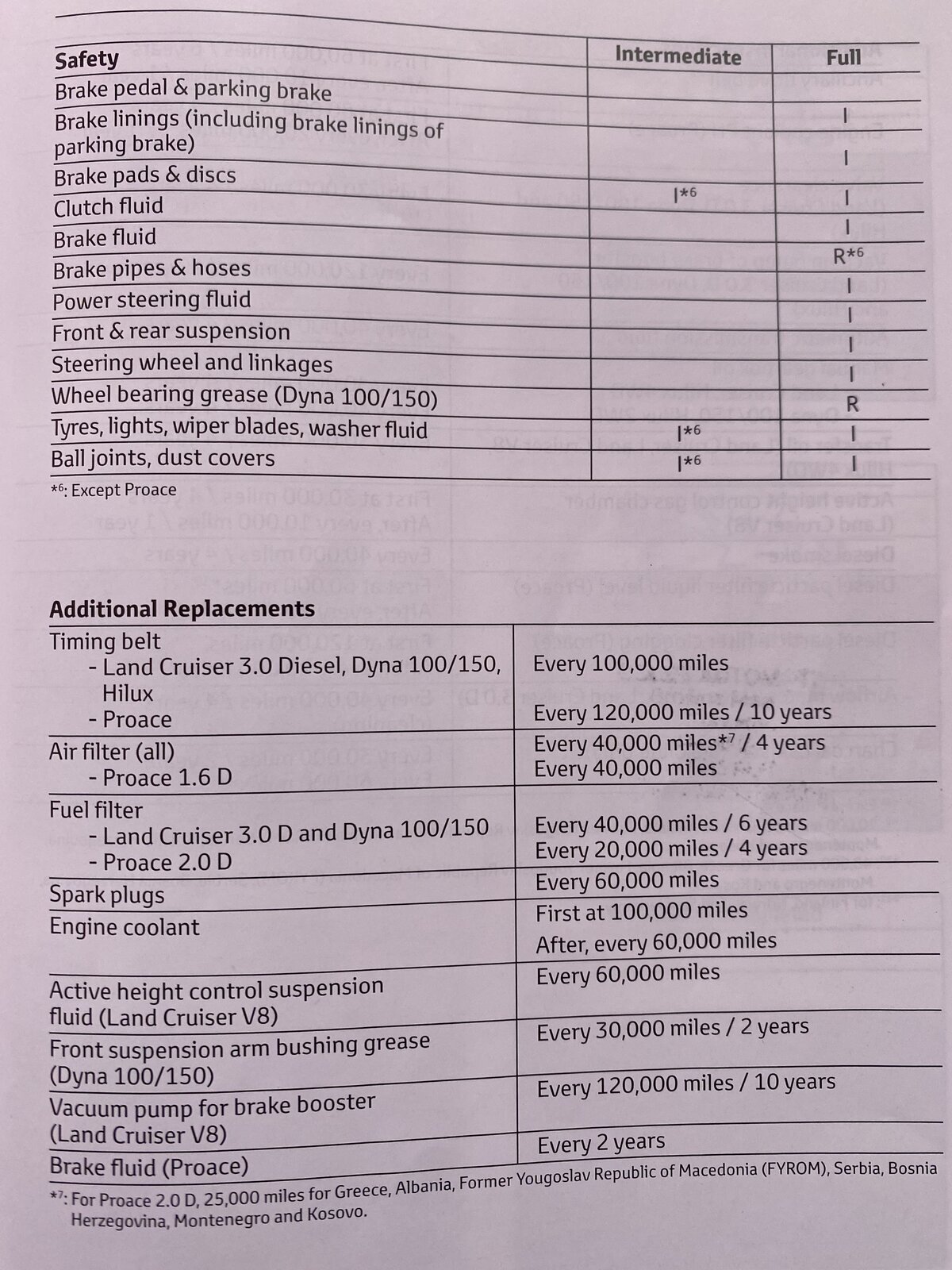

Attached pages from service manual showing autotransmission fluid change interval. Also attached 2012 LC200 Europe brochure. Looks like what we have in UK is the luxury model from that brochure and on page 33 it says KDSS is not available on luxury model. Not sure why and may be luxury model 200 is only for onroad driving.

Be aware that transmission fluid is left in the pan and the transmission cooler pipes when it is drained at the sump. Follow Project 200 for the right way to change the transmission fluid. My 200 series weighs 3.1 tonnes and goes 0-60 mph in 8 seconds. That's fast enough for me and it won't be that much slower towing my 2 tonne caravan. There are techniques to spool up the turbochargers before launching form a standing start so they are making boost early on. The ECT switch makes a difference to performance but we are not sure if that changes engine programming or just transmission shift points. The Australians take these cars thousands of miles off road with no problems. They know these cars backwards so join the Facebook page. You will learn a lot. There are many specialists in Australia that programme the ECU specific to your needs. There are 4x4 experts here but I don't think they would know the 200 series well enough. For a start they have to have a 4 wheel rolling road. I have looked into this and it would mean buying a spare ECU to get it reprogrammed to minimise the time the car is off the road. When it comes to transmission oils, I am changing completely to synthetic. Yesterday we used the Clearview towing mirrors properly for the first time. They are seriously good. Highly recommend them.
