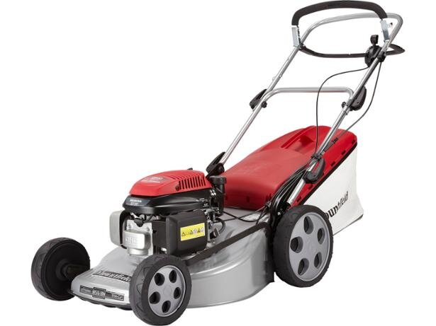

I'd like to think it's one of these
But it's really one of these
http://www.mountfieldlawnmowers.co....owers/sp535hw-53cm-self-propelled-lawnmower-1
