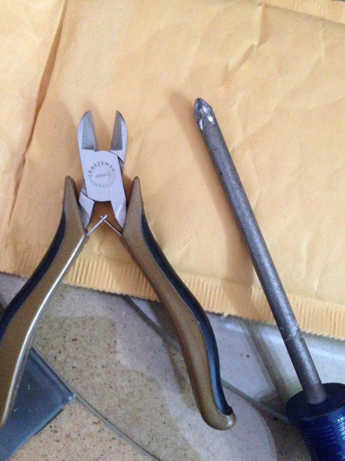

Tools needed: Phillips head screwdriver and a pair do small snips to cut 1 zip tie

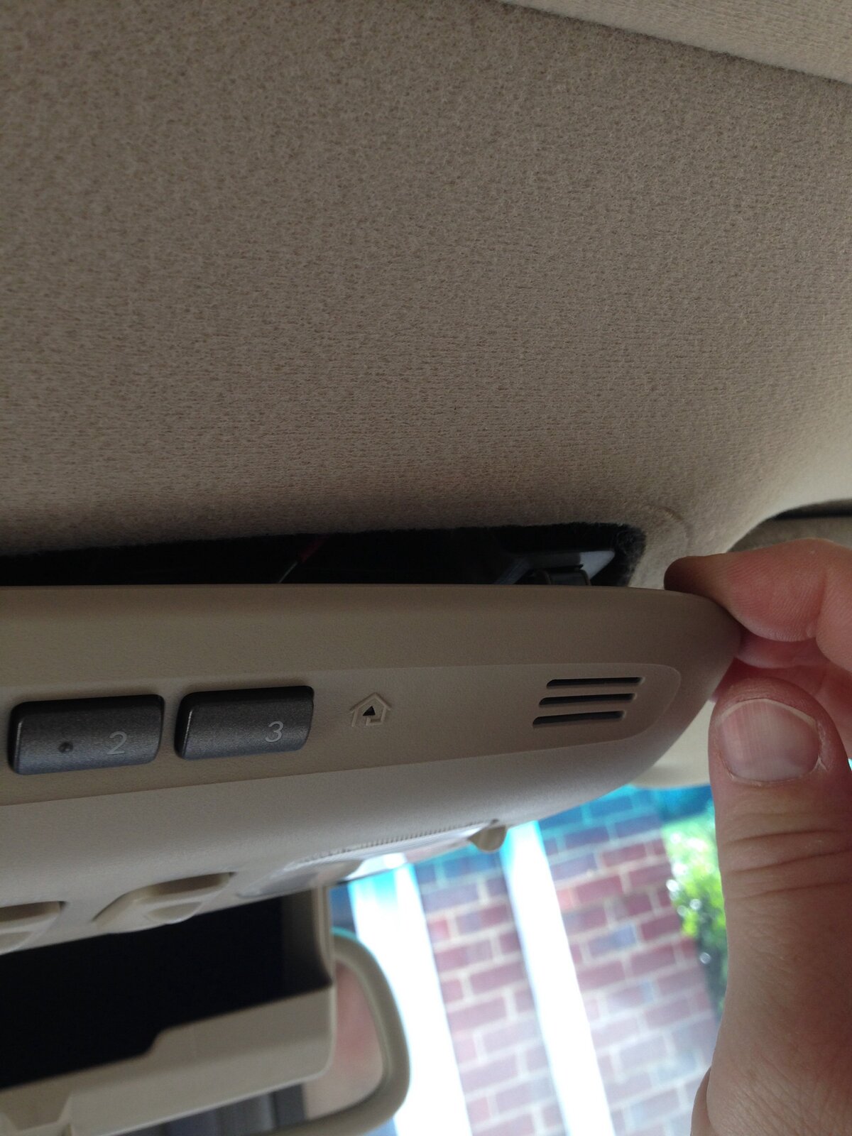

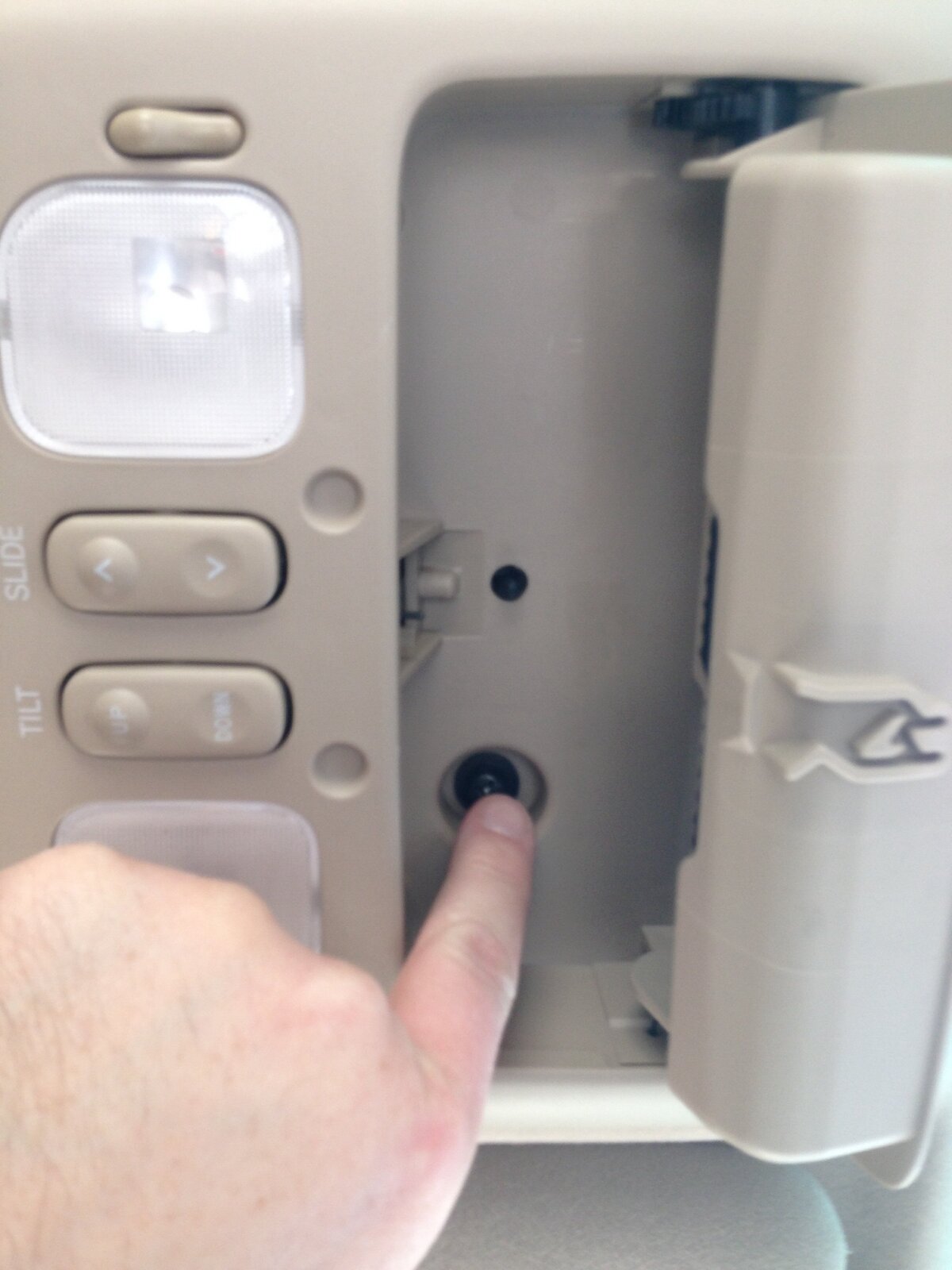

1. Open sunglass compartment in overhead center console
2. Remove the 1 Phillips head screw and set it aside in a safe place

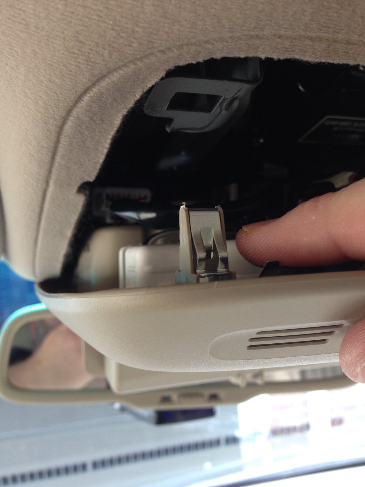

3. Slip you finger between the overhead console and the headliner and pull down easily but firmly

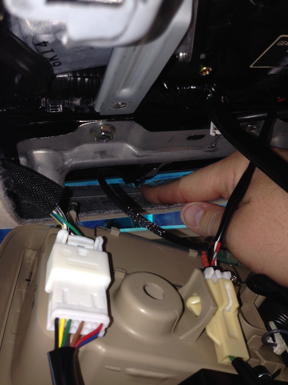

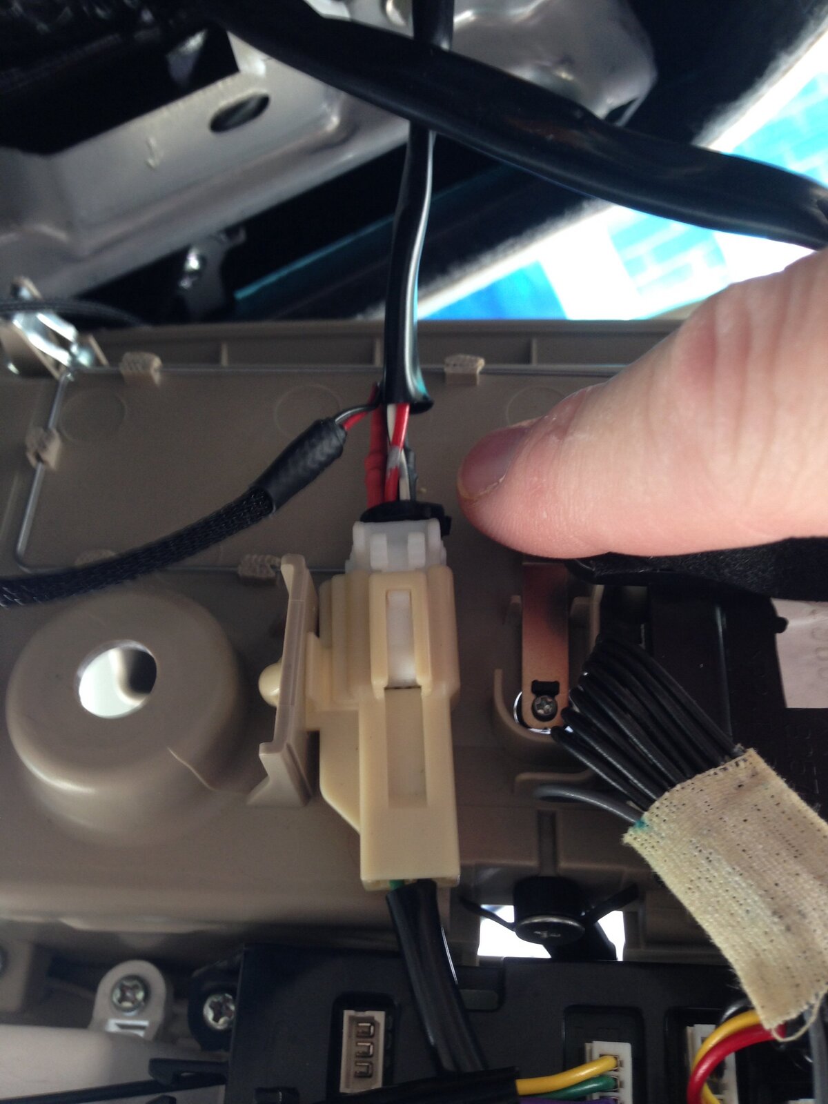

4. Unplug the 3 modular plugs that connect the console to the wiring harness. These plugs are for the power moonroof, Bluetooth microphone and the overhead console lights.

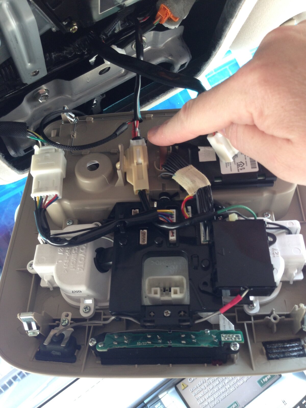

5. I selected to connect the Mirror Tap to the back side of the modular plug on the wiring harness for the overhead console lights. I selected this plug for 3 reasons. 1- It was a two wire plug that had a power and a ground. 2- If for one reason I blew a fuse or caused some kind of damage it was only to my map lights and I could live without them for a while. 3- This power source comes on as soon as I unlock my Land Cruiser with the remote key and it goes off either when I lock the doors upon exit or after a few minutes if I don't lock the door with the remote key.
6. Put the key in the ignition and plug your Mirror Tap wire into you radar detector. If it works zip tie the Mirror Tap wire to the trucks wiring harness. You may want to test out the. Best way to plug in the Mirror Tap ends into the back of the modular plug. I tried it a couple of ways before I found the one I thought was most secure. Then I zip tied and shook the wires around to assure I had a solid connection that would not fail later.

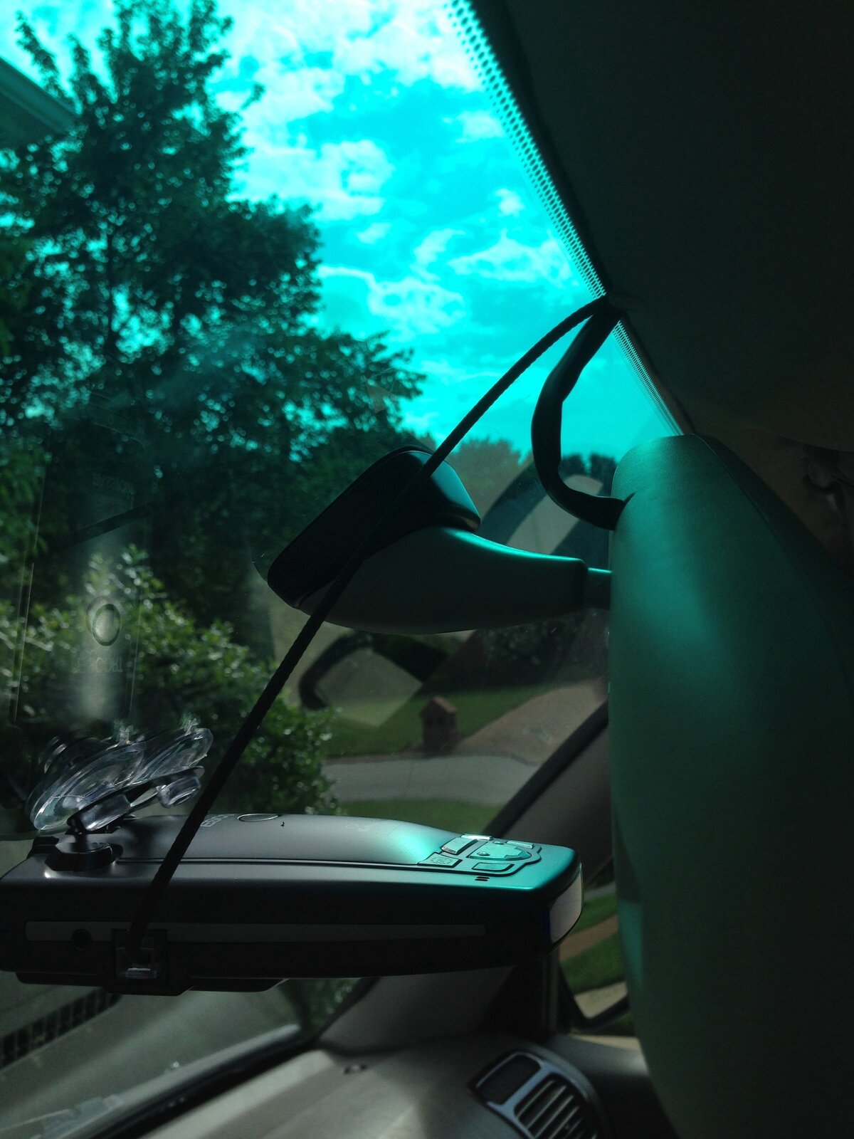

7. Unplug the Mirror Tap from the radar detector. Gently pull down on the head liner above the rearview mirror and slide the wire of the Mirror Tap wire through the notch that the wire for the auto dimming mirror goes through.
8. Mount your radar detector and plug it in for a final test.
