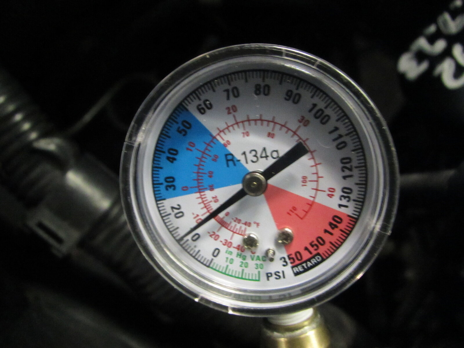

Been paranoid after ByronJ lost his cooling water (and engine). I've been thinking of what happens in the cooling system and how to fix a low pressure warning light. When the water is subject to heat from the engine it expands and reaches a pressure equal to the pressure spring in the rad cap. When the engine is fully hot equilibrium is achieved at 88KPa (13psi). If there is even a slow leak the pressure will drop as there is no increase in water temperature to compensate. I've ordered a 0-50 psi adjustable pressure switch. My plan is to plumb this in to the cooling system and wire it to a prominent light on the door pillar, get the engine hot and adjust the switch until the light just goes off. The drawback is that the light will be on on cold start but should go off after 5 minutes or so (to be confirmed). I've done the plumbing and fitted a gauge to check the water pressure out of interest it reads about 18 psi when engine is fully hot.

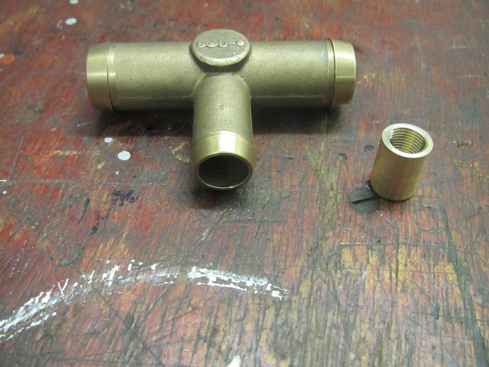

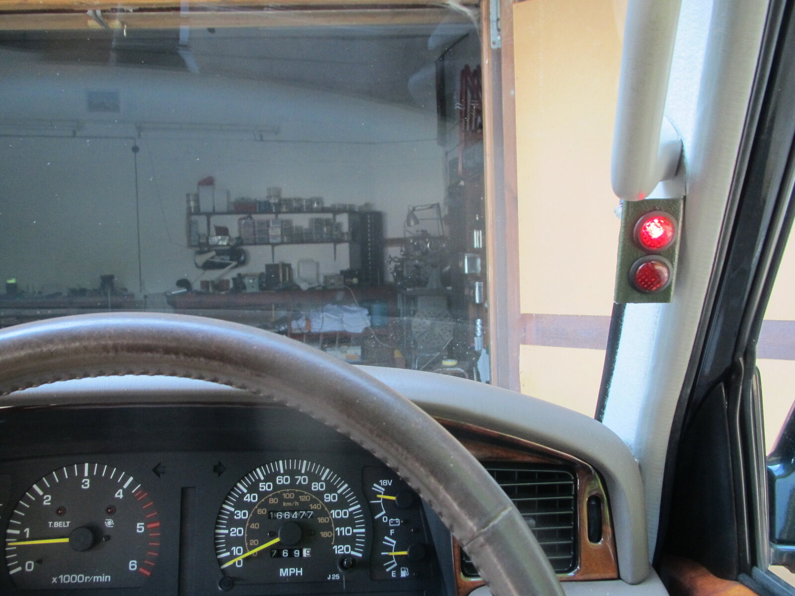

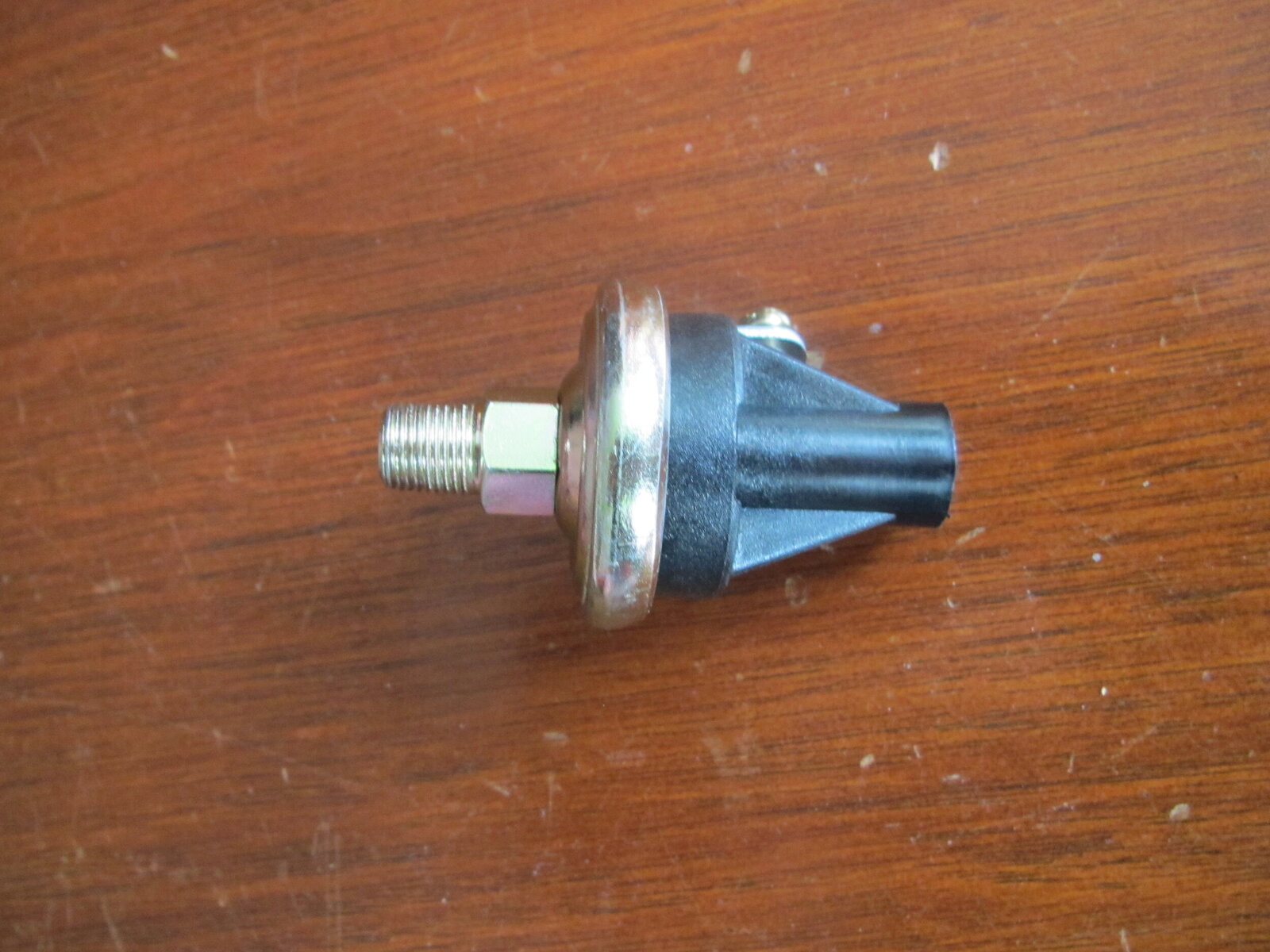

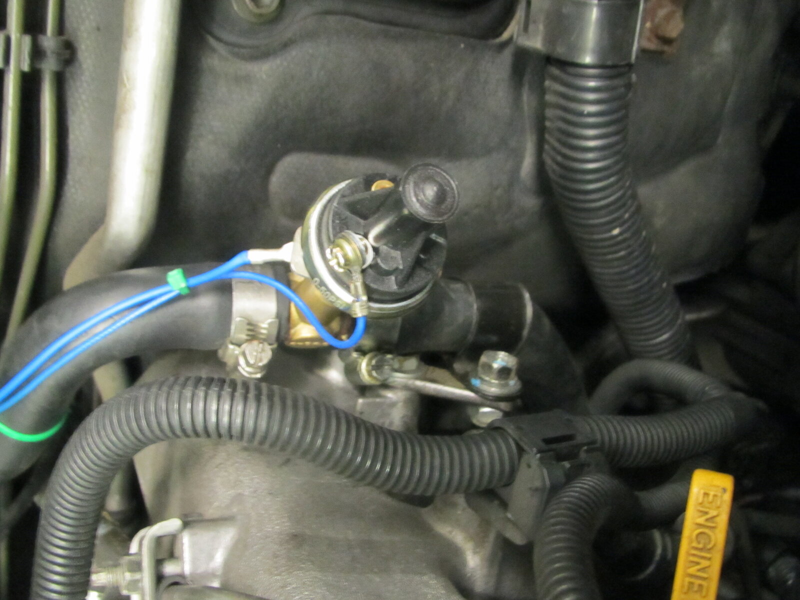

Managed to get the low pressure warning system finished. First I had to convert a brass T to take a 1/8 NPT threaded pressure switch. This T fitted into the heater pipe coming up from the block. The pressure switch was a "Longacre" 0-50 psi. I also bought a 20 mm LED warning light. I fitted later at sight level whilst driving. I had to correct my original hot pressure readings to 12 psi after taking a picture of the gauge which was clearer than line of sight. I set the cut off switch to 6 psi. First run went well initially but then the light started blinking. I stopped and removed the rad cap to equalise the pressure and set the switch to JUST turn light on. I drove home and let the engine cool overnight This a.m. went out and after 5 miles the warning light went out and stayed out.

Is the switch an adjustable one?
I much prefer the solution you have using a heater hose.
To me creating more breaks in the cooling system by adding sections of pipe to hold the sensor is creating more weak points that could fail. I'd be more annoyed/worried that the modified part would fail first before the original system and cause the failure that I was monitoring for.....
Yes the switch is adjustable 0-50 psi. It works really well. It is very solidly built. If it corrodes it will weep first rather than drop fluid. I cut the main hose up from the block which provides the heater circuit. The tee is a very tight push into the pipe and the thread fitting is a tight fit into the Tee then soldered with hard solder.
