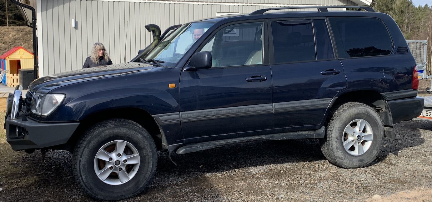

Hi Guys,
I need your assistance in diagnosing and finding out why my car does not start. In short, it is cranking but not even trying to start.
First, some background information.
I bought it about 2 years ago and at that time it had been standing for more than 5 years after the previous owner and local Toyota dealer workshop gave up trying to fix an intermittent starting issue.
It is a HDJ100, manual, just over 600.000 km but in fairly good condition except from that it does not start.
After a thorough cleaning and started looking in to the problem I noticed that the EDU attachment bolts were loose. Previous owner had mounted the winch relay box in the same area using longer bolts. New bolts and the car started right away. Success, or was it just the intermittent character of the problem?
I started to fix other problems from the vehicle standing still for a long time. Brakes were seized and brake booster buzzer beeped annoyingly. I tore apart the brake booster assembly and managed to fix the electrical motor.
Now life came in between and the car was standing for a long time again, could only work on it every now and then. But everytime I tried it still started easily.
Next step was to fix the clutch since the pedal often stayed down after pressing it. Fluid was more of a paste, and when that was cleaned out and filled with new fluid the clutch worked fine again.
Time for first test drive! But, now it is not starting anymore. Strange, since I have not done anything to the engine while fixing the clutch. Probably totally unrelated, but still..
It is cranking, but I do not think it is getting any fuel. It does not smell diesel. It does not even coff.
Decided to start over and be more thorough.
1. drained the fuel tank. Changed the pickup filter and refilled with new diesel.
2. new fuel and air filter. Primed with the manual pump and diesel is getting through.
3. removed the engine tuning box and replaced the complete engine loom from ECU and forward since previous loom had several splices after workshop did their diagnosing.
4. removed junction box in the left a-pillar (this was a pain) and checked spill valve relay. Junction box ground points were quite corroded. Cleaned all contacts and replaced all fuses. Now dashboard, especially fuel gauge works better and stopped flickering.
It still does not start
Found information on the internet, that there is a relay for the immobiliser that is sensitive to voltage drop. Tried bypassing without success. Immobiliser indicator on dashboard is blinking and stops when the key is inserted. Is this enough to draw the conclusion that the immobiliser is working as it should?
Found the lc100 online manual and started to follow diagnosting schemes.
Measured all the things on the fuel pump and cannot find anything wrong. I have been told that the fuelpump was replaced by the Toyota dealer which was very expensive but I have no documentation and previous owner is not avaliable any more.
From DI-71 (EDU circuit malfunction) I can measure ~12v at pin2 on EDU connector and about 1.5 ohm between 4 and 5.
Measuing at the ECU, SPVD is about 0 volt. For SPVF i measure 5V which seems odd, since the manual says 9-14V. BUT diagram on page DI-71 shows 5V? Is this a problem and if so, what does that indicate?
I am starting to run out of ideas and therefore post here. I am fairly certain it is electrical, since it was running fine for a while since I bought it. Or what do you guys think? But I do not know how to proceed and find out what is wrong. Could be something silly small or really advanced, I am not a mechanic and could easily have missed something very basic.
Ideas?
Thank you for taking your time to read this overly long post!
