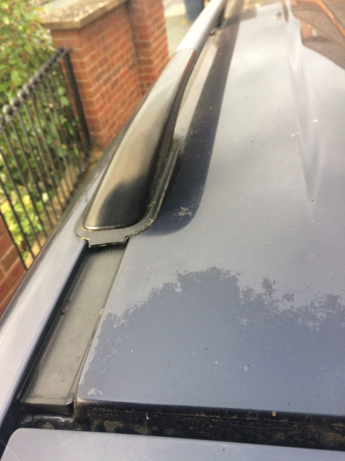

Step 1 .. you definitely want to get some bolts into the holes.
Step 2 .. the entire rain gutter from the back door to the front is covered with a black colour plastic moulding that slides in.

In the UK the VX model normally has the factory roof rack. The GX has no roof rack but has plastic strips with blanking plugs above the bolts. Suggest you search for the roof strips for a GX from a breaker. This puts it back to Toyota spec and keeps the water away.

If it helps. You probably just need the six plastic plugs / blanks plus bolts.
Pictures are from my two this morning
Have a look on Amayama but you may need the model number from a GX or the part number from a friendly Mr T parts guy.
