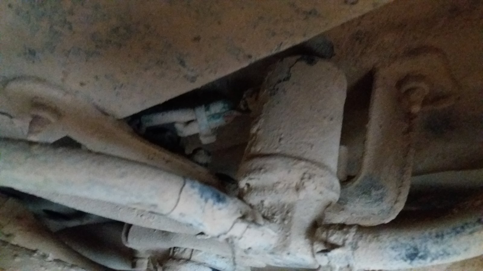

Hi guys
Another issue with my land cruiser..
So it broke down, turned out engine wasn't getting any fuel.. when I hand prime it, it gets nice and hard and runs for a few minutes until l the filter empties and stalls..
Taking the pipes off the filters, there is no pressure coming from the pick up pipe or no suction coming from the filter outlet?
It's a 2007 lc 105 4.2 diesel with the duel fuel tanks
Thanks
Dave

So I've had the sender out of the tank and the sock is fine
Are these the lift pumps?.. there are two of them between the 2 tanks or is the FIP responsible for dragging the fuel all the way up from the tanks?
pull pipes off the filter fill them with diesel and give each a blast of air to see if it reveals a leak when fuel is being forced back to the tank ?
