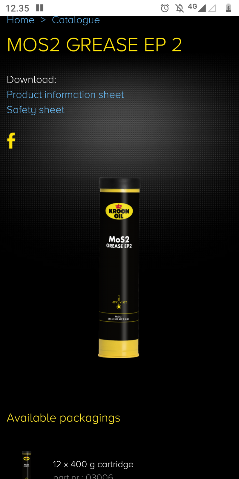

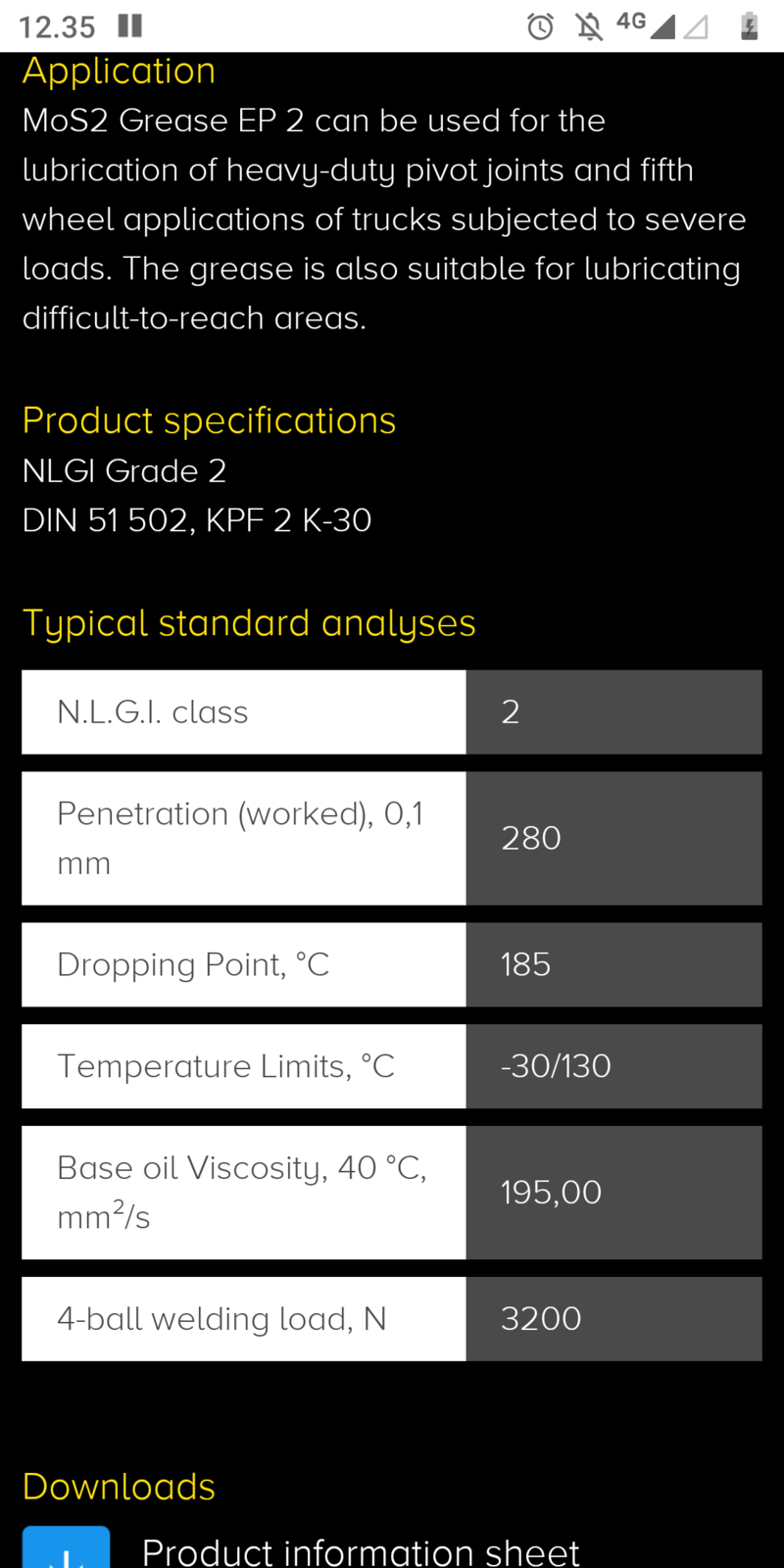

Grease for CV joint and bearing on hzj75

best to ring the manufacturer.
ive always used a moly grease for cv joints, and the general purpose traditional bearing grease for packing bearings and UJs.
ive since moved on to the multi coloured lithium complex greases for bearings and UJs. as they are much more water resistant.
it had always been my understanding that moly grease was unsuitable for high speed bearings as it was too "slippy", the rollers would slip, rather than rotate. causing flat spots.
this could well be outdated now though as modern greases have a much larger application overlap. end users are after one grease that does everything rather than having lots of different tubes of grease kicking about. the same with oils.
give them a call.
