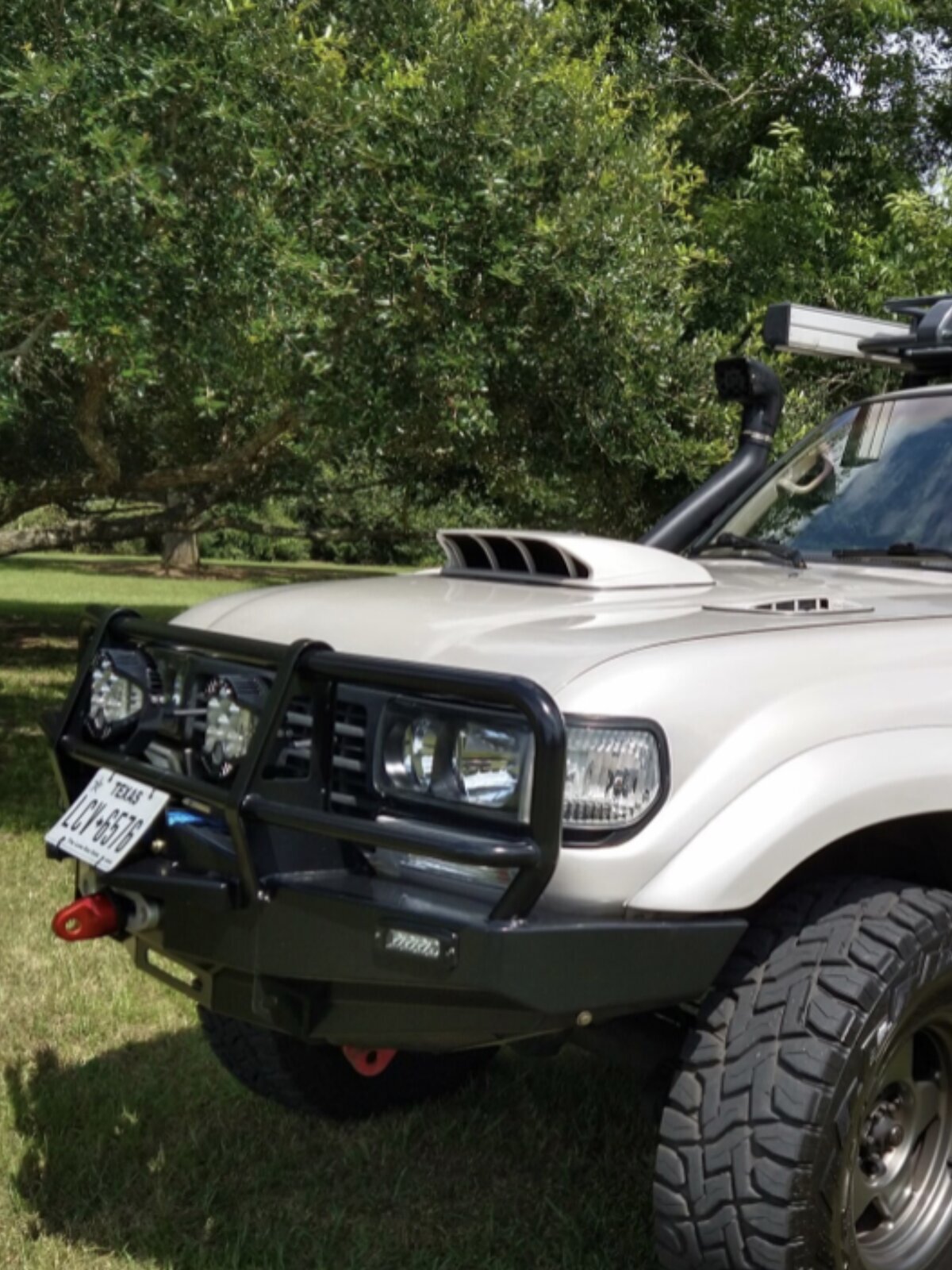

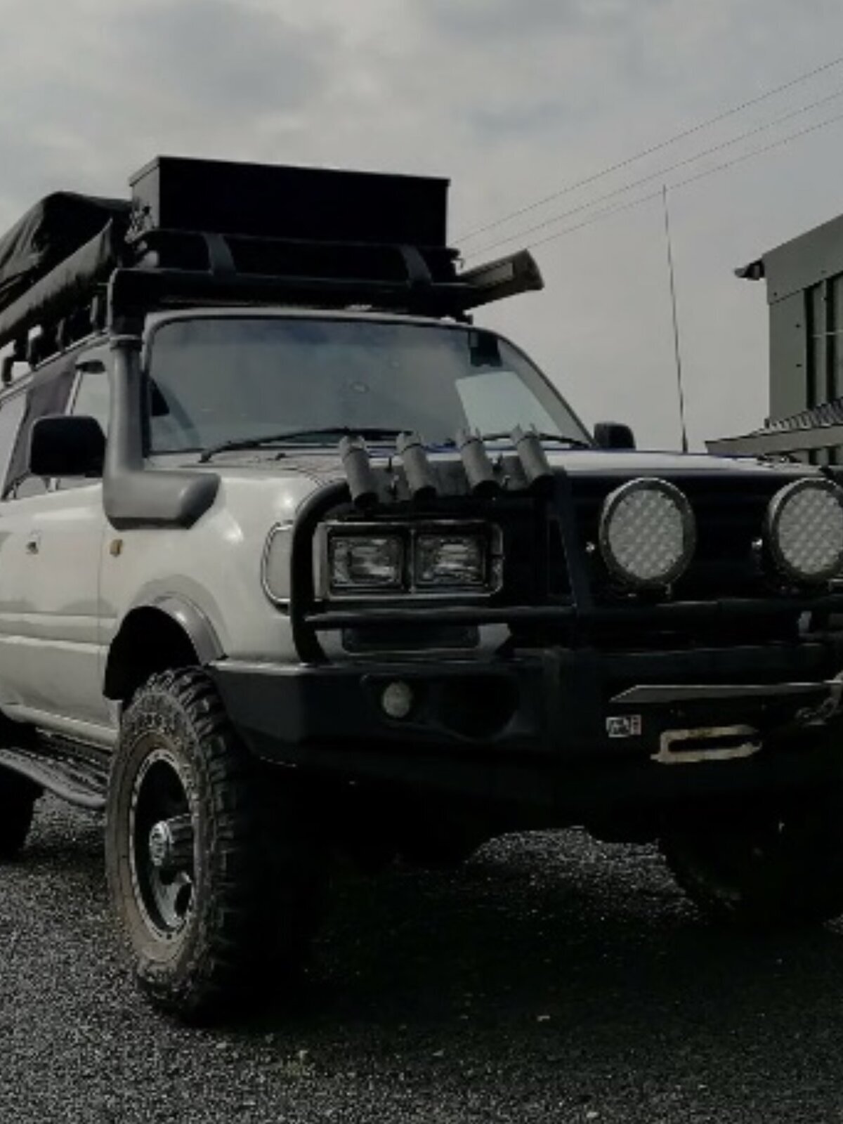

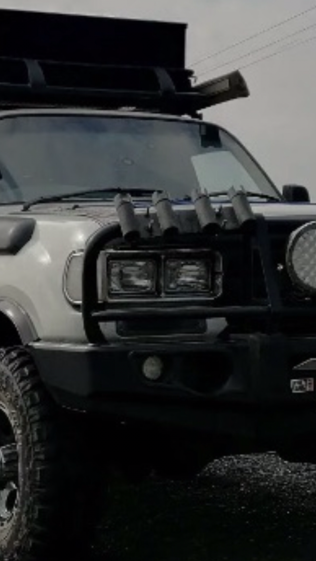

Hi Everyone,
Does anyone have an upgrade alternative for these headlights?
They are currently the original chunky glass lenses, I’m looking for a sealed unit LED upgrade. See pics below for currently installed & ones that I would like to try & find….
