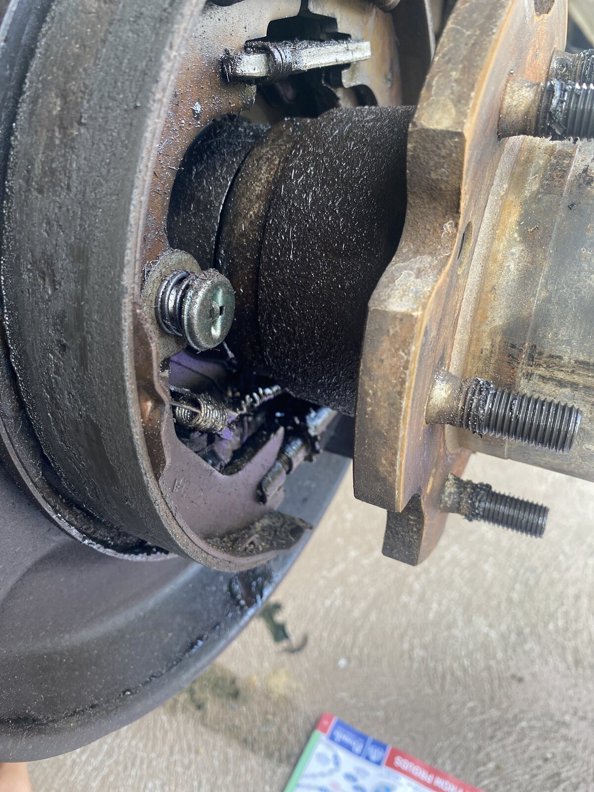

The screws on the lock nut are absolutely stuck. Any ideas to unscrew them?
Yep, definitely seal. Don't forget rotational forces will sling that oil everywhere, hence the mess.
Your brake linings will need replacing too + the other side too, so both sides are equal.
Yes by the looks of it, the leaking of the oil/liquid is from the seal and the only idea that I can come up with to undo the screws is to grab your Phillips screwdriver and a hammer and tap the end of the Phillips while it is on the screw. This will send shocks through the screw allowing it to be slightly more easy to undo. I hope that this works. Cheers
They are more likely to be Japanese Industry Standard screws, anything else wont fit properly i.e. Phillips, pozidrive etc.
Looking at the image, there is leakage, and we have to check well by removing the wheel and see where the leakage is coming from. Last year my car also had the same problem. I went to the Acton service centre there. I told them that since I was facing this problem, they diagnosed the car very well and resolved it. If you want to go, then you can go.
