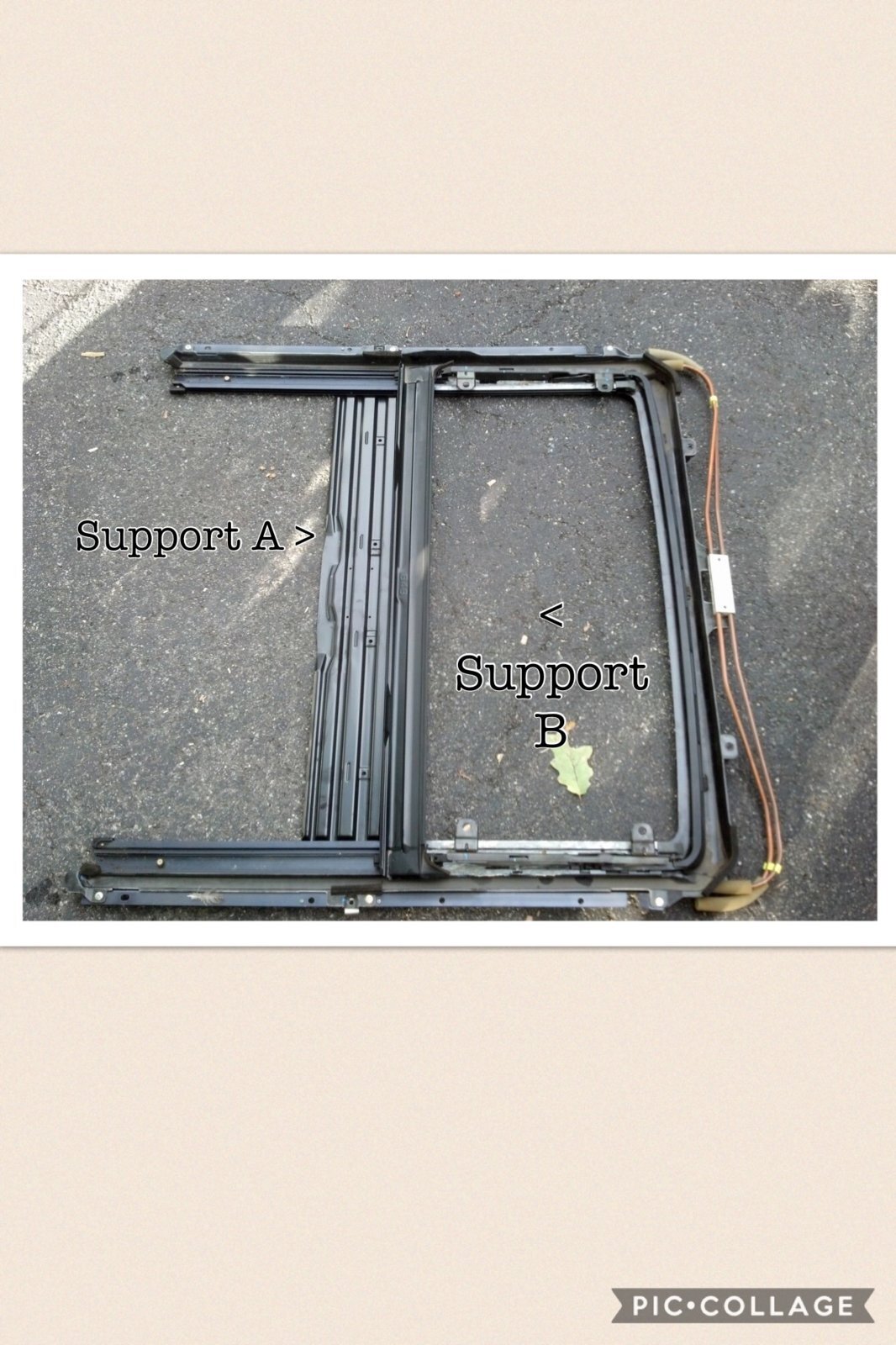

Been extremely inoying guys having a rattle or two whilst driving when the revs are low.
Been a focus to isolate the issues here & there on the car for a while now & rectify them accordingly.
I know these may be an issue for others if you here being that these vehicles are 20 plus years now.
In this attempt without having to take the headliner off is there a simple way to fix this rattle at all?
The rattle lessens when I press the centre light switch behind the sunroof upwards.
I guessing it's something to do with the "Support B" illustrated panel brace as I have placed a 1.5 folded cardboard piece between this & the roof where there is space & it's almost cured 95%.
Although this is a test I would like to know if there is a proper fix anyone has tonunderstanding this issue.
Any thoughts much appreciated
Thanks

Had another look today it's seems the sliding sunroof blind effects the vibration from opening to closing.
Took the side headliner partcailly down from the sunroof liner corners & checked all the screws & bolts no issues there.
It's been very hard to isolate the vibration but when I lift the closing blinder up whilst open to the rear it stops / lessons in noise.
If I press up upon on the centre interior light the vibrations stops again.
I think it's something here but just cannot isolate the anoring issue from this standpoint.
Any further ideas appricated.
Thanks

Hi Michael, I appreciate this response is 7 years too late but the info may help someone else.
I had exactly your issue - sunroof rattle that stops when you press on the forward overhead light. The problem was a broken rivet on the pressed metal plate that holds the light assembly. Simply pop rivet in a new rivet in and the problem is fixed ... after you remove the headliner - and that is a major pain in the backside. Its theoretically possible you could access the broken rivet via the light assembly hole in the headliner - Its just that I needed the headliner off to find the problem (The light assembly plate is attached to the sunroof assembly via two rivets.)
Unfortunately there are many many possible sources of 80 series sunroof rattles, I'm chasing another one now. I wish I didn't have a sunroof ...
